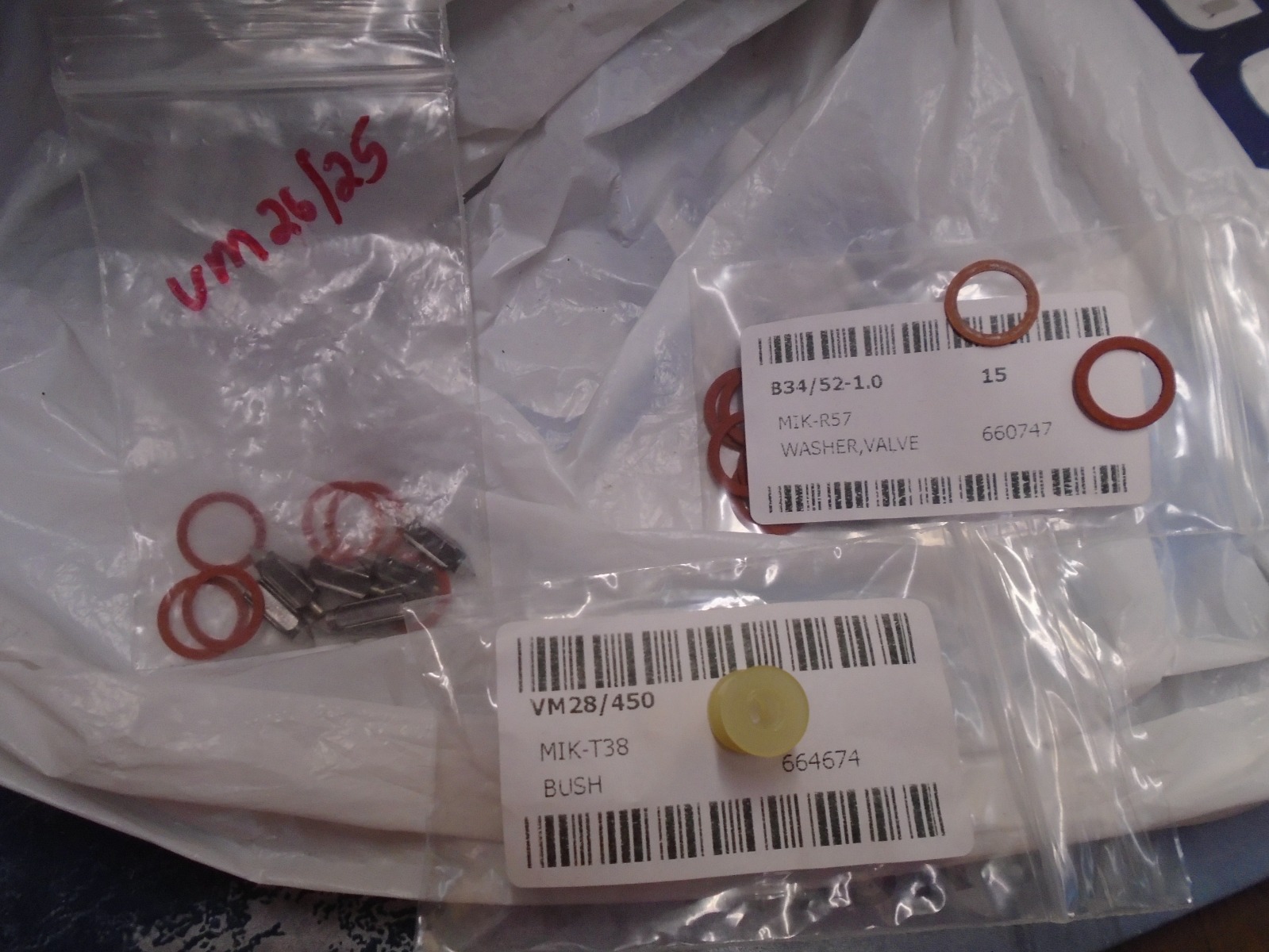

Those VM26/26-xx fit 72-1980 Z1 carbs ALL. Also if you need the "red steel" seat washer, VM26/25 is that Mikuni part number. If working on VM29's (smoothbores), they used a different/larger float seat. It's washer is Mikuni part number B34/52-.5/.8 and 1mm thicknesses. Choke lifter plastic for late 1974-1980 VM 650/900/1000 is Mikuni VM28/450. These are original and not super white like Marcel's repop stuff at the same price. Jim, not only promising, factual. How many completed set of the VM28 SC's do You want, Ha.

Not recognizing the white "bush'. Looks like a solid round button. Are they fitment for VM28SC's?

You're welcome my Friend! Just kidding about the carbs, figured You'd cornered the market on spares already, ha. I'd just grabbed some gaskets for others info, didn't really apply to the initial conversation but thought it might be helpful for others. That "bush" is just standing on end so it didn't roool away.. It's not the "early" type, just choke lifter used on multiple VM choke plungers.

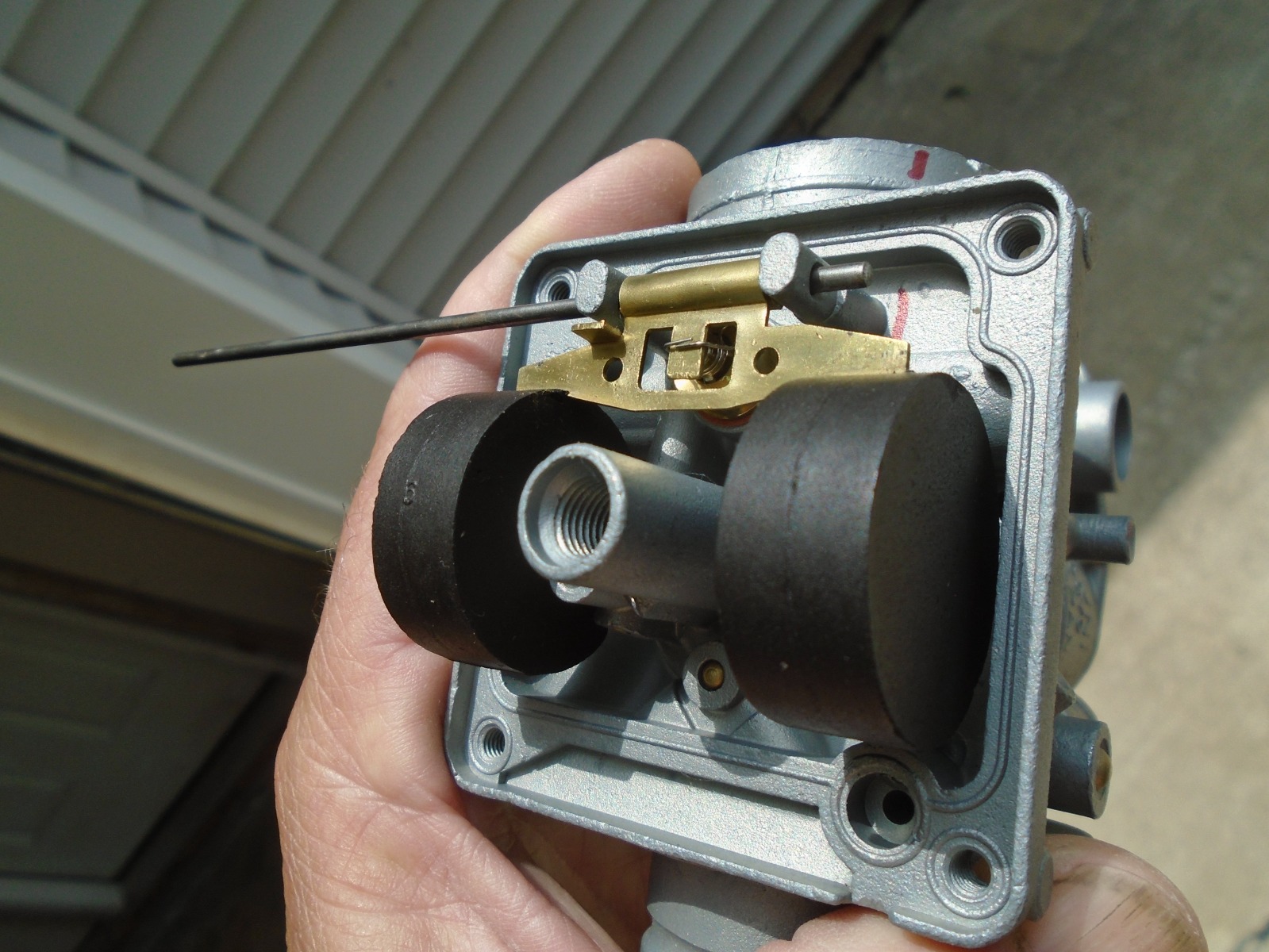

Also..Jim you mentioned Viton needle option. Yes, use a Honda Float needle set from an early Sabre 83-84 750. Although Kehin, same diameter/pitch seat. Gotta mill down the filter holder where it protrudes into the casting but work fine. Also utilize the spring wire that goes over the top of needle that attaches to the float adjusting tang.

25 May 2024 09:33OK, now we see the hole in the middle. It doesn't present well on this monitor; not enough contrast. Thought it looked like a solid round button. Might be these old eyeballs, too... .You're welcome my Friend! Just kidding about the carbs, figured You'd cornered the market on spares already, ha. I'd just grabbed some gaskets for others info, didn't really apply to the initial conversation but thought it might be helpful for others. That "bush" is just standing on end so it didn't roool away.. It's not the "early" type, just choke lifter used on multiple VM choke plungers.

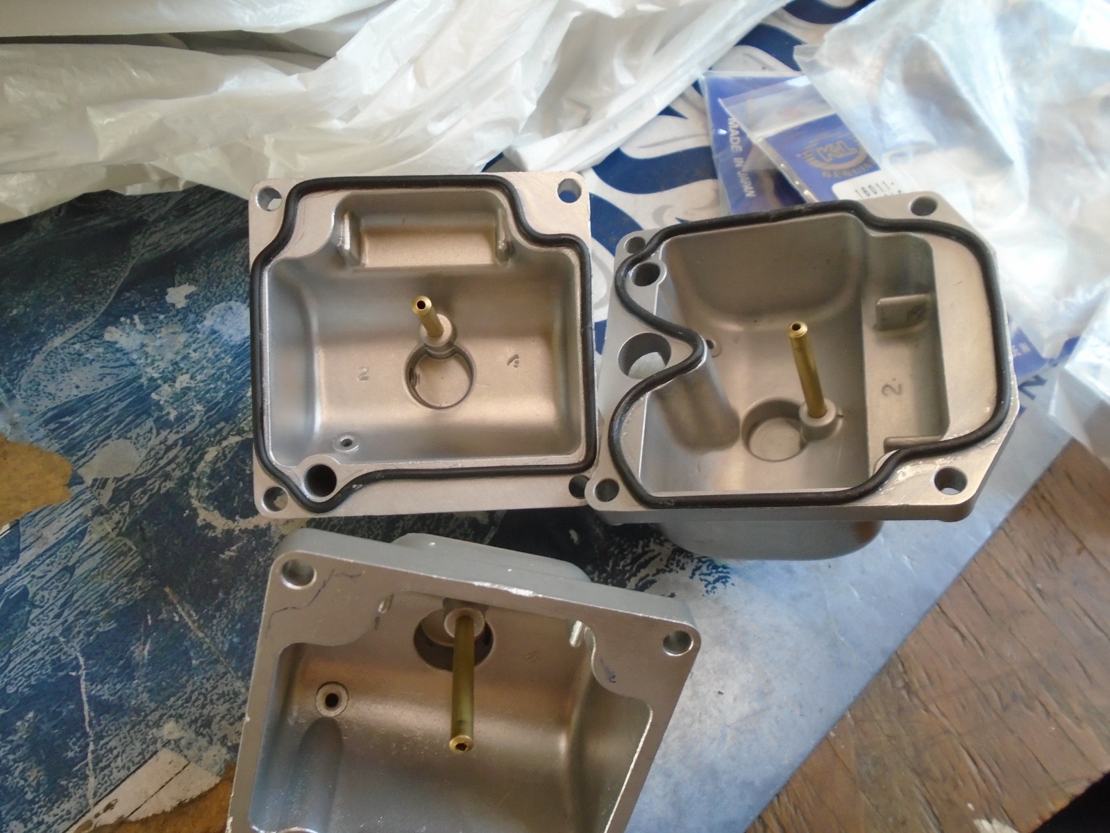

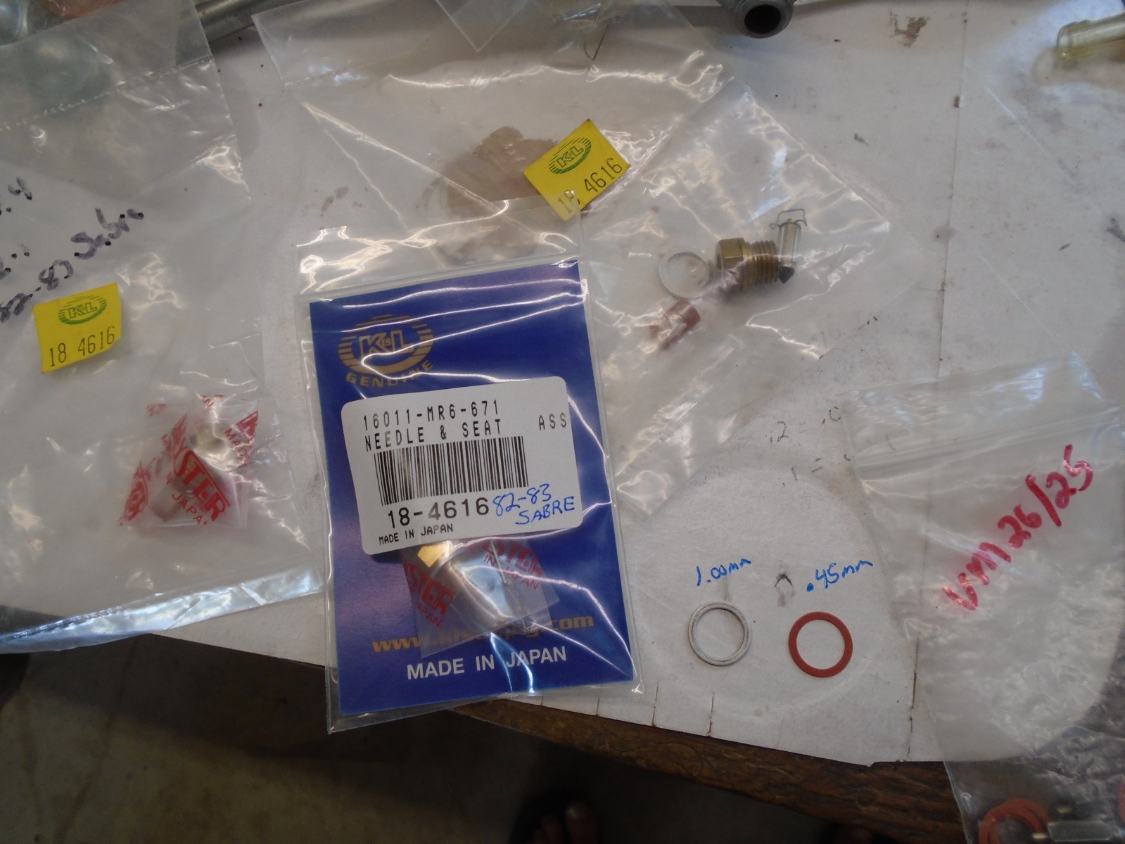

More stuff Jim to ram-rod the point home, ha. Ed had mentioned the "alternate" method of using a Viton needle too. Here's my avenue to success doing the same using the Honda Float needle sets. Honda PT# 16011-MR6-671 or K-L 18-4616. Interesting fact all the KL little baggies have Keyster contents?? Anyway, pictures will provide the essence of application if interested. Note steel/brass floats react faster then viton tipped needles. Thats why i'd mentioned utilizing the supplied needle "spring hook" over the float tag. And..unadvisable to use the aluminum crush washer supplied. Theirs about a .5MM difference in thickness compared to the original red one. Doesn't sound like a lot does it... Believe me a slight difference in height at the post position makes a HUGE difference when setting floats. And, opening a can of worms again. Think ED thought i was nuts a while ago but i haven't used float bowl gaskets for years on any VM carb. HI ED! My crap doesn't leave brown stains down the bowl..ever.

I like the rubber ring instead of the paper float bowl gasket idea. How about more details of this setup.

03 Jun 2024 06:48Are the o'ring gaskets glued in place or are they specially formed to hold their shape?More stuff Jim to ram-rod the point home, ha. Ed had mentioned the "alternate" method of using a Viton needle too. Here's my avenue to success doing the same using the Honda Float needle sets. Honda PT# 16011-MR6-671 or K-L 18-4616. Interesting fact all the KL little baggies have Keyster contents?? Anyway, pictures will provide the essence of application if interested. Note steel/brass floats react faster then viton tipped needles. Thats why i'd mentioned utilizing the supplied needle "spring hook" over the float tag. And..unadvisable to use the aluminum crush washer supplied. Theirs about a .5MM difference in thickness compared to the original red one. Doesn't sound like a lot does it... Believe me a slight difference in height at the post position makes a HUGE difference when setting floats. And, opening a can of worms again. Think ED thought i was nuts a while ago but i haven't used float bowl gaskets for years on any VM carb. HI ED! My crap doesn't leave brown stains down the bowl..ever.

Vinsky it's just 2mm Buna-N cord stock. Nothing preformed just freehand according to the application. Objective is to "super glue" the rubber where that slightly raised casting bump is on the carb body. This is for the VM's though. Also works on the early Keihin's too, where they used a flat rubber or paper gasket but there isn't always a raised section on a lot of those. The trick to success is having a super clean surface to work with. I always bead-blast mine and carb cleaner to get any oily crap-off.
