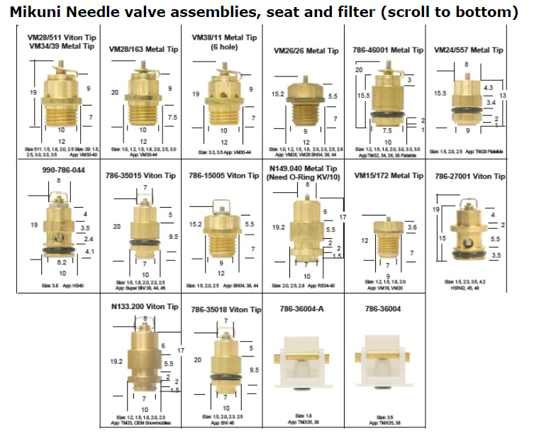

This chart has dimensions for the various Mikuni float valves. I suspect those valves are VM28/163 or VM26/26 type float valves.
Where you run into troubles, is finding the OEM 2.6 size. Actually, this is not important from a function standpoint, but some people get hung up on details like these. 2.3 is the standard size for Kawasaki family VM26's, and I've never heard of anyone sucking their float bowls dry using them, thus my comment about 2.6 being unnecessary.
There are lots of places that sell Mikuni float valves. For Keyster, I like Sirius Consolidated Inc. www.siriusconinc.com/products/detail/565
When rebuilding VM26's, I buy the cheapest Keyster VM kits I can find, and then I use the float valves and gaskets. Buying this way is cheaper than buying float valves separate sometimes.
www.jetsrus.com/needle_valve_float_bowl_...l_gasket_mikuni.html

We see that chart Nessim posted at JetsRus as well as a few other sites.
JetsRus has this needle:
www.jetsrus.com/individual_parts/KL_18-8956.html
We very carefully measured an OEM Z1 needle circa mid '73 that we referred to in the OP. Sent those dimensions to JetsRus, asking if the needle linked above was similar. The response was not useful, just the same chart Nessim posted.
Those needles are relatively inexpensive. We'll happily take one for the team & test a few in a couple of our model VM28SC's that we use for experimentation. If anyone has experience with the linked needle, please post your findings.

Never buy needles separate. And never buy K&L float valves either. The needle in the spring is WEAK. It won't hold up the weight of the float, which is a good indication of spring health on old float valves. Mikuni or Keyster are best.

So, are the VM26/26 type float valves correct for those early 28's then?
