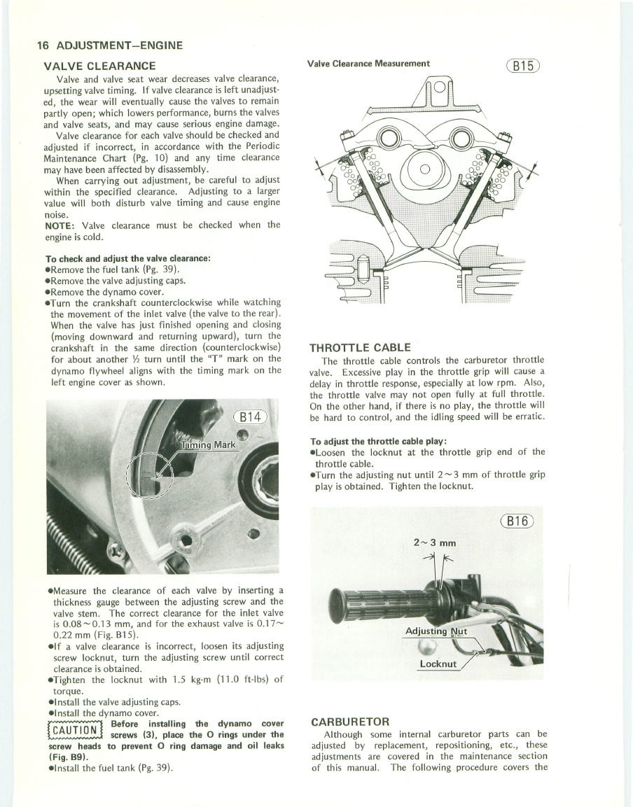

@ Scirocco
ok, I'll check the valve clearence, but wouldn't you here if the clearence is to small (valves not closing) when you pull of the gas handle?

21 May 2024 00:48You wouldn't necessarily "hear" anything but the valves would be closed for less time so the motor can't build pressure (same as long duration performance cams lower static compression for the same reason)@ Rolf1976_KZ900

Hard to start when warm is a classic example of poor compression, commonly caused by overly tight valves.

I've checked the valve clearance and it is between limits.
