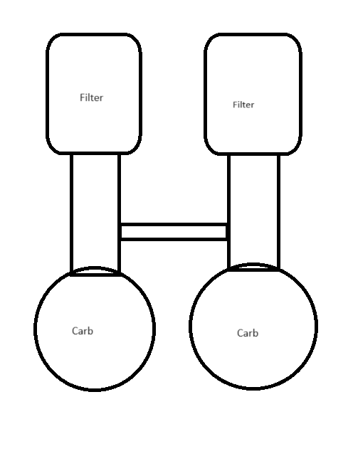

So the filter box for my KZ440 LTD is broken. I'm thinking of building a custom intake setup and was wondering if anyone has done something similar OR has insight for my idea.
Basically I want to connect a 42mm ID silicone hose to each carburetor, with a pod filter on the end. Then I want to add a smaller "bridge" hose in between the two 42mm hoses in a sort of H shape. My logic behind it is that will help equalize the airflow/help with vacuum.
Opinions?
Opinions?

Seems like that would add turbulence to the incoming air. Also, one filter will flow more air than a carb can use, so I do not see the advantage of adding more flow.

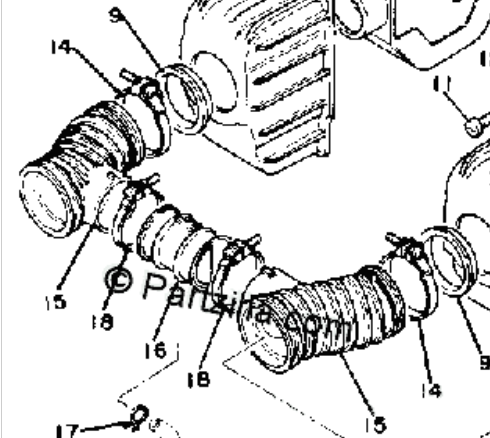

Back in the day, I had an XS400 Yamaha. The stock air filters were quite expensive, so I bought two cheep uni pods, and clamped them onto the stock intake runner tubes, in a configuration much like you reference. The bike ran fine. Much better in fact than with the pods attached to the carbs. That was a nightmare.

24 Apr 2024 04:39I was thinking it would help with the whole vacuum issue people talk about. Good point about the filters allowing to much air though. Maybe I can come up with some sort of Y pipe instead.Seems like that would add turbulence to the incoming air. Also, one filter will flow more air than a carb can use, so I do not see the advantage of adding more flow.

24 Apr 2024 04:40Yeah basically from what I'm seeing the CV36 carbs need that intake runner spacing to work properly. I guess it just comes down to needing the bridging hose or not.Back in the day, I had an XS400 Yamaha. The stock air filters were quite expensive, so I bought two cheep uni pods, and clamped them onto the stock intake runner tubes, in a configuration much like you reference. The bike ran fine. Much better in fact than with the pods attached to the carbs. That was a nightmare.

My personal opinion is that the bridging hose is an unnecessary complication with no tangible benfit

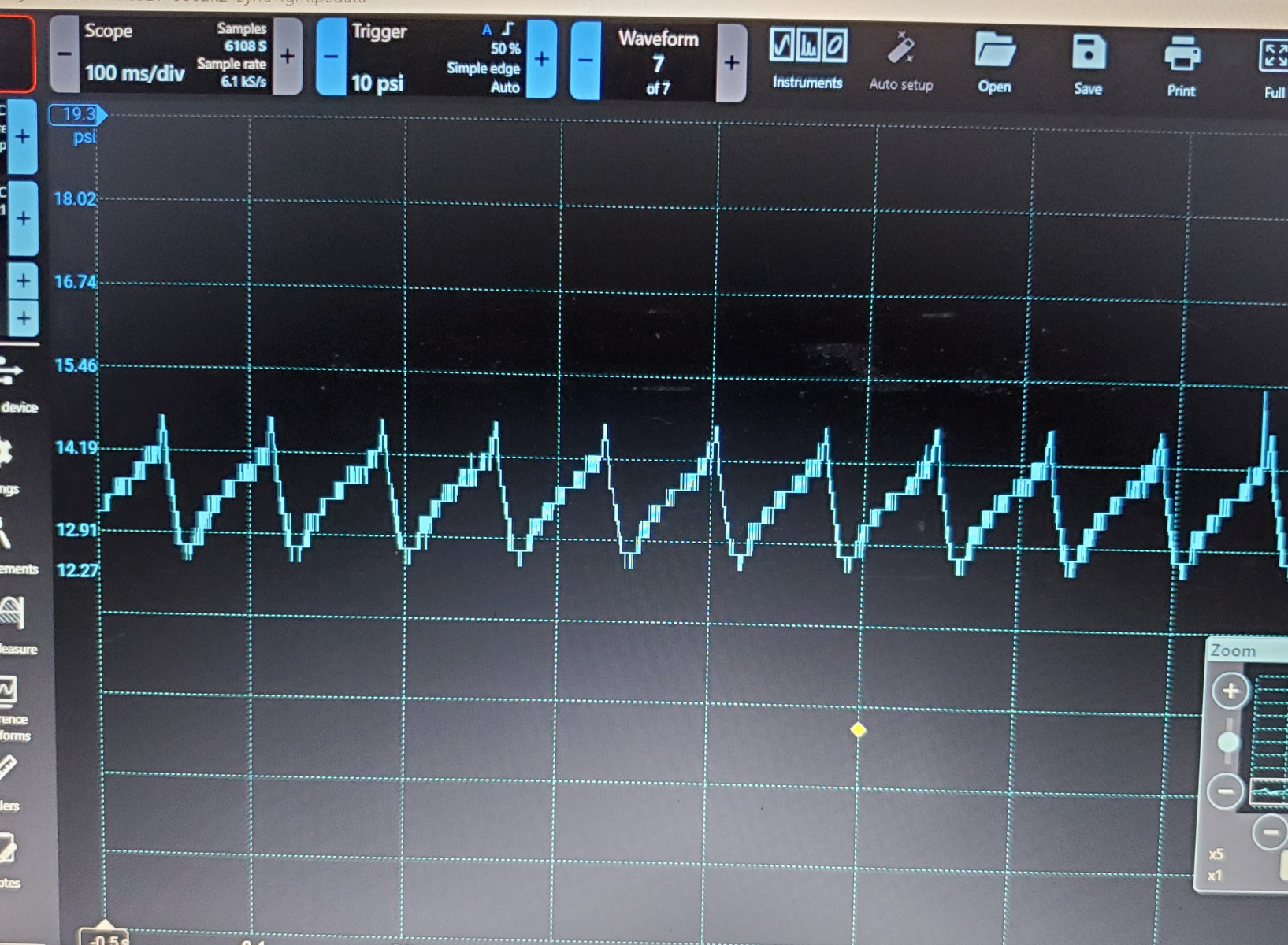

Try it out. Take notes.
Change the pipe size. Take notes.
Remember, the carbs don't just suck. They blow too.
I used an oscilloscope to balance my carbs 2 weeks ago.
The pulses at the carburetor look like a sawtooth pattern.
Alternating between vacuum and pressure.
I guess i should put the pressure sensor in the airbox to see what the pressure/vacuum looks like on this side of the carb.
It's probably more subdued as it's a larger mass of air.
More testing I guess.

24 Apr 2024 09:38Now that is some quality dataTry it out. Take notes.

Below is the XS400 Yamaha airbox runner configuration. Other than length of the runners, very similar to what the OP is proposing...
