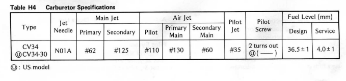

Not sure it's making sense to me because I just found this post:
kzrider.com/forum/3-carburetor/609565-kz750-cv34-carb-jetting
It claims that 125-62-35 is the correct jet size and to me this makes sense.
This is all very confusing, could you please help me clarify?
Also, my pilot screw is adjustable. I'll be running the stock airbox setup under the assumption that 2.5 turns out should get me close to the magic number?

24 Jan 2024 18:53You might want to open up the second set and check the jet sizes.Nessism,

I've opened up the other set. The jets seem a little knackered but I can see they say 90, 65, 35. That seems to line up with what Mcdroid was saying.
Maybe this is a stupid question, but which one is the main air jet? (Pri: 100 sec 60)
These jets are a little knackered. Primarys are stuck in there and a little wallowed out. You think they're okay enough to reuse them? If so I'll break out the torch and try my hand at it. I bought a carb kit off ebay and it came with some jets as well... unmarked and they don't say what number they are on the listing. Interesting. Other evidence that the previous owner gave me was a half used dynojet kit. I think he may have been toying around with the jet sizes. If anyone is interested in this dynojet kit I'll trade it for some clean stock jets. Or just good advice lol. I wont have much of a use for this kit once I get back to stock jetting.
