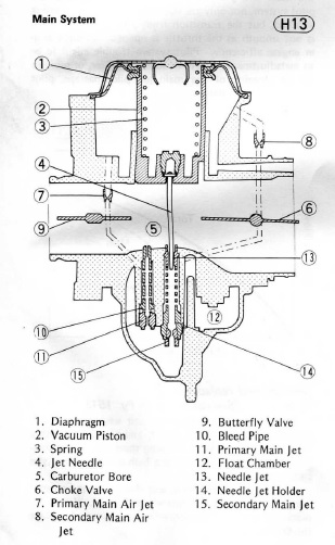

- JR
- Posts: 2968
- Thanks: 483
Re: KZ750 N1 Stock carburetor jet sizes?
25 Jan 2024 19:15 - 25 Jan 2024 19:44
Hi Texas
Just to avoid any confusion, kz75spectre was asking about the location of the primary and secondary Air jets as opposed to the primary and secondary main jets for which he has posted pics earlier and which are in your partzilla link
Edit
Oops. Apologies. I need to correct myself. The pilot Air jet can be seen at 6 o clock when you look in the intake side with the choke flap horizontal. The Pri and Sec Air jets #s 7 and 8 are internal beneath the diaphragm and location is shown in the diagram from the manual below
Edit
Last edit: 25 Jan 2024 19:44 by JR.
The following user(s) said Thank You: Nessism, kz750spectre

- kz750spectre
- Posts: 42
- Thanks: 3
26 Jan 2024 11:09
Thank you all for the input. So from what I understand and for clarity they're not changeable right?
