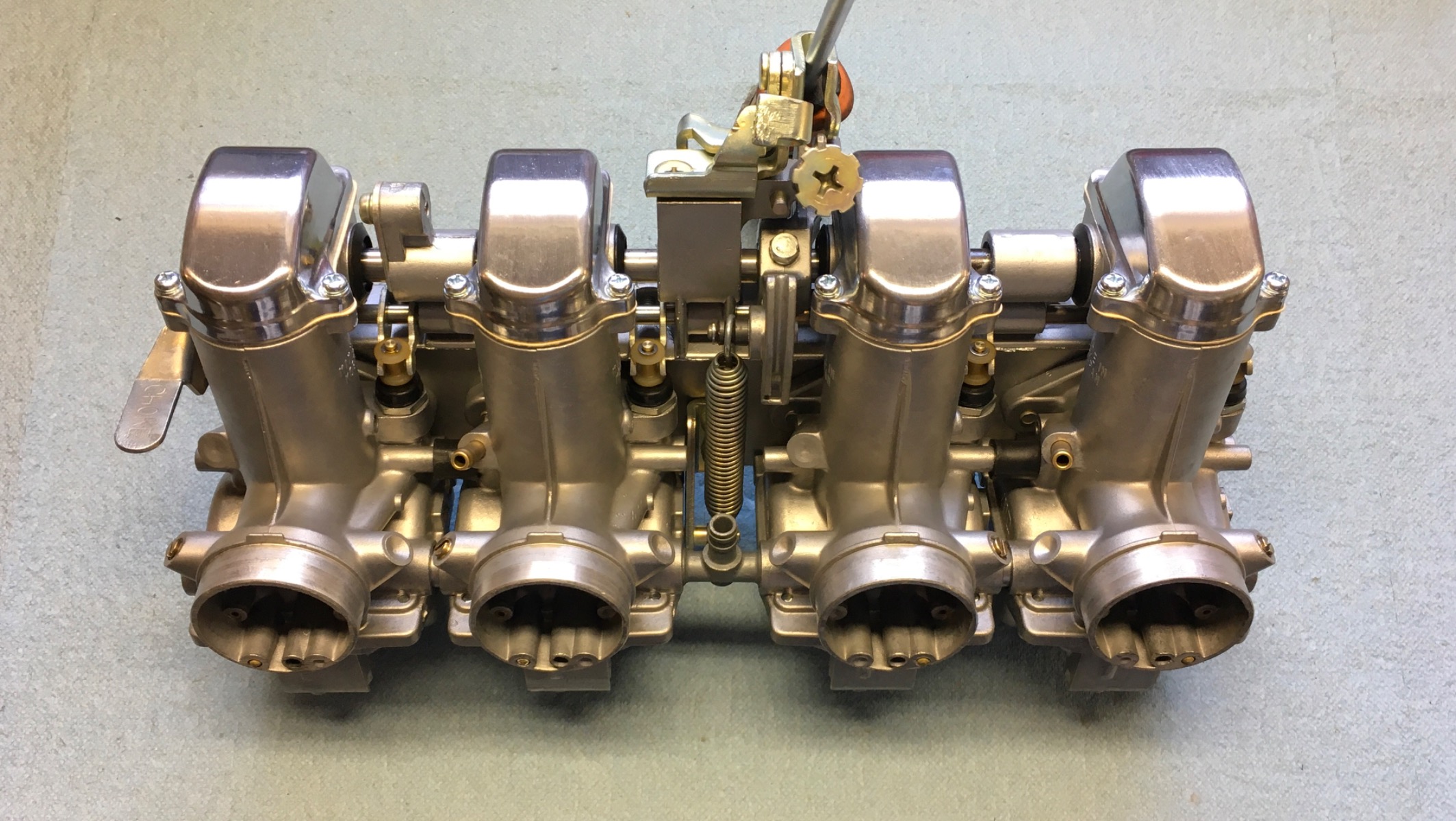

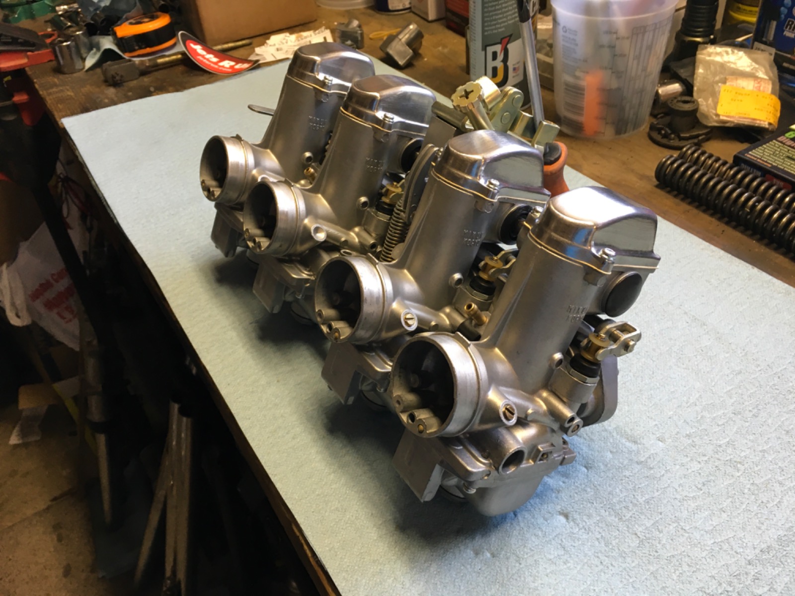

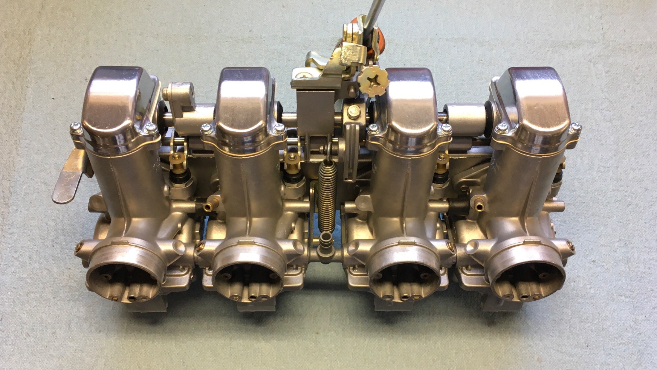

Wanted to add my compliments to Ed and his abilities. I normally do all my carb rebuilds, they typical turn out nice in appearance and correct in function. That said I don’t have the ability to replate hardware, brackets and such. Knowing Ed does I sent him a set of 29SB’s and couldn’t be happier. One jet block was stripped and I ordered a replacement, within the time it took to receive Ed had worked his magic and repaired the stripped threads. Over and above what I expected. Anyone in need of carb services, don’t think, just send them to Ed.

Thanks for the positive feedback, guys. I DO try to service my customers!
VM rebuilds are my favorite. I could assemble a set with my eye's closed, literally.
Some bits and bobs are getting hard to find these days. Throttle shaft grommets, for example. The early VM grommets had a white plastic liner, which debonds from the ID. These grommets also crack. New choke spools are available aftermarket, which is good because they often crack and fall apart. The brass drain screws are a real pain too, because they tend to seize in the float bowl, and the only way to get them out is with pliers, which scars them up. Fortunately, I've found a good source for those, along with new screw kits.
Following Zed's lead, I have figured out how to replace the rubber seal in the choke plungers. For guys doing their own carbs, send your plungers to Zed. For me, though, I do my own, to stay self-sufficient.
Another fun challenge is fuel inlet Tee's. The OEM rubber coated zinc Tee's are great...until the rubber ages, and shrinks, and cracks. I know that some guys wrap their old Tee's in teflon tape and stuff them back into the carbs, but I'm not comfortable doing that. I've made a ton of Tee's using a lathe and brazing torch. Good fun, but time-consuming. For a while now, I've been modifying (china) "Yamaha" brass fuel Tees, to fit our dual feed VM KZ applications, using my lathe (shortening them and machining new O-ring grooves). This works great, but my last purchase of china Tee's wound up being brass plated steel Tee's, which are less than ideal. I need to see if I can find some of the old brass jobbies, and then buy a grip load for future projects.
So goes it for the carb rebuilder. Please be understanding when your rebuild winds up costing more than you first thought...
