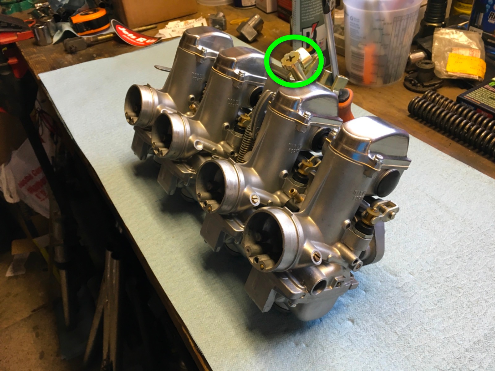

Looks nice .! Is the zink plated stuff like brass color or is it like silver? on my computer it looks brass color.I live not far away from a company that do work like croming zink plating gold plating .I plan to take a trip there and ask what they want to plate some of the stuffs from my carbs. I want it to be like brass color

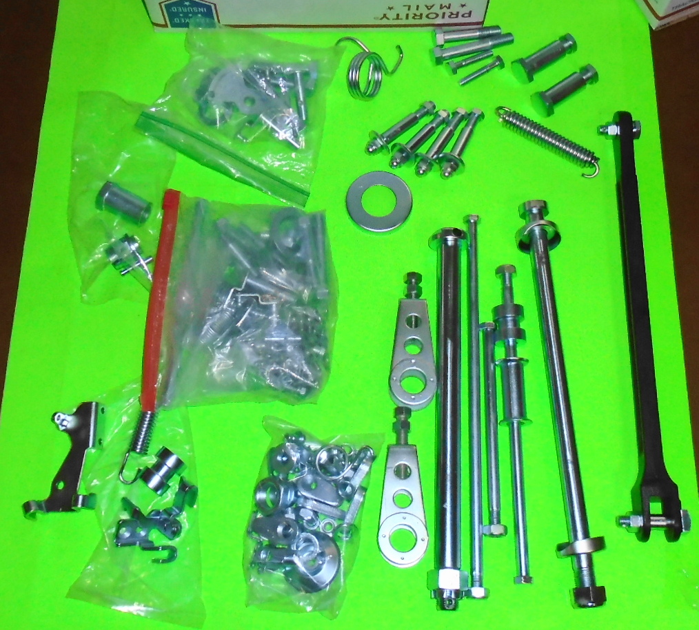

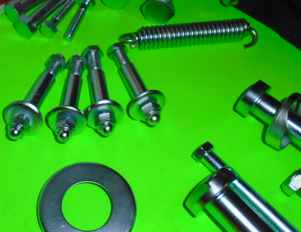

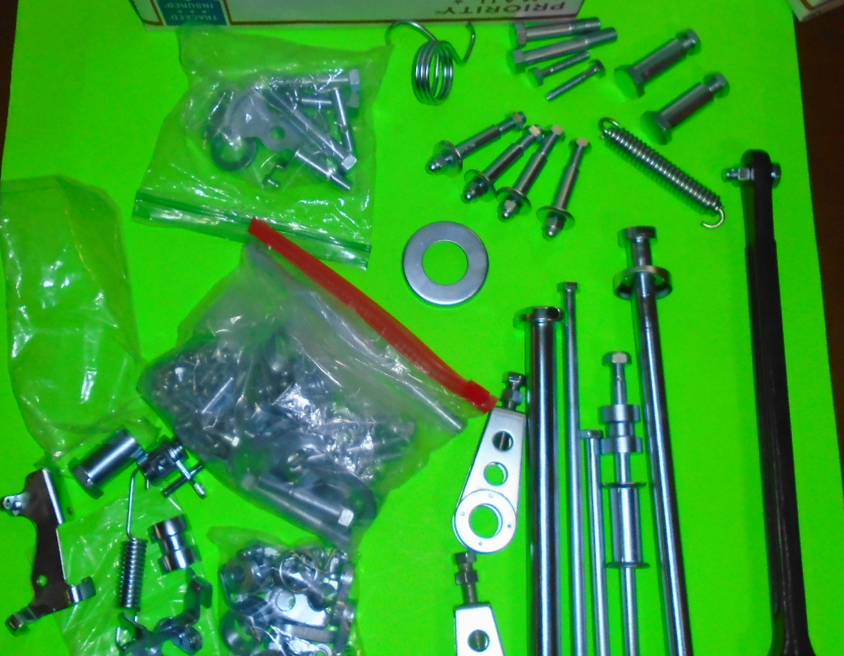

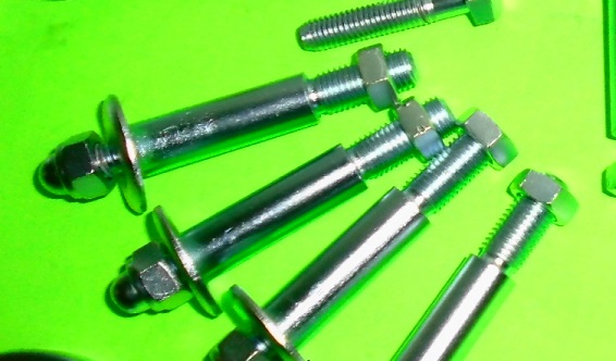

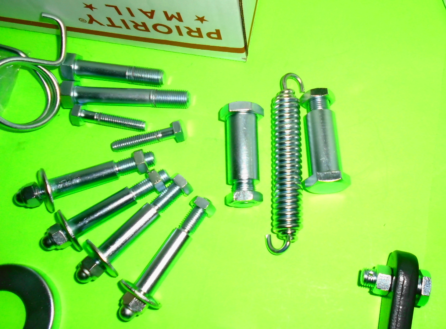

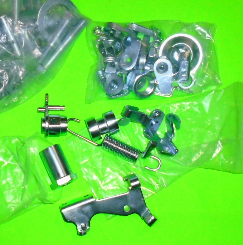

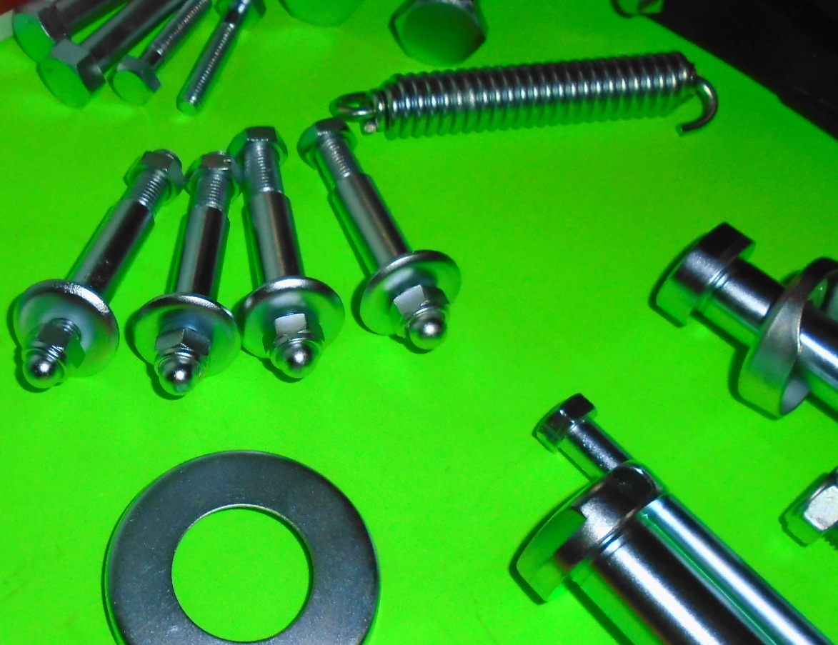

Zinc is tricky!! I have been working with Clay "asphalt900" we have work done at a regular Business, "TRIPP Plating" in Buffalo.
I call it "chicken wing grease" they have to change out the mix on a regular basis! Fresh Chemicals! Makes for a brighter finish.
Here are some pictures of fresh Zinc Coating.
I'm not opening up Clay's carb parts, because I don't want to loose any!
But my work is mighty fine!
So is Clay's!
I was middle man! I know the owner of Tripp Plating. Cost of everything has escalated of course!! Plus Sorry New York State regulations!
So tuff to do anything now with the "Greenies" controlling everything!
Don't even think of CHROME! Unless you have an unlimited budget!
Here are a few pics of $200 dollars worth of a "Ka-Zillion" little pieces, Fresh Zinc! Professionally done.
Marty in Buffalo.

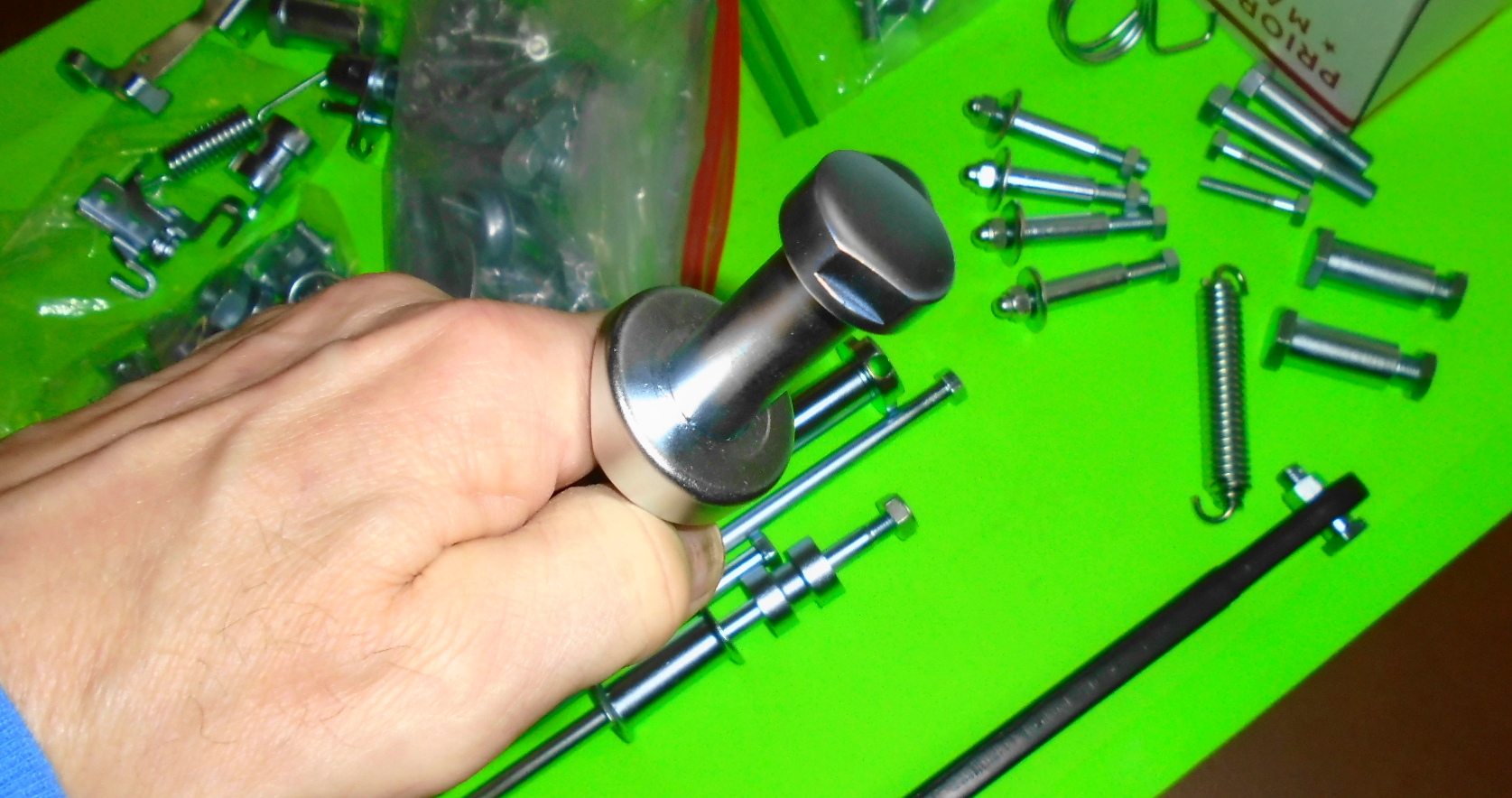

When's the last time you've seen a set of 4 foot peg studs with 4 OEM washers and the OEM acorn nuts??????
Yes they sell aftermarkets! But I can tell the differince!
Nothing like OEM for that 10 point Concourse, Mecum Auction $25,000 Resto Job!
