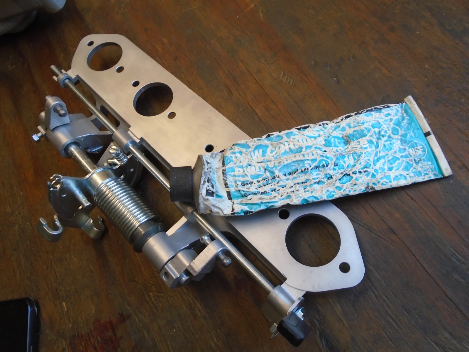

If it helps? I do multitudes of carb 4-cyl banks. If the bronze (2) are in decent shape and the holder isn't warped, just slide it thru to verify first, any oiling isn't a make-up for warpage. There are felt o-rings that keep the grit out. No reasoning to put any emollient to "grab" grit from the surroundings in the bracket 2 bushings, like hardrock mentioned, dry is just fine. If You are working on the 72-75 carbs with multiple joints use a silicone grease like Dow Corning High Vacuum grease. And walk a bit down the threads of adjusters too, keeps everything happily adjustable in the future.

Actually to verify this conclusion as to oil or not, pull Your shaft out the bracket, You won't find any lubricant. Just dried out brown felts perhaps but you won't even find any semblance of any lube as originally equipped.

Nothing like proof thru photos, i do a lot of similar crap and have resulting feedback over singular sales of banks and restorations completed. Nothing will go array if You don't lubricate them bushings but Dip those ball bearing similiar joints in whatever lube You choose.
