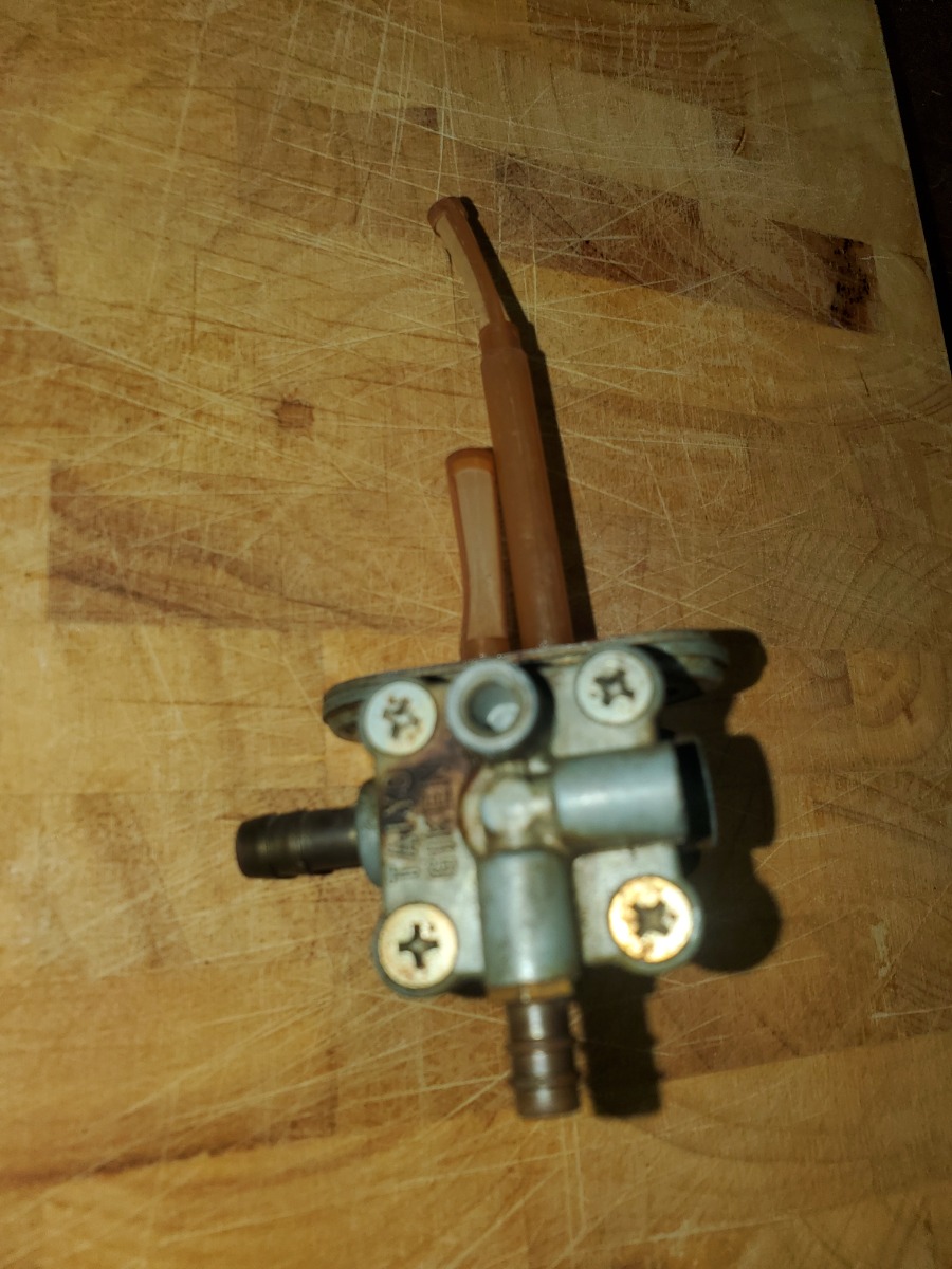

The petcock should have two hoses hooked to it. The larger diameter hose is for fuel and should connect to the fuel t between the carburetors. The smaller hose is to supply vacuum to the valve. On most KZs it connects to one of the carburetors. If the diaphragm inside the petcock is torn, it can allow too much air into the carburetor the hose is connected to, thus creating a very lean mixture. If the hose is cracked, the same problem will occur. If the hose is not connected, the lean mixture will be worse and the petcock will not work as designed.
The purpose of a vacuum operated petcock is to automatically shut off the flow of fuel when the engine stops. That is why there is no off position.

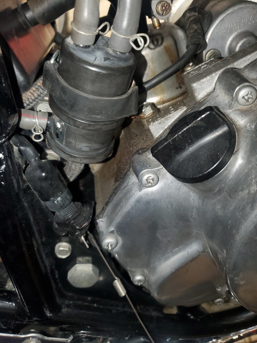

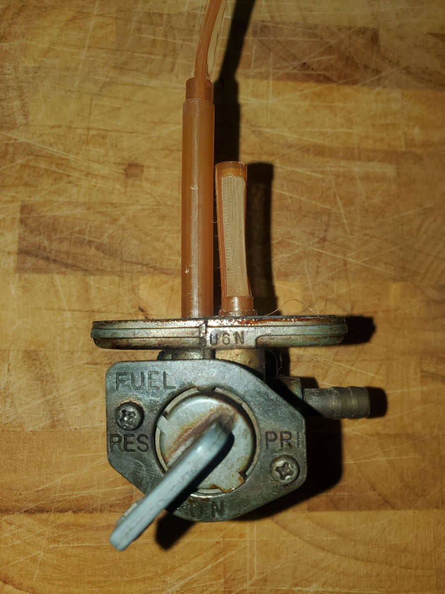

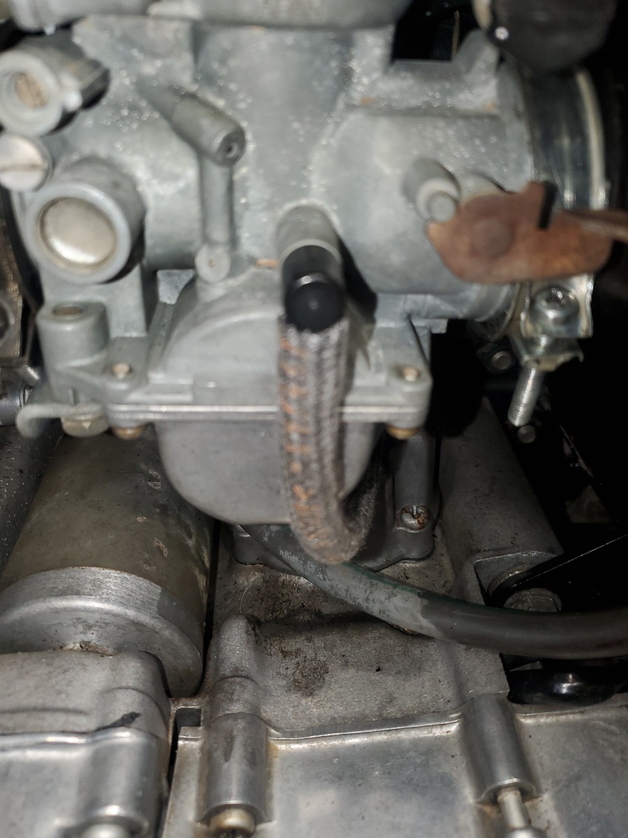

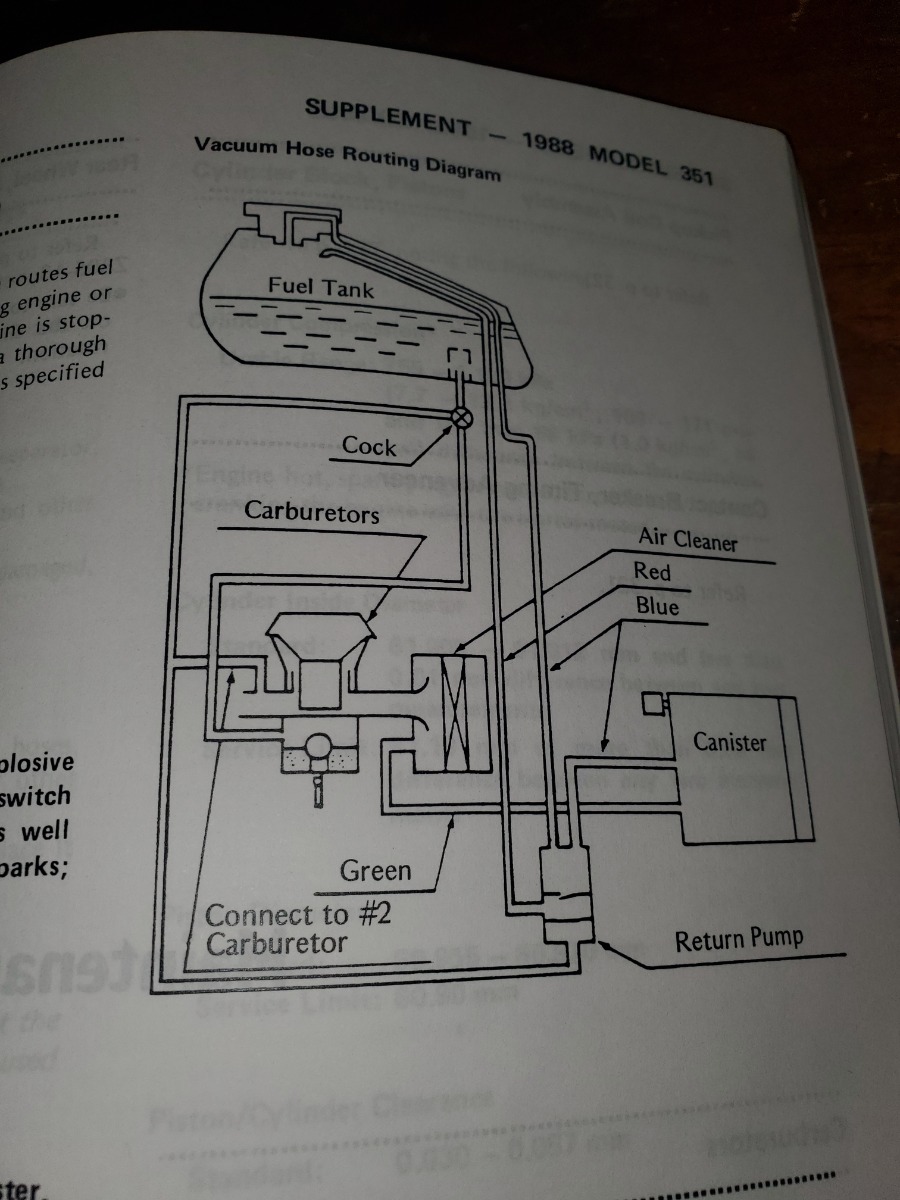

It's been many years but I do remember these systems. Triumphs and BSA's, Norton don't have anything like that. I included a few pix of my fuel tap, carb and evaporative pump. On the vacuum diagram it looks like I need to tie the fuel tap into the black elbows on the carb sides and go to the evap pump

Is that vac line on the side of the canister open to atmosphere ? The diagram shows it going back to the tank. This would effect the fuel petcock. How does it run with the petcock in the "prime" position?

Thanks for fixing them. Everything is hooked up according to the diagram except someone had put in just an on/off fuel tap, so there's no vacuum line to the fuel tap. I need to rebuild it and "T" it in to the black elbows

If the manual tap works, and you do not mind remembering to use it, then there is no need to mess with the factory valve.

I wonder if something in that evaporative system might be hooked up wrong or malfunctioning in a way that causes a vacuum in the tank, similar to a clogged vent?
The device identified as the return pump would be high on my list of suspects. It looks like it could be hiding a one way valve or a diaphragm that after all these years could be malfunctioning. My personal inclination would be to remove them system completely to eliminate it as a possible problem.
