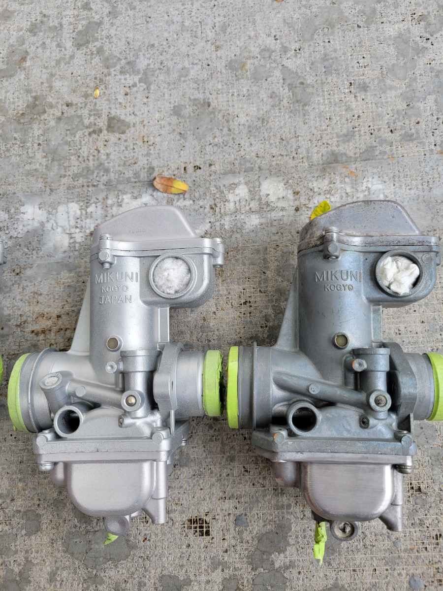

O ya silicone is the best. Just ask the guy (Rest In Peace)who rebuilt one of the last z1 bikes I bought. You can never have enough silicone can you. I don't see the need to blast the carbs but if you do it correctly it can be done. Now your carbs look good and I bet you won't find any beads in them. Obviously George needs to stop doing it that way.

The bead blasting is purely cosmetic, and adds a LOT of extra labor. It takes a fair bit of time to mask up the carb, to minimize grit inside, not to mention blasting time. VM carb bodies are zinc, not aluminum, and it takes some time in the cabinet to get them clean. After blasting, the body gets scrubbed to within an inch of its life, to make sure no grit or grime remains behind.

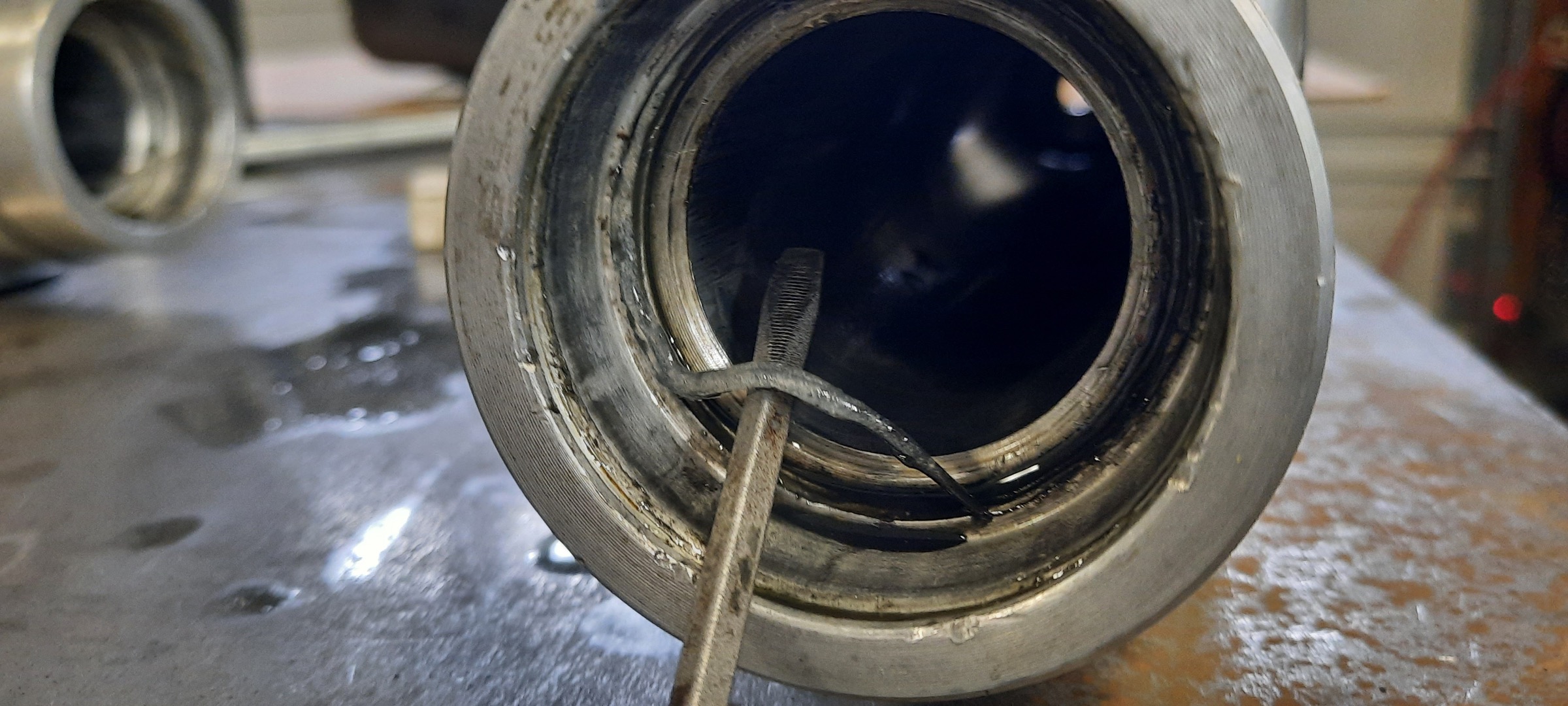

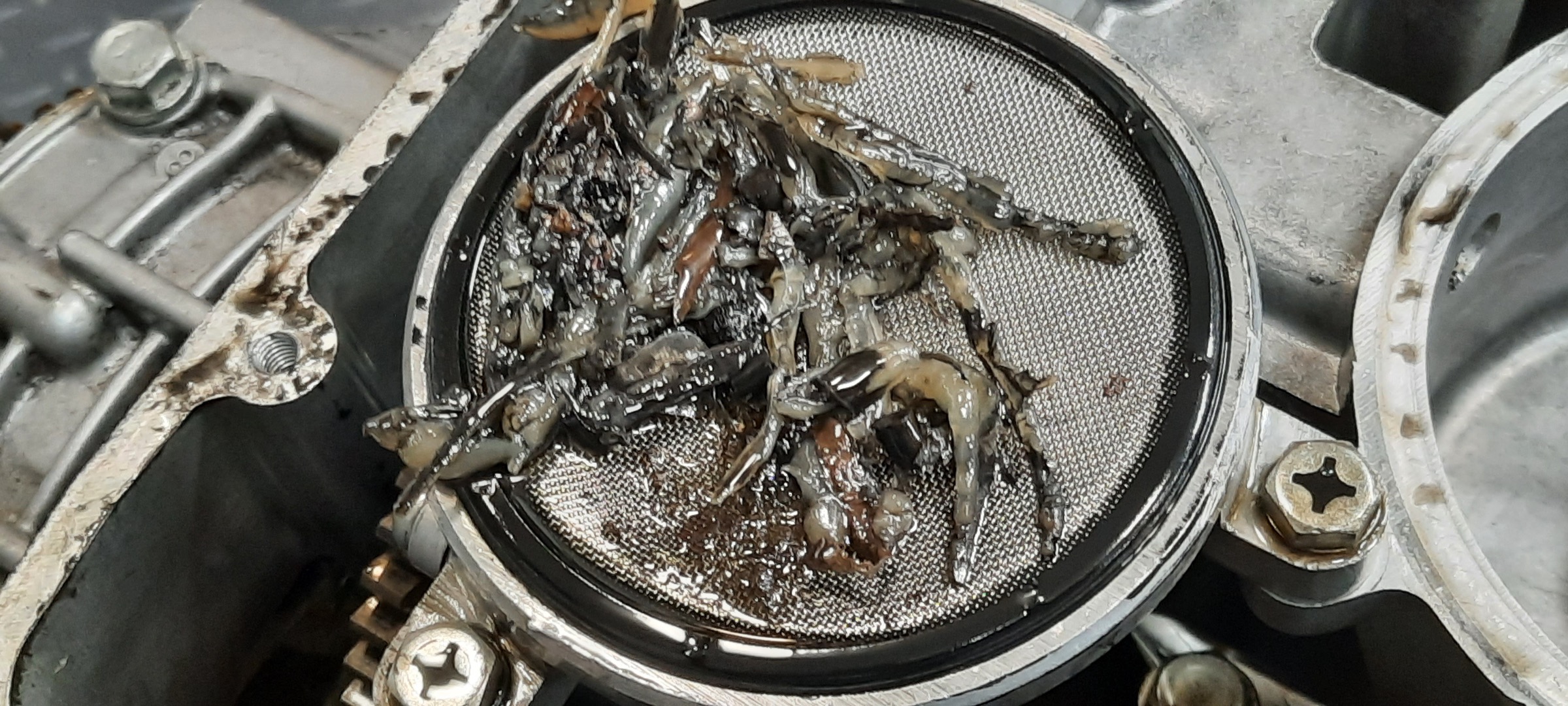

Saw that photo of silicone scraps on the screen and it reminded me - when permatex first started marketing their RTV silicone "gasket maker" (their term not mine!) they had an ad campaign where they assembled a V8 (chevy I think, may have been a ford) using silicone in place of all the gaskets except the head gaskets. But we never saw what ended up in the oil pump and oil pan!
