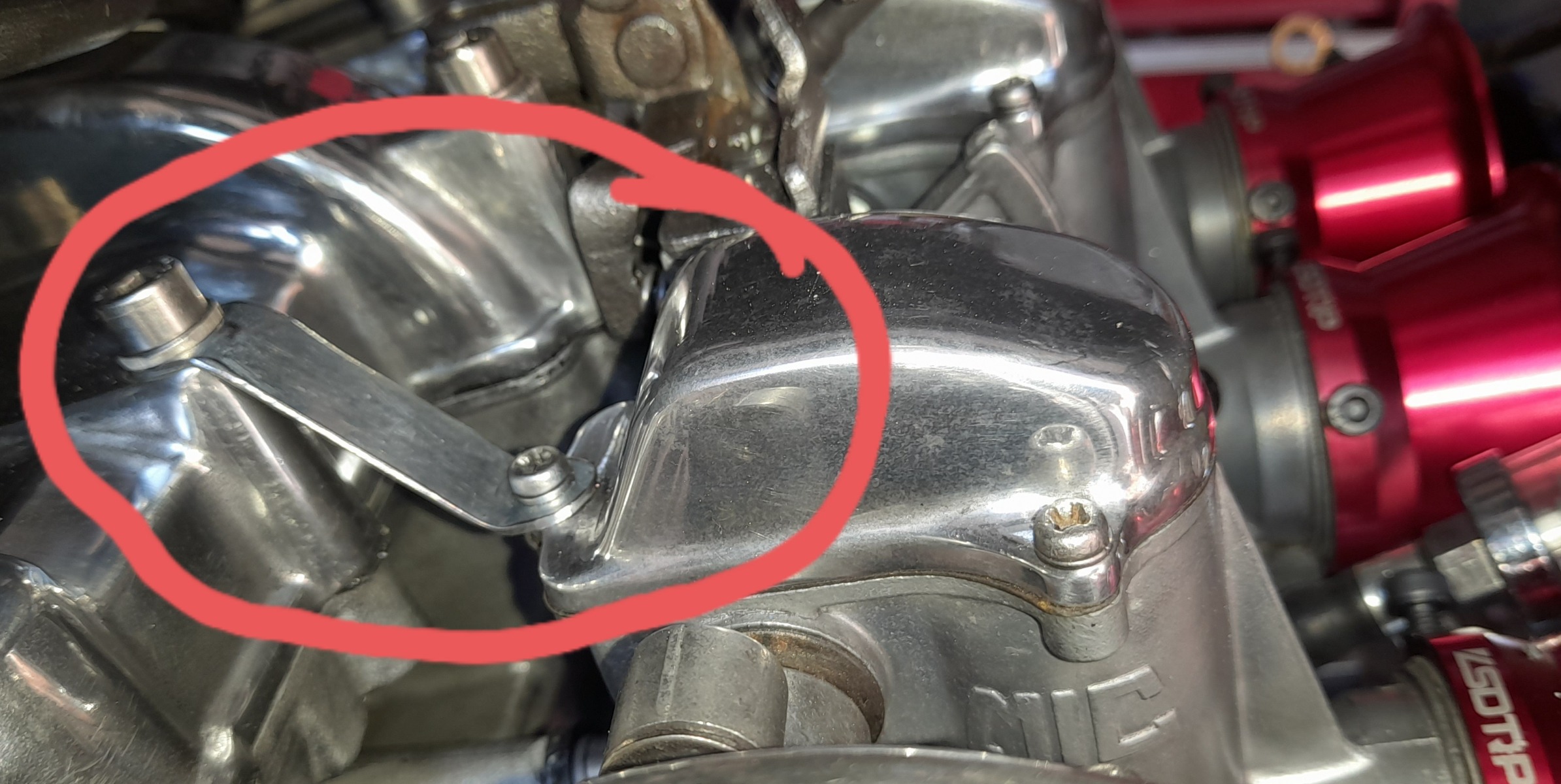

Yes, they are very soft and split at the mount tube joint. Especially so if you have stacks or pods due to carb bounce. Not so much if you still have the original air box as the carbs are supported on both side.
Remedy is to make a couple of straps that stop any bounce. Carbs 2 & 3 to cam cover bolts.Â

Its good to know that i'm not the only one that has had issues with the knock off cheap carb boots. The set i'm using lasted a little over a year. I was having issues with RPM's surging and not coming down. I went to take off one of the caps on the metal stems on the carb boots and the whole stem came with the cap. I checked the others and i can wiggle the stems around but they didn't pull out entirely.
ill make some brackets this time around.
