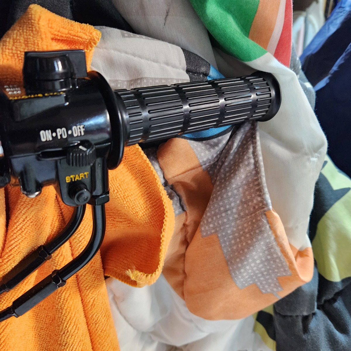

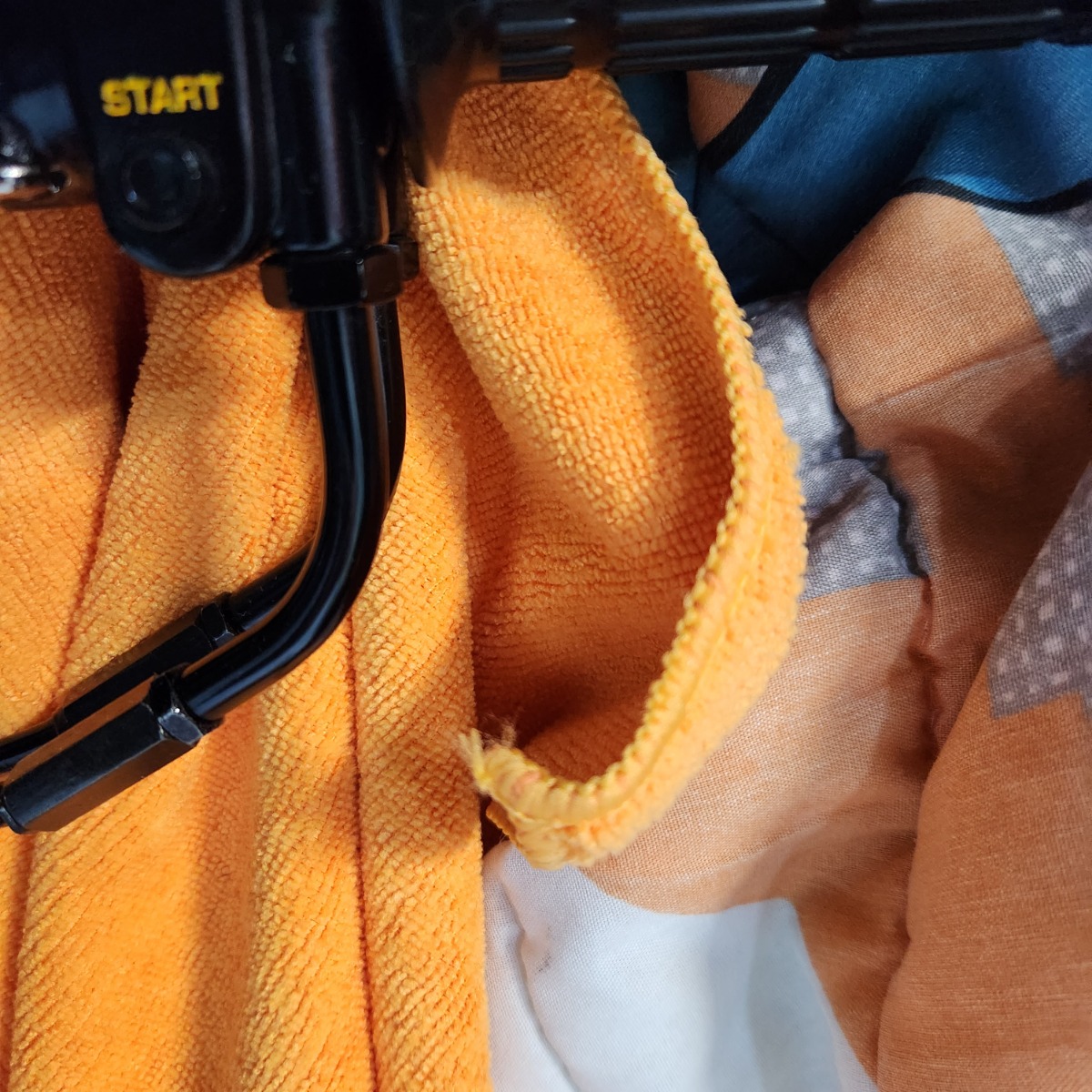

The two throttle cables appear to be identical at the throttle. Here is mine below. Partzilla shows the 2 cables with the same bend on their website.
Gonna punt and just order 2 of the same.

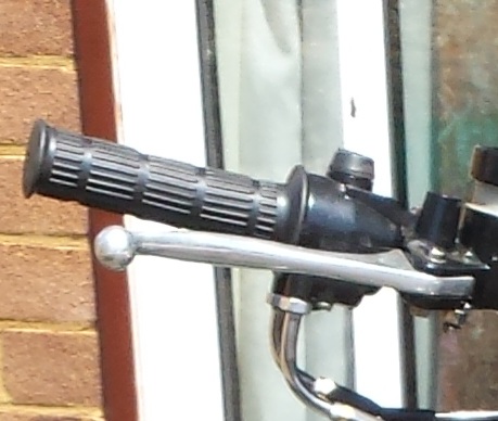

The front cable in the picture has less of a curve on it to allow screwing it in otherwise it will hit the back cable when you rotate it.
Original cables on my owned since new b1

Thanks Warren3200GT, Gonna source the other "pull" cable.
Meaning the 2nd different pull cable that "closes".
From your picture, Do you recall which of your pull cables is for " open "? The Front or back cable ?

I believe the front is " open" and the rear is "close" this seems to make sense if you think about the rotation of the twist grip
