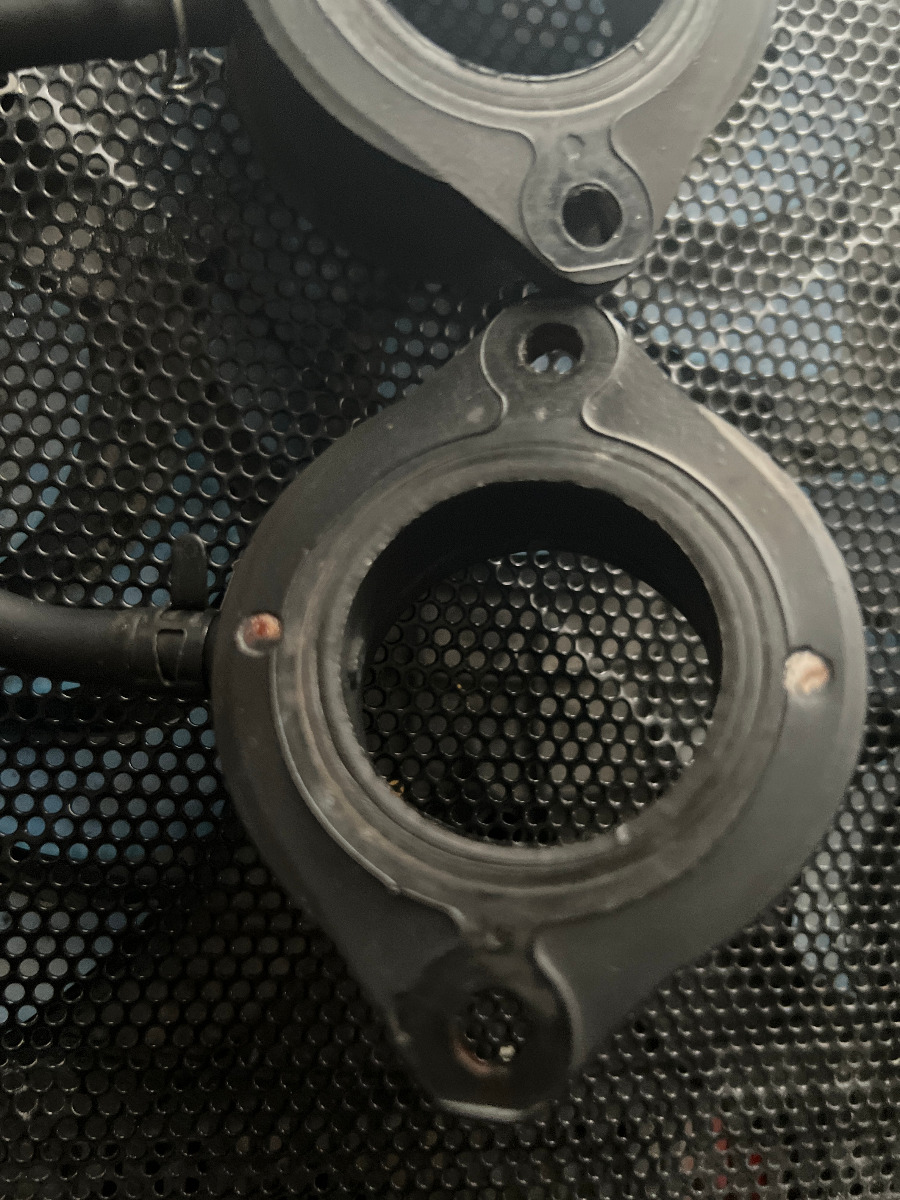

Those boots look beat.  You might want to replace them...assuming new ones are available.
Old boots often lead to vacuum leaks, which causes a raising idle when warm.  I replaced the boots on my bike straight away, during the restoration.
Thats a stock photo meant to show the lip. Those are not the ones i have.
——> Yes, lip. There’s no replaceable o-ring in that holder.
These are the ones that are going on the bike. These are mine.

Those don’t look bad Dan. The sides are not cracked?
Anyway, I recently installed my o-ring types with a smear of non hardening Hylomar gasket sealer. I believe it helps.
Thanks for responding! The sides are fully intact. I plan to smear just a little bit of Hondabond HT on the manifold-facing part of the boot. Funny you should suggest the very same thing.

——> The Hondabond certainly wouldn’t hurt.
On a single cylinder 250cc Honda Helix scooter I had, the carb holder was dried and cracked. I took it in the house and scoured it with liquid dish soap to get all the grease off it.
Then I smeared the entire outside of it with high temp silicone sealer. Let dry. Then reinstalled.
My nephew now has that scooter and the cracked/repaired carb holder is still working ten years later!
