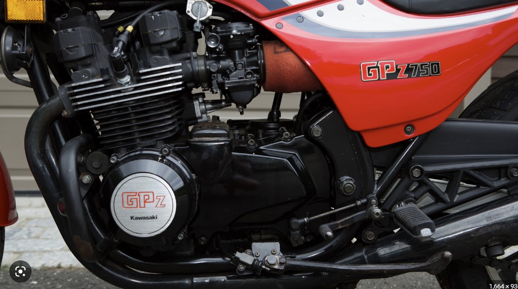

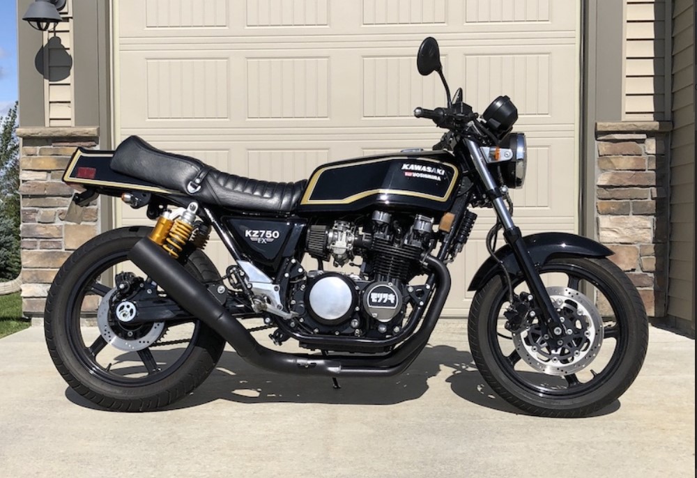

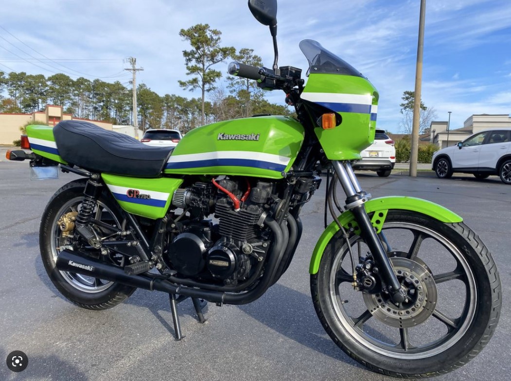

Re: Where to buy Carburetor??!!
15 Dec 2022 18:11
I don’t know what set up they have.. I’m happy for them if their bikes runs well. Mine 7500rpm over, the bike cry like devil until 9-10 000rpm and doesn’t go faster!! Maybe my CV are tired?! Dont know
