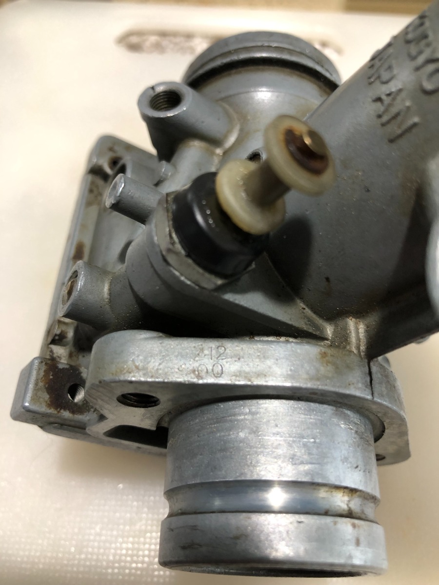

- Posts: 8214
- Thanks: 3580
Re: Carb opinion
13 Dec 2022 05:10 - 13 Dec 2022 05:27
I think he's referring to the code stamped into the flange of the carb. Z12 00 to be more specific. These are late 900 carbs. They have pilot air screws, a joining plate across the top, and some slightly different bits as compared to the later VM26's.

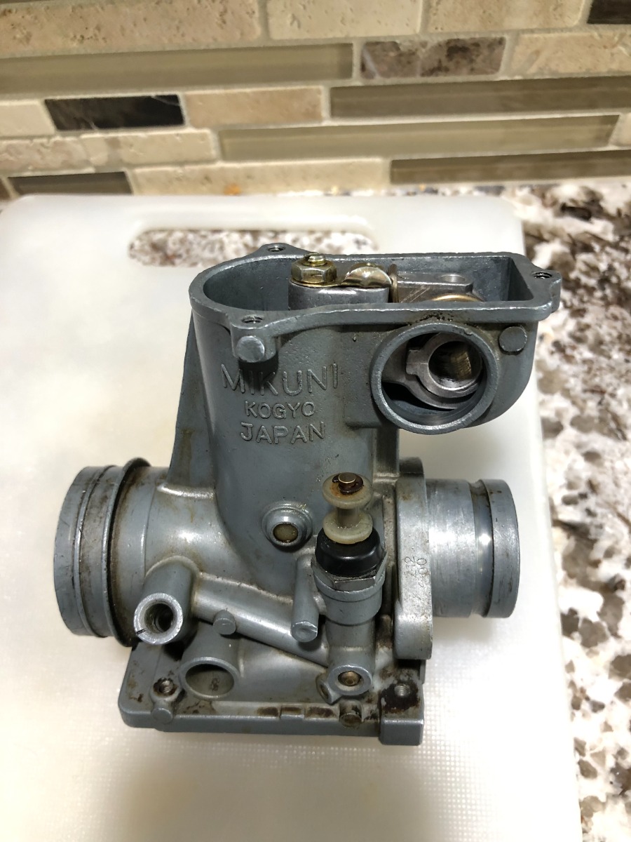

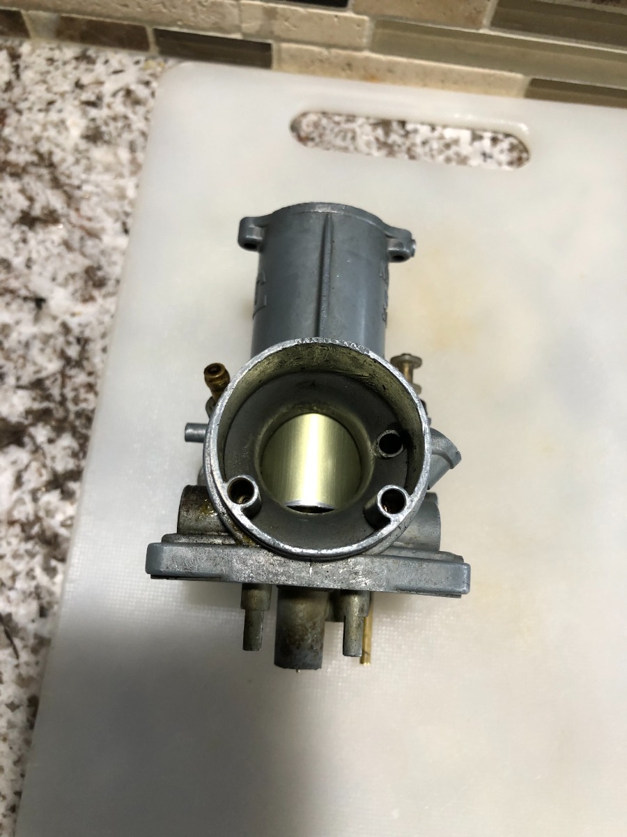

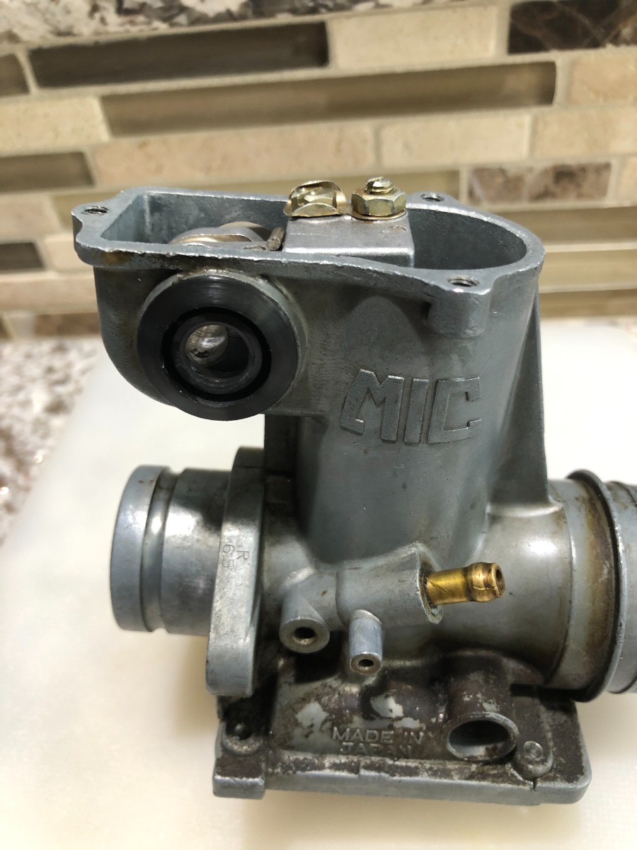

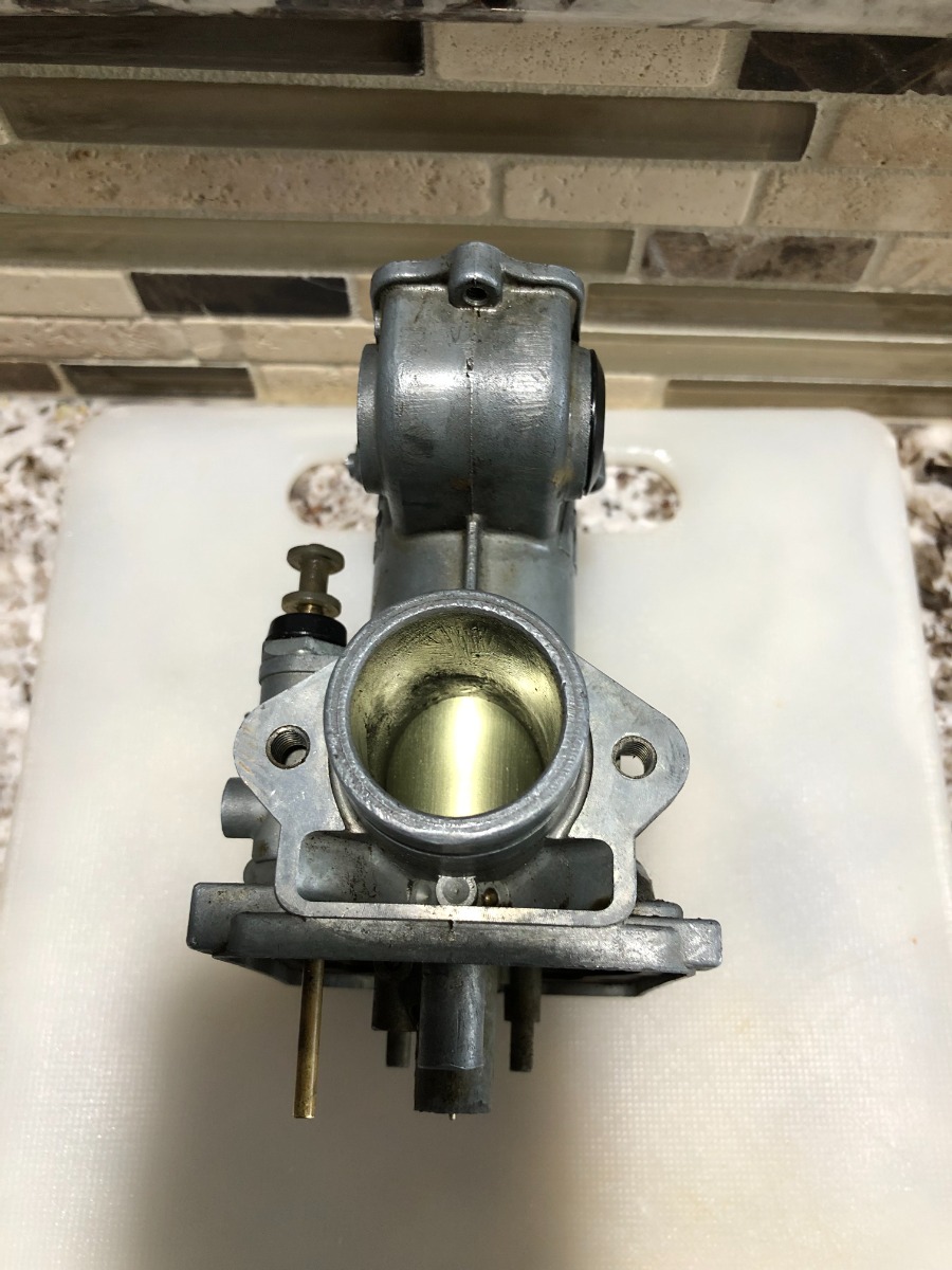

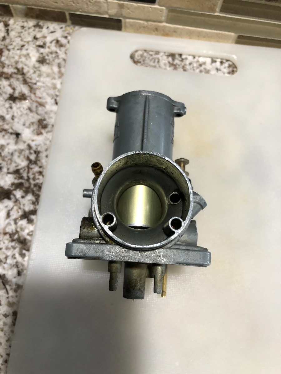

Re: Carb opinion
13 Dec 2022 12:50
Yes the Z12 over 00 is the # on the flange.
What is the carb cutaway ?
I just took a pic of the one carb I separated from the rack, there is a plate that attaches to the top of all the carbs
There is no accelerator pump on these or the GS carbs

- Posts: 3162
- Thanks: 1252
Re: Carb opinion
13 Dec 2022 15:32 - 13 Dec 2022 15:38
The cutaway is that missing section on the bottom of the slide. There should be a number on the slide...I think on the bottom. It will either be 1.5 or 2.0.
I can see the air/fuel adjuster on the intake side of the carb. This is evidence of them being from a KZ900.
I noticed a date code on one of the photos. 65. That means either June/75 or May/76. In either case it points to those being from a KZ900. The cutaway will be definitive.
