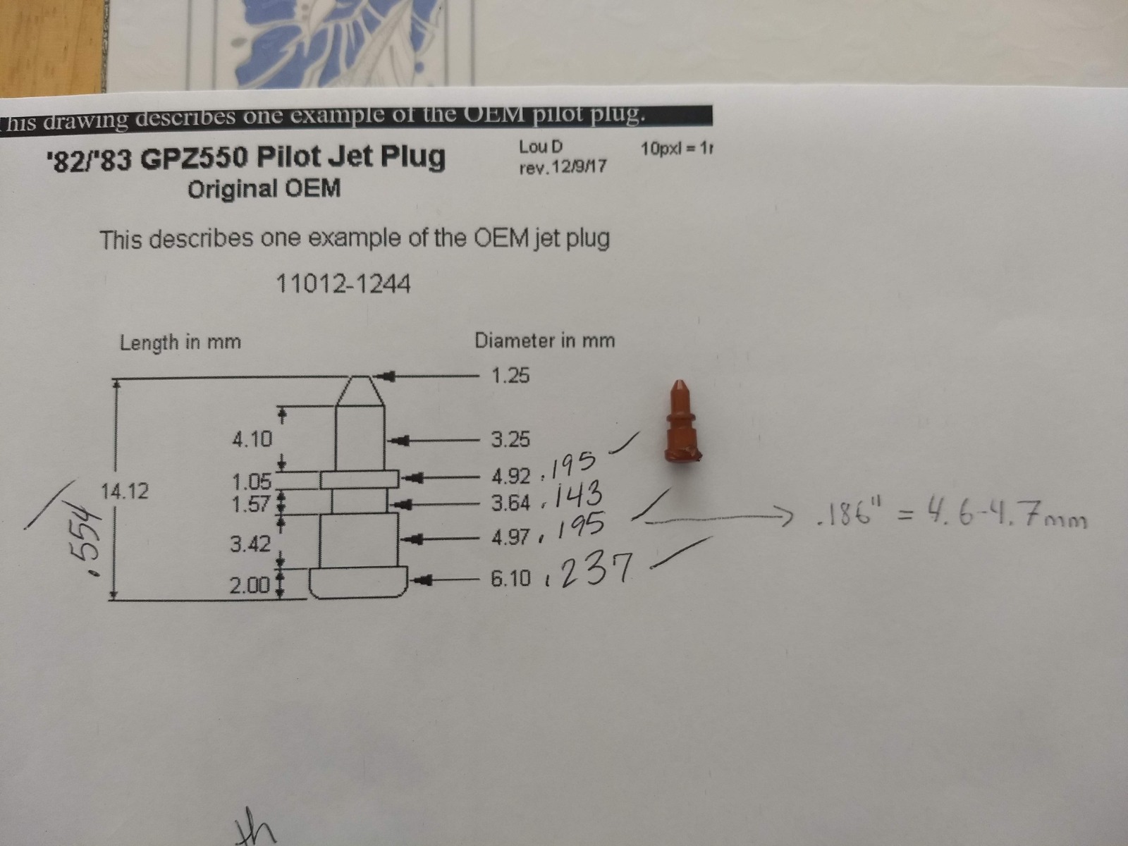

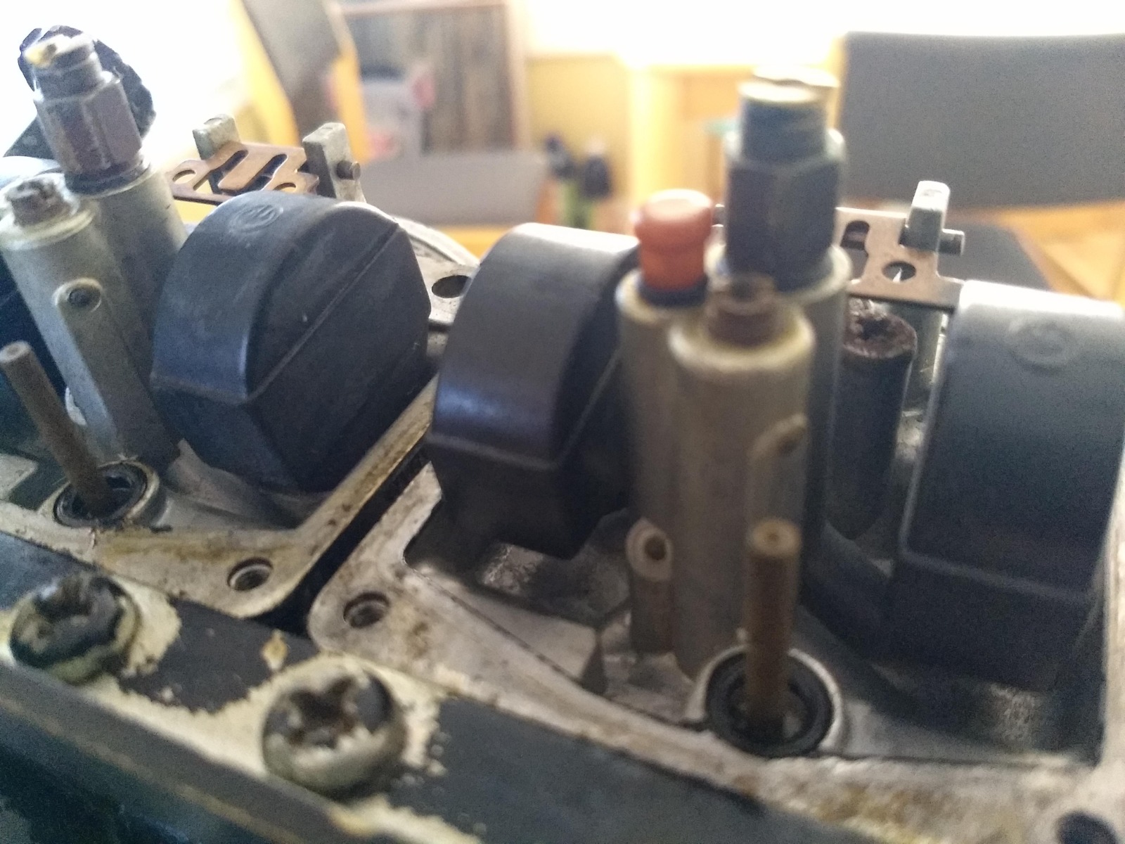

Gone through the 1982 GPZ-550 carburetors and they are clean as a whistle now but the O-rings on the pilot jet plug have disintegrated.
The plugs, original orange in color, are good, but I am not having any luck finding replacement O-rings. I think the part number is 92055-1337.
The dimensions need to be about 3.5 mm inner diameter and 4,6 to 4.7 outer diameter.
The originals were, I believe, a bit tapered like a cork in a bottle. Not sure if this specification really matters.
Also, a possibly silly question as I am not very knowledgeable on carbs but is this O-ring exposed to gasoline so needs to be fuel rated? I think so.
I have done some searches but anything I find says out of stock and I am guessing they have been for a while.
Thank you for any help.

I have tried 3 sets so far. The inner diameter of 3.5 mm seems doable, but the 4.6 to 4.7 overall diameter seems to be the challenge.
Don't they need to be fuel resistant as well?

23 Oct 2022 12:34 - 23 Oct 2022 12:39The size where the plug needs to go in is a bit loose without an O-ring and measures 4.8mm using calipers.What is the size of the passage in the carb?
BTW, O-rings are sized by ID and thickness.
The outer diameter of the plug is 4.7. O-rings with an outer diameter of 5.2 to 5.3 are a no go. So maybe 4.9 to 5.0 is a better size to shoot for.
My understanding of the dimensions provided on web sites are the outer diameter plus the cross section of the thickness of the rubber.
So, I would need 3.5 ID with a thickness of .7 times 2 to get to 4.9mm overall. Is this correct?

23 Oct 2022 13:14 - 23 Oct 2022 13:18So, is my math correct? The OD diameter of these would be 3.5 + .9 + .9 = 5.3mm.I've got some 3.5 x .9mm O-rings. Those might work. Use some silicone grease before install.
We have a few this size and even with silicone they will not go in evenly.
Do they need to be rated for fuel/gasoline?

Some auto parts stores sell individual o-rings out of a kit. If you find one of the correct ID but the OD is too large, maybe go with a smaller ID & make it fit. You could use silicone spray lubricant to install or heat it in hot hot water beforehand. It's just a static plug o-ring, so it only needs to seal & a perfect fit probably isn't necessary.

The O-ring for the Keihin CV34 pilot plug are quite large, and get smashed down significantly during install. The first time I rebuilt a set of those carbs, I thought the seal was a cylindrical sleeve, instead of an O-ring, because the O-ring formed that shape. My guess is that in this application it's similar.
And realize, if the carb hole is 4.8mm, you want the "as installed" O-ring to be about 5.2, since the O-ring must crush on install to affect a seal.
