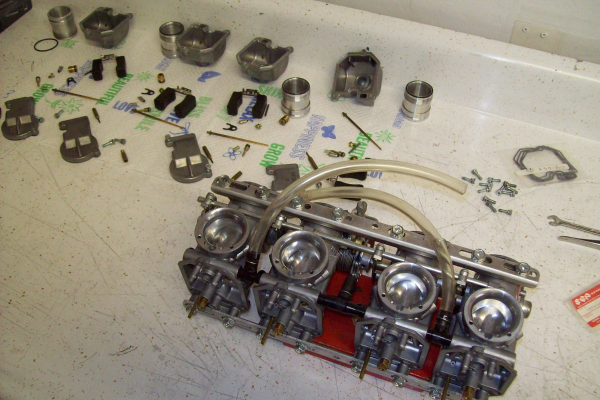

question for you Dr G ....can I do this needle & o-ring swap with the entire rack of carbs still mounted to the engine ? (ie: caps off and bowls removed "only") or do I / will I have to remove the entire rack of carbs for this job to be done on my bench ? I would HIGHLY not prefer to remove the entire rack of carbs unless absolutely necessary ....let me know, thanks -
Last edit: 02 Nov 2022 13:15 by Uncle Freddy.
- Dr. Gamma
- Posts: 1231
- Thanks: 698
Re: CR Special Carbs / '83 650 / occasional single carb fuel leak ?
02 Nov 2022 13:46
If you want to set the float height correctly, you have to pull the carbs. You have to get the carb bodies to be angled at a certain degree to set the float height. Everytime I replaced the seat o-rings my float height changed!!! I cheat now when I go to put the CR's back on the motor. I heat up the rubber intake boots with a hair dryer. Then the carbs slip right in!!!!

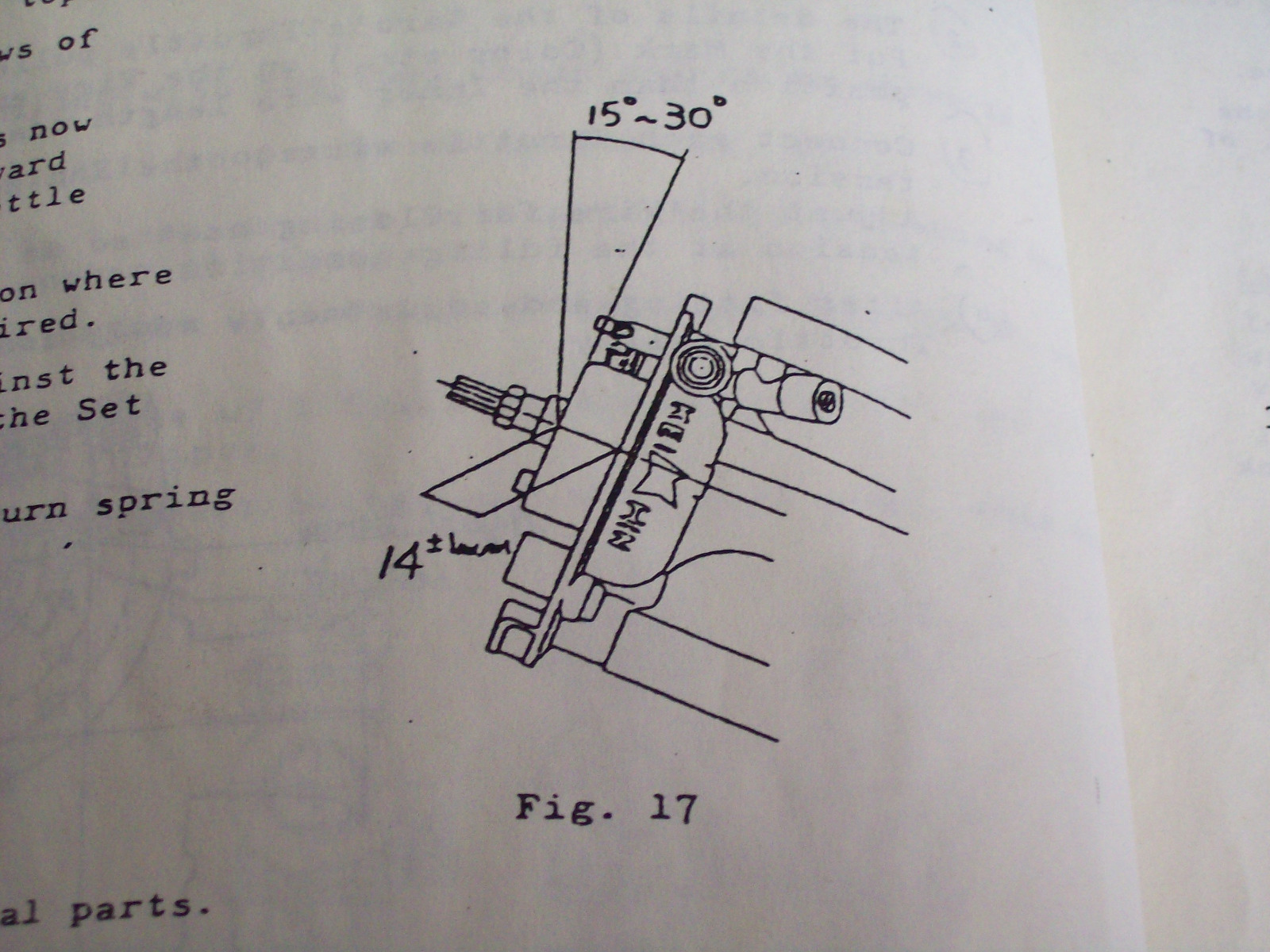

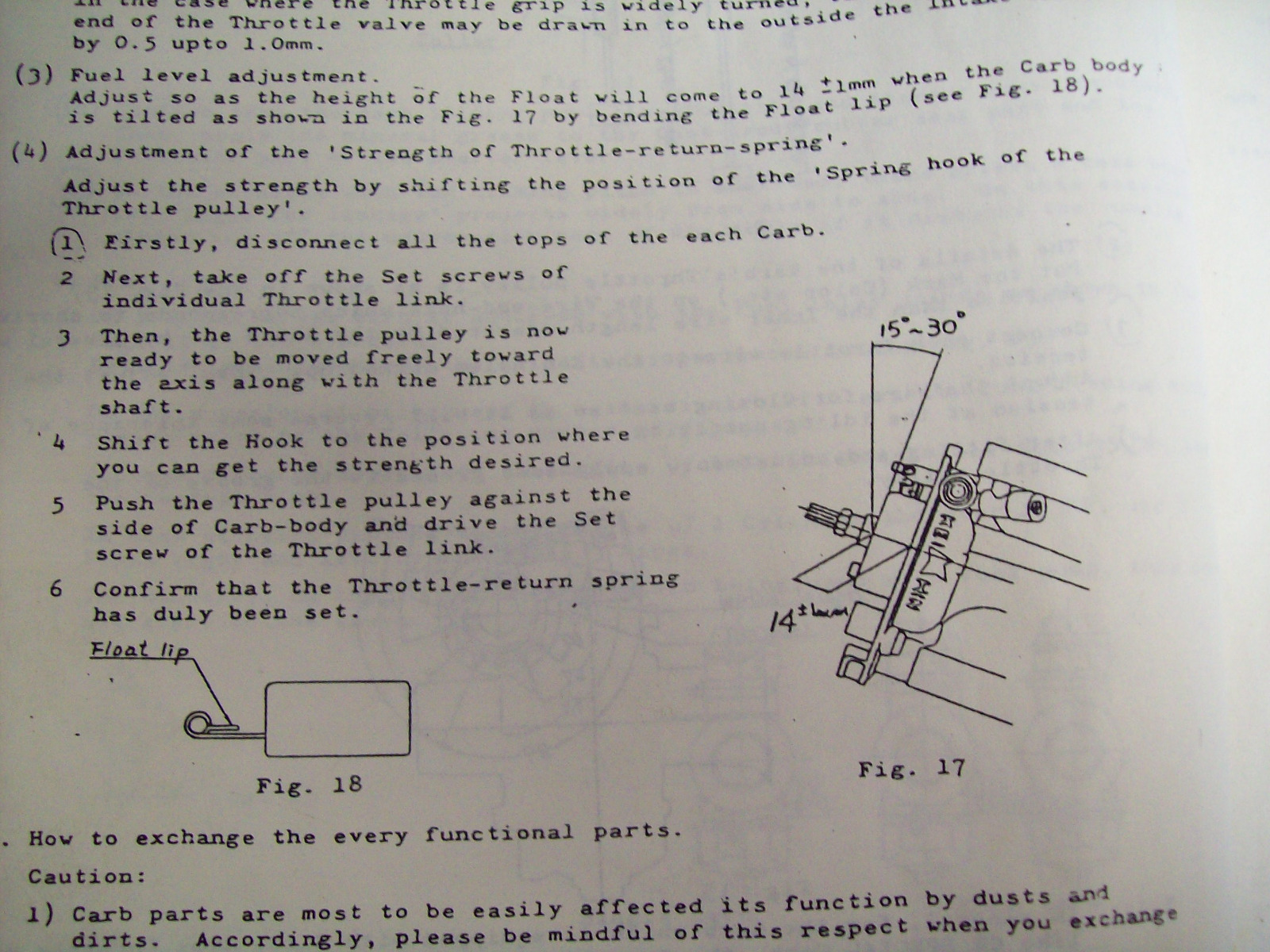

morning ....hey, if I could get a full copy of that float adjustment page(s) with all the text readable, and all drawings / diagrams and instructions, I'd highly appreciate Dr G !
- Dr. Gamma
- Posts: 1231
- Thanks: 698
14 Nov 2022 10:52 - 14 Nov 2022 13:56
There is only one tiny paragraph and two drawings on how to set the float height in my vintage '80's CR manual.
I never set up any of my CR's using the fuel level measurement in the bowls. I always got the same plug readings across all four cylinders with just setting the float height. So I never bothered doing them that way. You angle the carbs over till you get the weight off the spring inside the float needle. You want the little plunger on the float needle to be fully extended when you measure your float height.
Here you go!!!!
Here you go!!!!

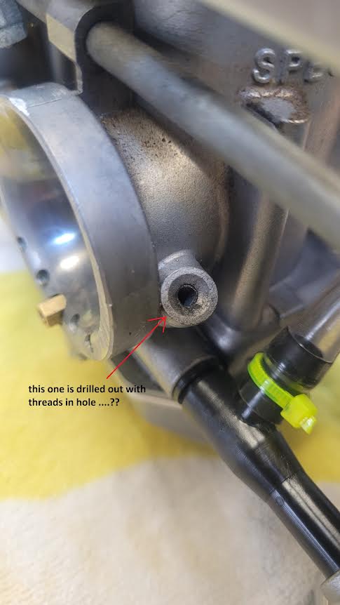

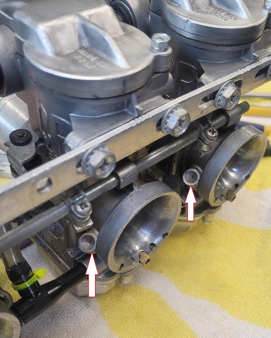

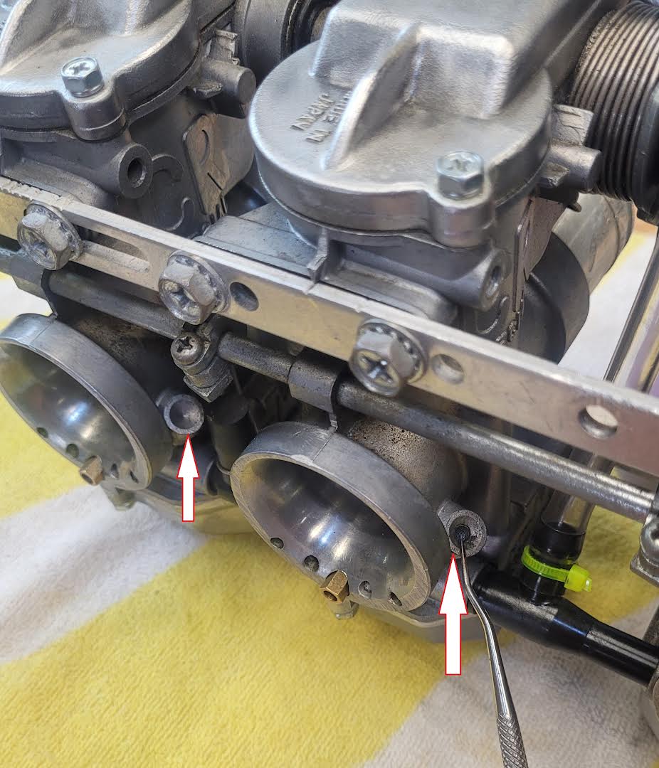

hey Dr Gamma, finally got around to swapping out the o-rings you recommended for the seats and installed new needles as well ......question, see these 3 pics .....noticed (first time since 1985 !) that one of these solid ports is drilled out, has threads in the hole but has no fastener (a bleed screw of sorts I would imagine) .....can you supply intel on what this 4th port is / does and why there are threads in it .....where you attach synching tool maybe ? ....bottom line: does this port need to remain open or have something screwed into it ? ....THANK YOU !!!!
Last edit: 01 May 2023 11:49 by Uncle Freddy.
- Dr. Gamma
- Posts: 1231
- Thanks: 698
01 May 2023 11:52
There is a little bracket that holds the fuel tee in place from sliding back and forth. It is held in place by a screw that threads into that place on #2 carb. I just went and checked the carbs on my bike and I removed that bracket years ago and have not have any problems since removing it!!!!! I say don't worry about it being missing!!!!
1986 RG500G 2 stroke terror.
The following user(s) said Thank You: Uncle Freddy
