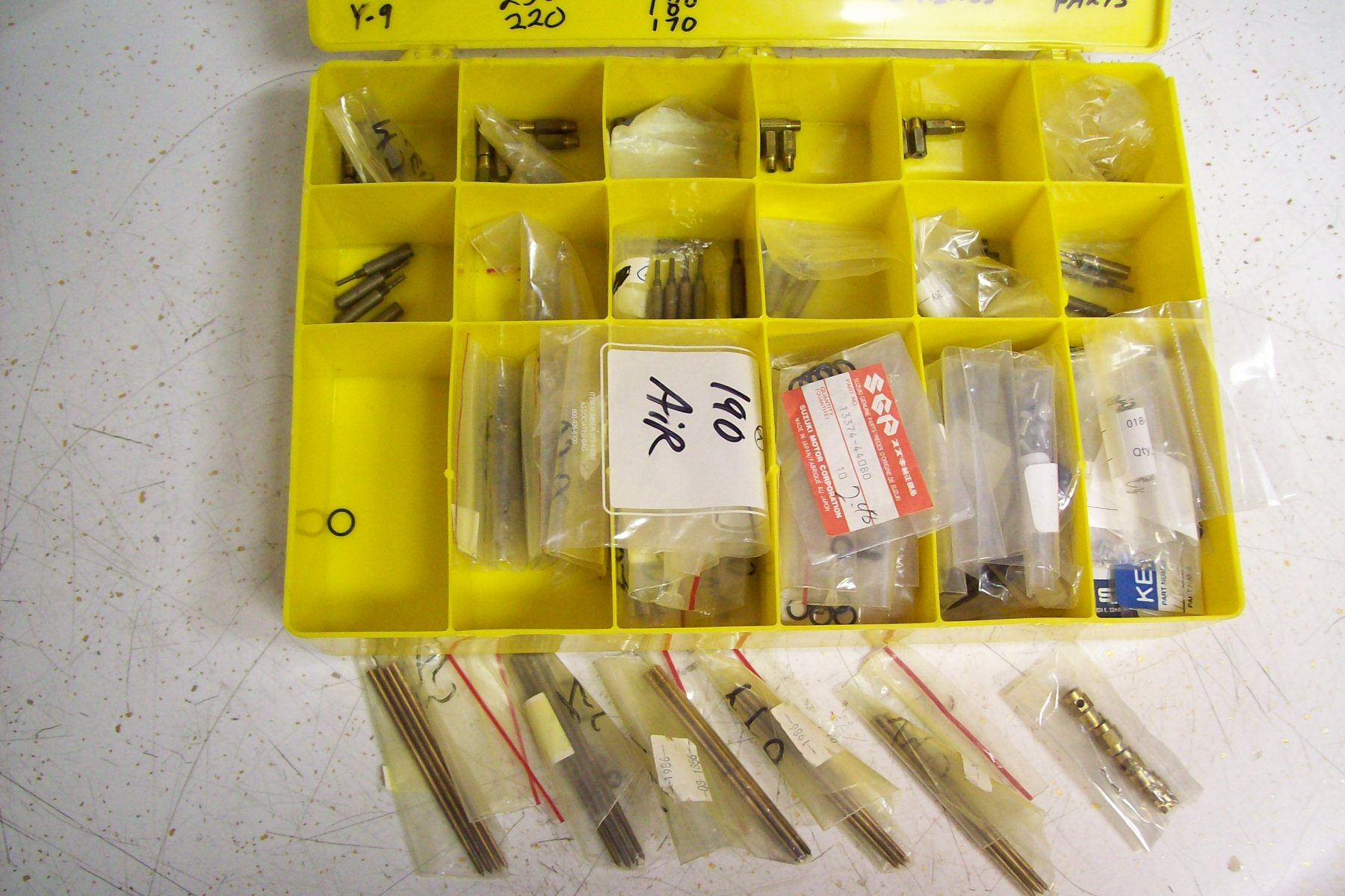

Collection of Keihin parts I keep on hand.

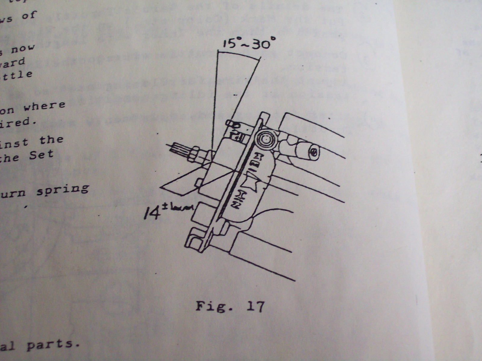

#35 is the o-ring you want. Keihin part number is 16075-MBO-0030. Sudco number is 018-694. Sudco is the Master Distributor for Keihin parts in the U.S. They always had my parts in stock over the years. Here is how you are suppose to check float height right out of the factory Keihin CR manual. Make sure you spray the new o-ring and where it fits into the carb body with like WD-40 so you don't hurt the o-ring as you push in the seat.
