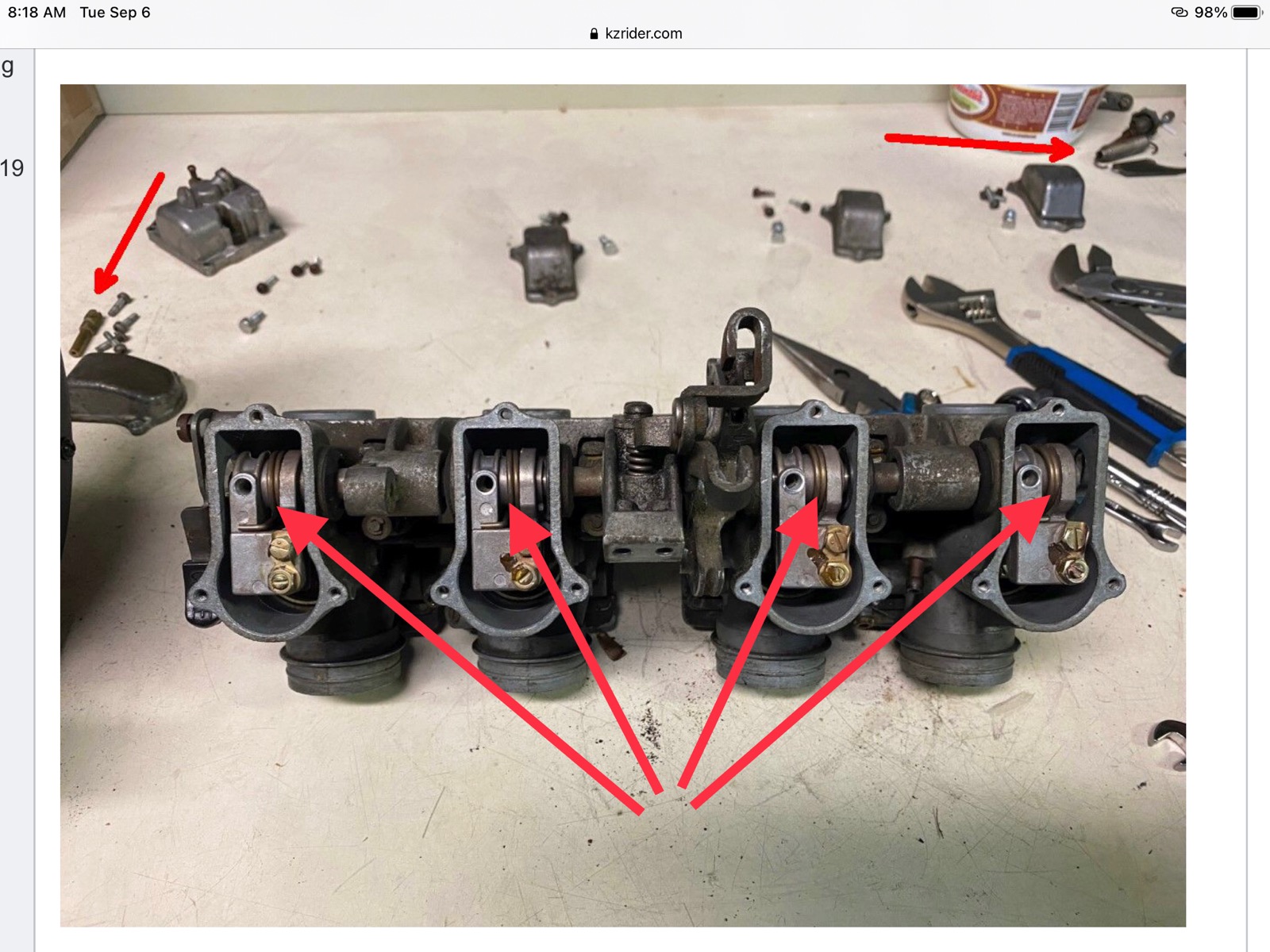

06 Sep 2022 05:26 - 06 Sep 2022 05:34Yes! They are original for the 76 with the smoothbore type spring style slide lifter arms.These carbs came off a 76 KZ900 my dad is working on, who knows if they are original though.

06 Sep 2022 05:30These are the spring assist slide arm assemblies im referring to.

Thanks, now i see the spring assist slide arms.

06 Sep 2022 08:02It's the early variants that use these. I've just finished rebuilding some, with gold colored slides, that are the same. One difference though, the set I did have air screws, and these seem to have fuel screws.Thanks, now i see the spring assist slide arms.

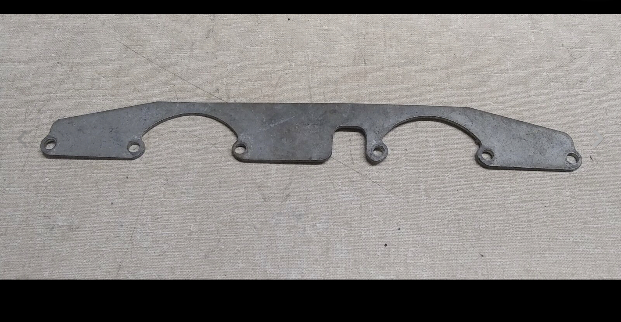

And what is the use of this joining plate?

- Posts: 3122
- Thanks: 1232
Re: 1976 KZ900 26mm Carb Rebuild
07 Sep 2022 14:35
The following user(s) said Thank You: willemZ900
07 Sep 2022 15:33
The K.I.S.S. solution. Problem solved!
