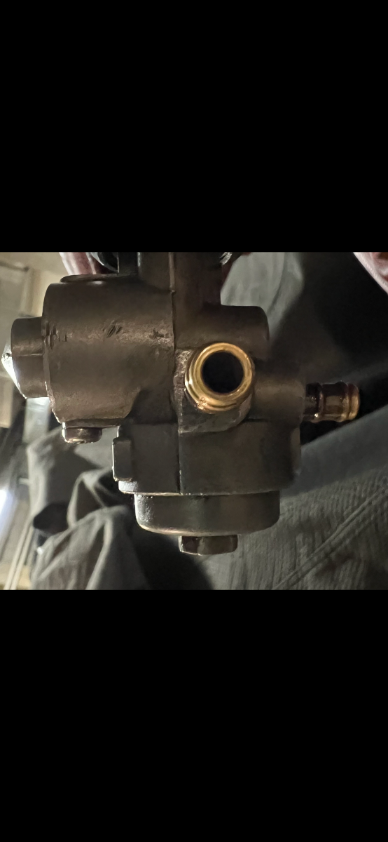

1977 Kawasaki KZ750 Twin B1:
Today I took the tank off and drained it.
I put two fuel lines on the petcock, turned the petcock to the ON position and let the fuel drain into a bucket.
As you know, each line directly feeds one of the two carbs.
While draining, I saw that fuel came out of only ONE of the two fuel line connections.
Then it would, then it wouldnt. Is this indicative of a blocked petcock?
Shouldnt fuel CONTINUALLY pour out of BOTH fuel lines to feed the carbs? Photo below.
Fuel came out of the spigot facing you only SOMETIMES.
The one pointing to the right had a continual flow of fuel coming out when the Petcock was in the ON position.

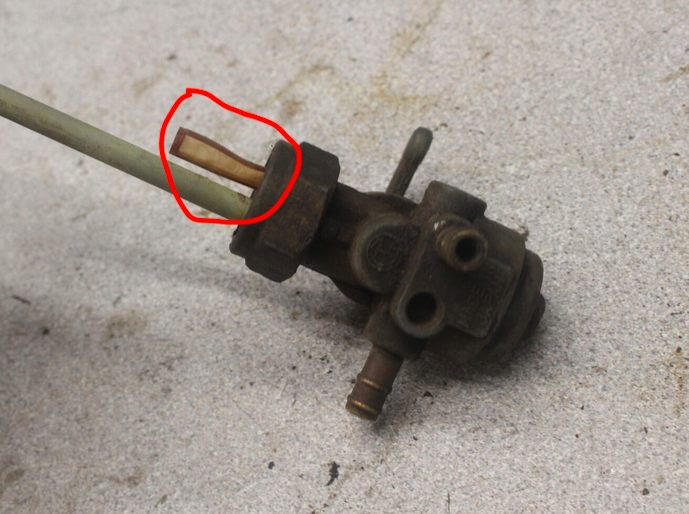

26 Aug 2022 17:33 - 26 Aug 2022 17:42Is the valve assembled backwards?
I have no idea what you mean by that. The petcock worked fine for 4 years between me and the PO. Last winter I let the bike sit longer than usual and it started acting funny. There has been no change in the petcock configuration. Today I took off the petcock bowl, cleaned it, and blew carb cleaner in the ports. Nothing was changed from how its been for 4 years, during which time it worked fine.
I blew air through the main valve and it came out of the two ports, so those are clear. I have no idea how to test whether the reserve position is working because the tank is off the bike and I wont be back "home" until after labor day. Im not going to fill it with fuel and let the tank sit, off the bike, for two weeks. My question is, how does the reserve fuel, when the petcock is on reserve, flow from the tank into the petcock, if not from the plastic tube right alongside the main metal valve that flows fuel when the petcock is in the ON position?
this isnt my petcock but a stock photo i found. Mine looks the same. What does the circled plastic thing do? Doesnt look like it can take in fuel. It has no holes.
Last edit: 26 Aug 2022 17:42 by ShaneDude.
- Posts: 4420
- Thanks: 2269
Re: Petcock vs Carburetor vs Broken down on the side of the road
26 Aug 2022 20:03
The circled plastic thing is a filter for the RES inlet and the long tube for the ON inlet port of the petcock.
