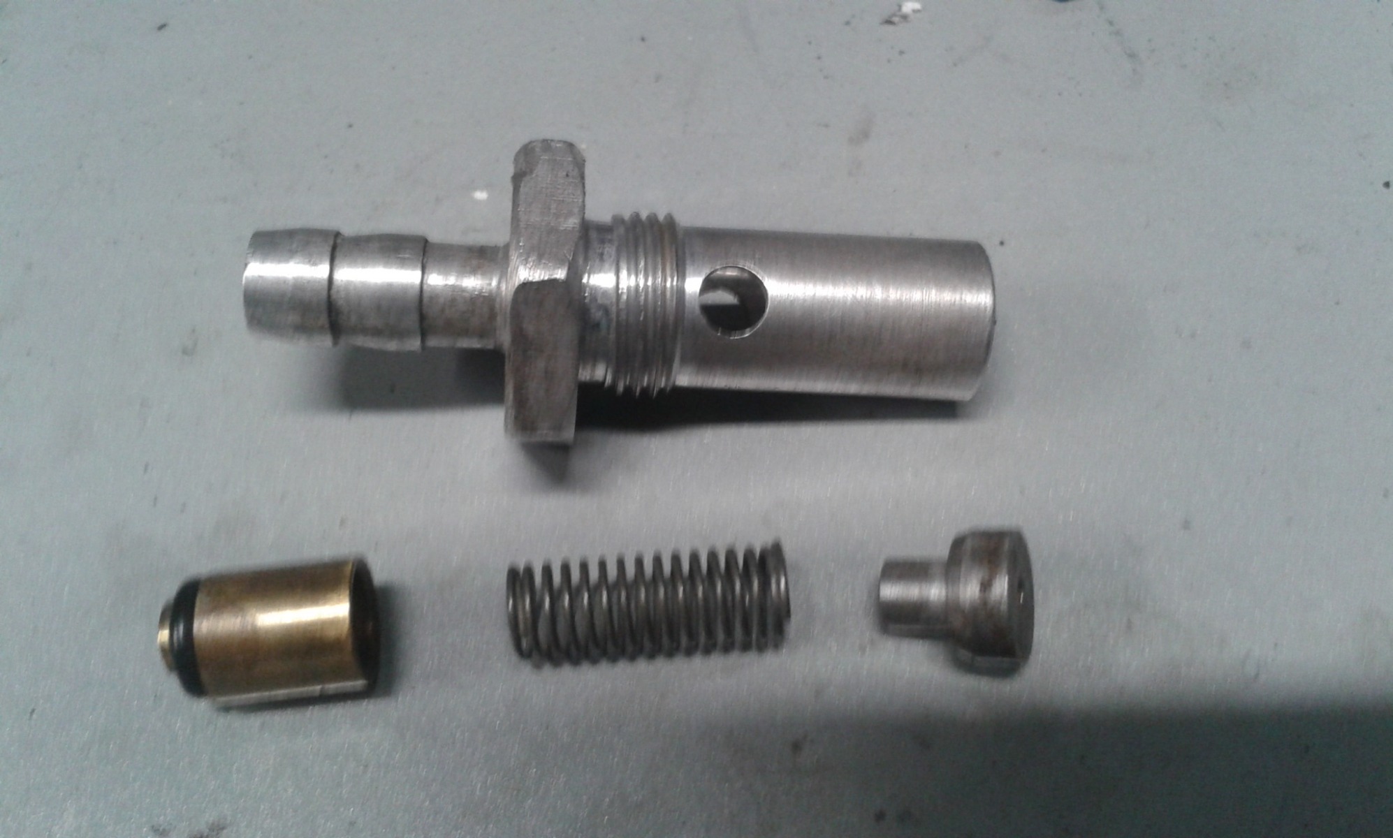

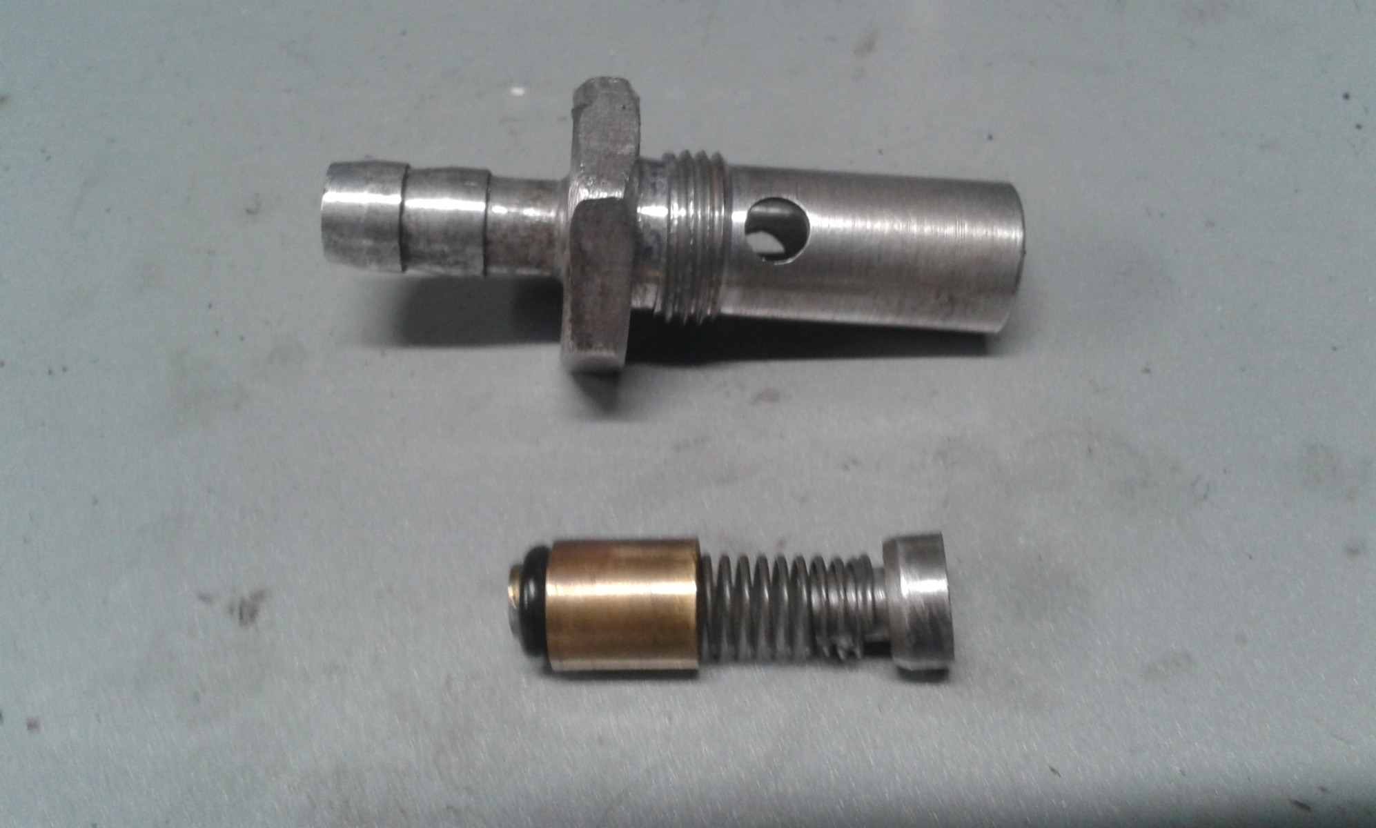

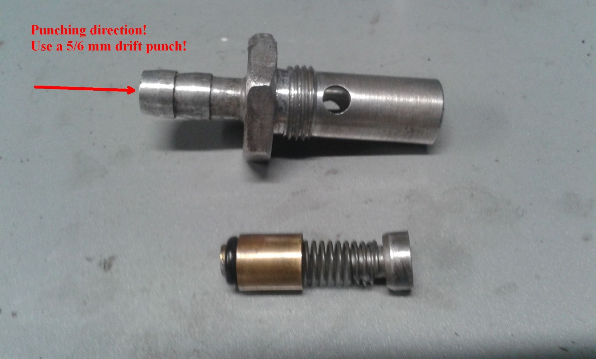

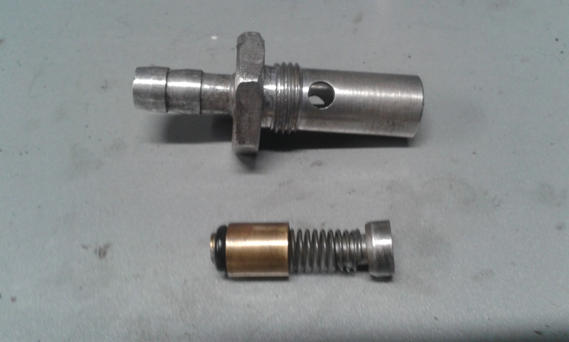

Sometimes the fuel tank check valve is clogged/stuck or the o-ring is no longer present or sealing!
kzrider.com/forum/2-engine/615786-fuel-t...ket-sealant?start=12
