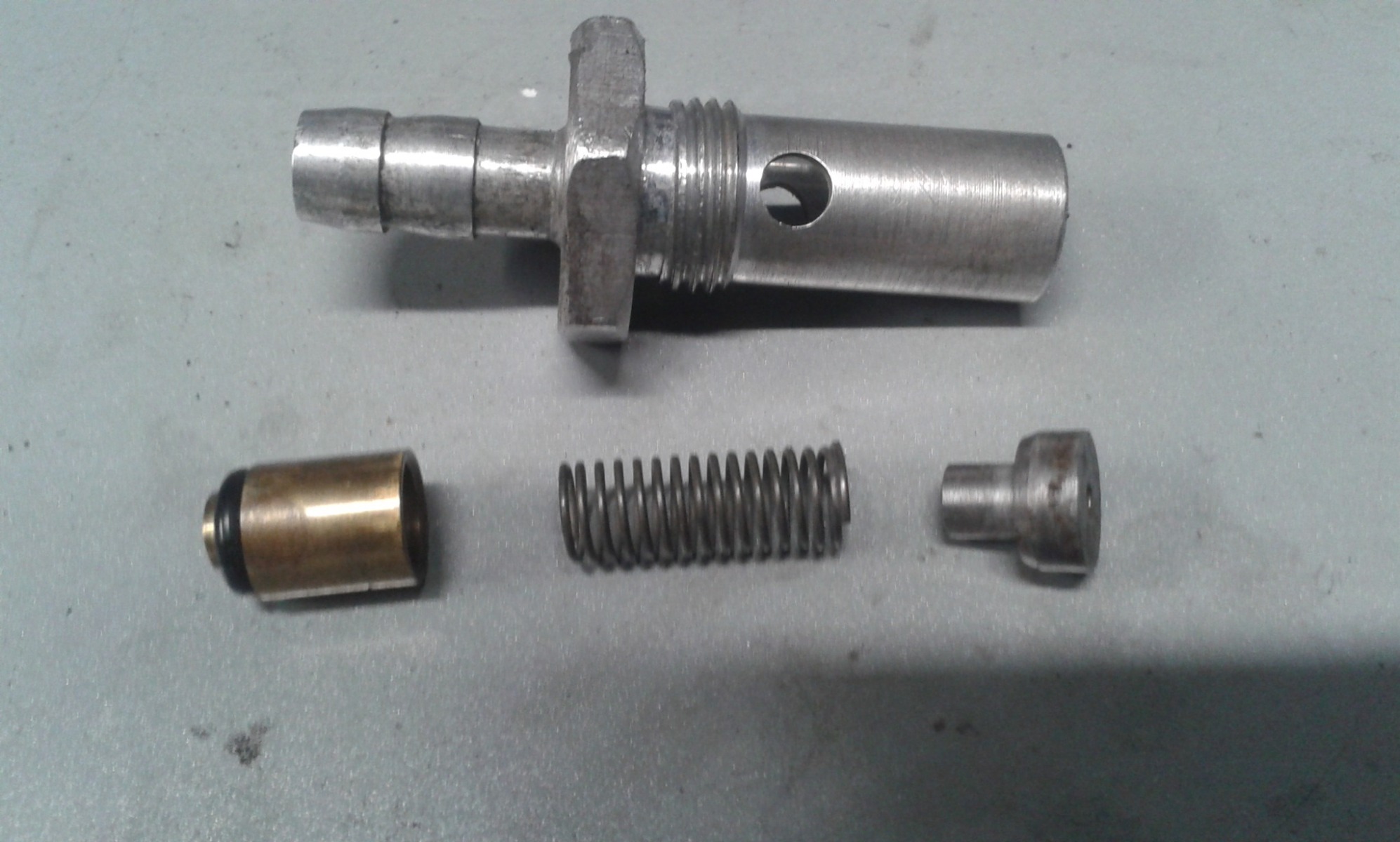

Have to ask, is this the check valve you are talking about???

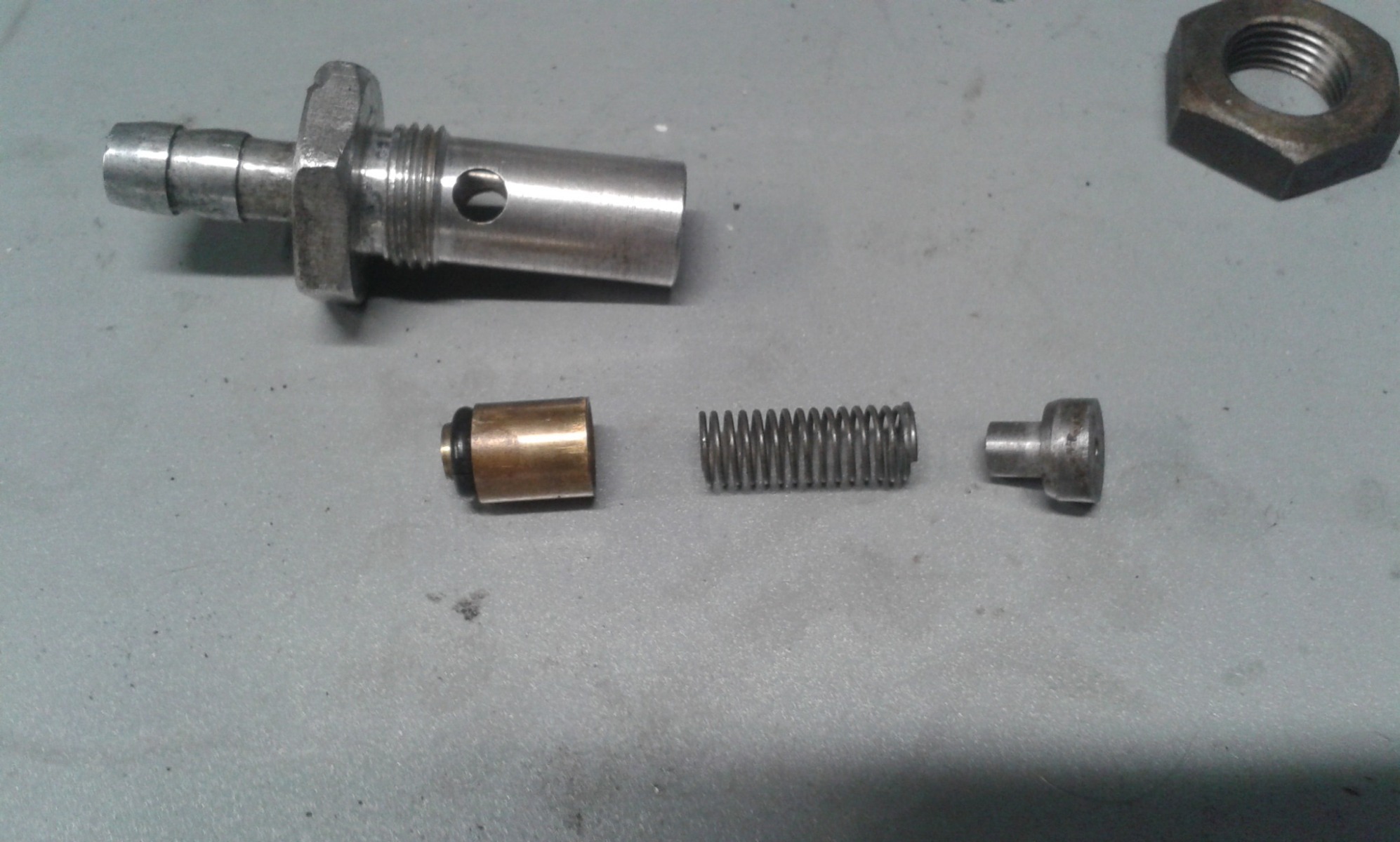

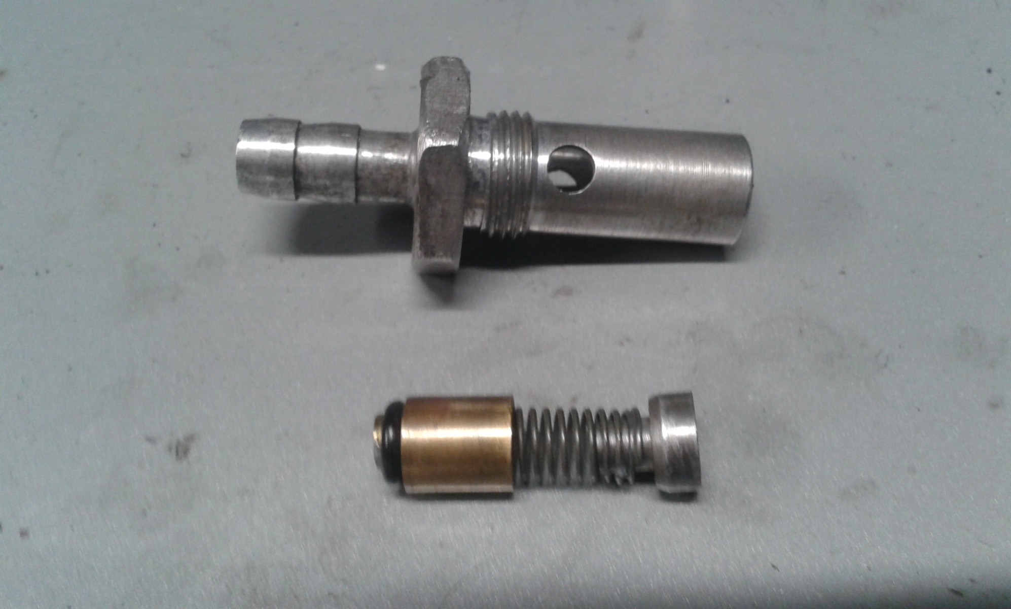

The check vale tend to be clogged with rust and then get stuck = not fuel will flow back into the fuel tank.
It can be disassemble with a drift punch if needed. Take pics tomorrow....
 Here are the pics. Use 5 or 6 mm drift punch to unlock the press fit plug.
