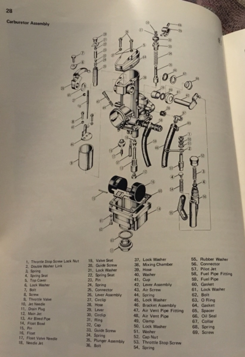

You need to remove the choke bar and lifters and then make a special wrench to undo the 14mm retaining nuts.
For all the messing and time it takes it's quicker to split the carb bank and use the opportunity to give the rest of the assembly a good going over.

Is there any other rubber seal on the choke plunger assys apart from on the tip (o ring inside the recess etc) ?
Also is there a rubber boot that sits over the top?
