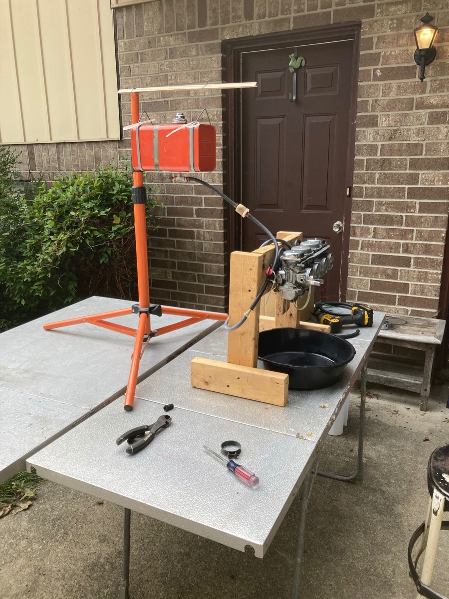

The float levels can cause all kinds of gremlins. This one had me going until I found the problem.

25 Jul 2022 18:35Float spec on Z1 VM28's is +/- 1mm. Don't know what it is on KZ1K's.hardrockminer post=870972I use the slmjim & Z1BEBE method described in a post in the carburetor section of this site. It's similar to elfarm's method, but you can do all four carbs with 4 glasses instead of one.
The tolerance in the manual is from memory....plus or minus a half mm.
Our experimental fuel level test rig so you don't have to search for it:
www.kzrider.com/forum/3-carburetor/61368...n-setting-fuel-level
