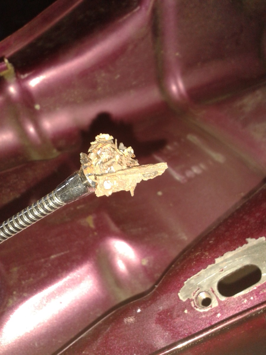

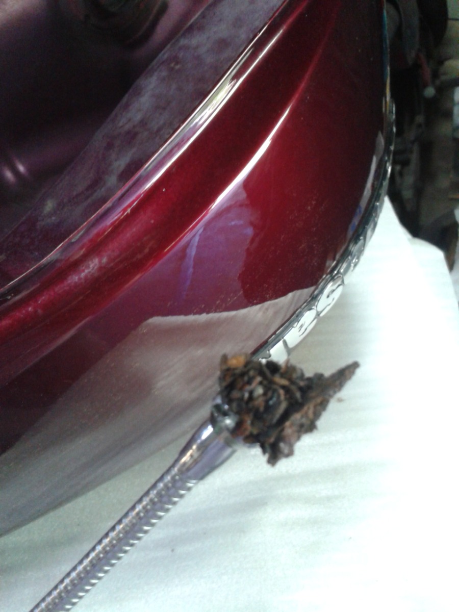

The Zephyr 750 carb main jets (88-92-92-88) are too lean for the modern E5/E10 fuel !!!
Long story short, changing the main jets to 102-106-106-102 will un-chain more torque and top end power and better idle.
Don´t ask how i know it, the long story started with a fuel tank full of rusty chips!
