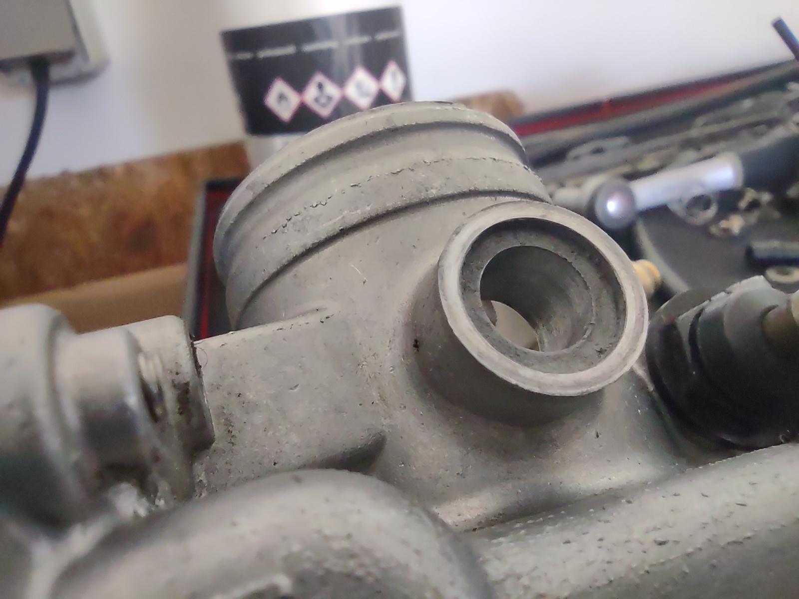

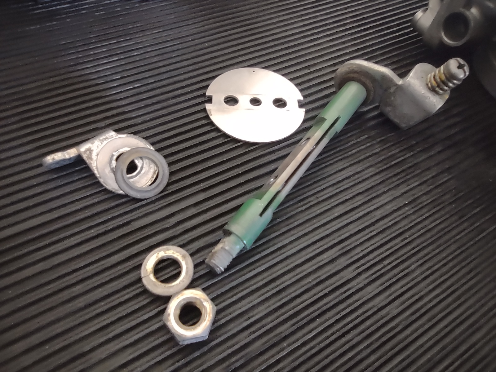

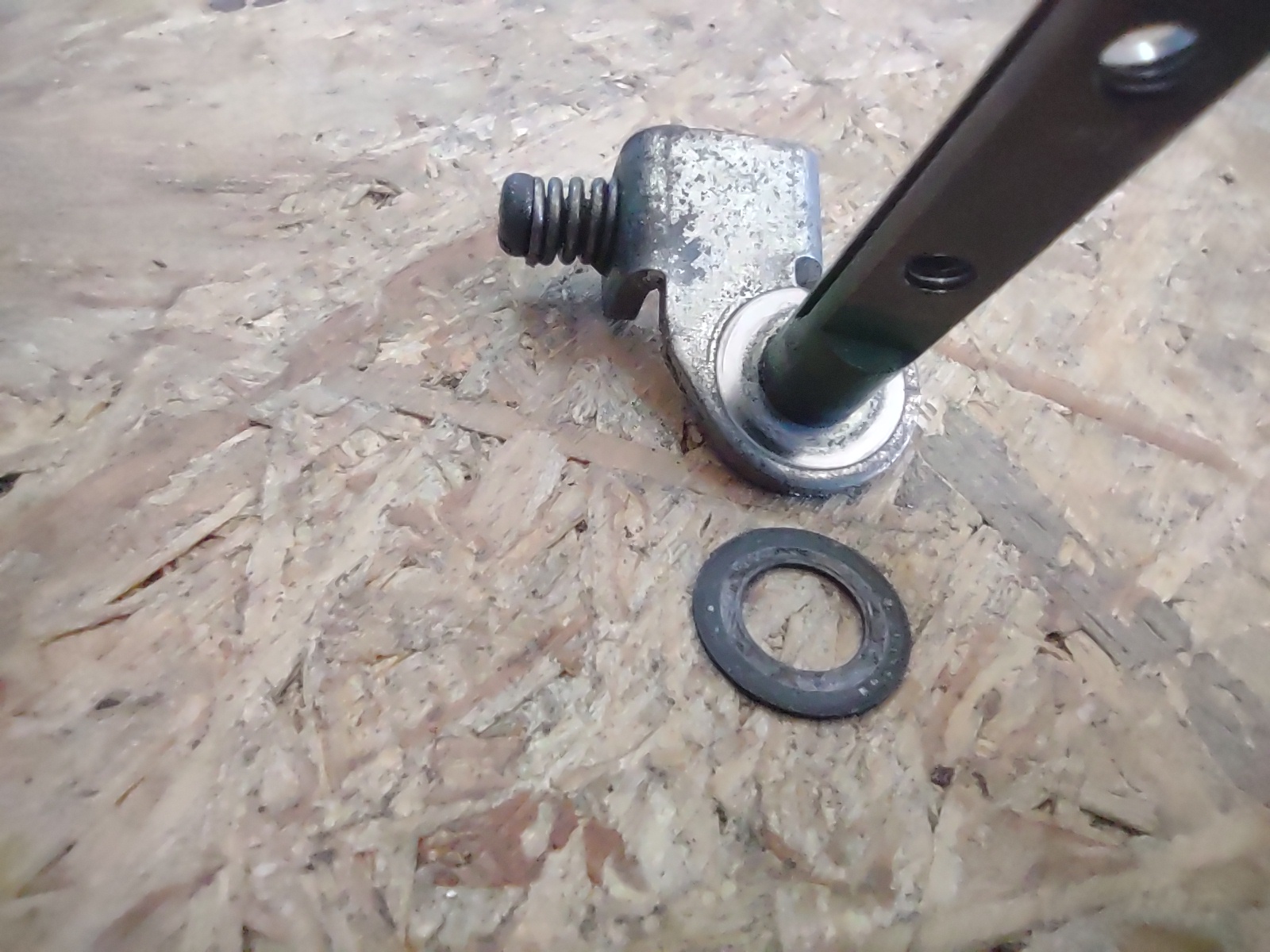

Finally got the carbs pulled and seperated. They have a single nylon wassher on the outside carbs, the outside of 2 & 3 have a nylon washer with a shoulder for the carb body, and the inside has a single felt washer. They have never been pulled apart so this mus be the stock setup. I'm thinking felt washers all around , polishing the ends ot the throttle shafts so they seal better and some washers to replace they nylon ones - what shoul I use here? Stick with nylon, or brass, or ...?

Personally I would stick with nylon (the manufacturer chose that material for a reason)
