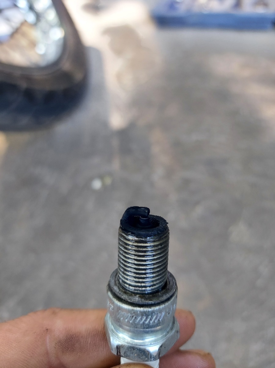

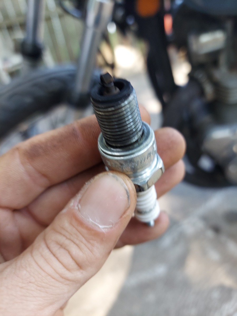

Spark plugs didn't look great, so i put a fresher set in for the continued testing. Plugs I pulled out .....

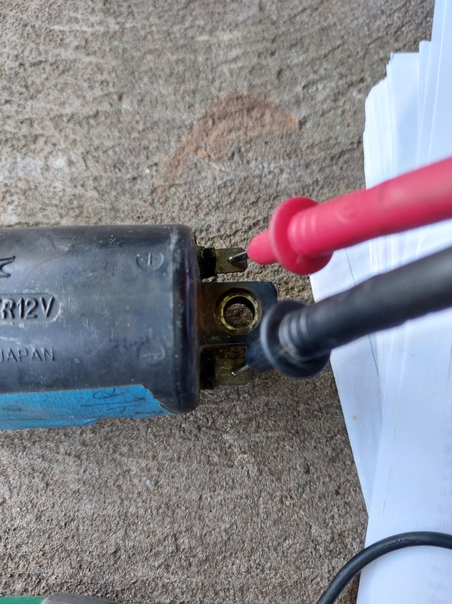

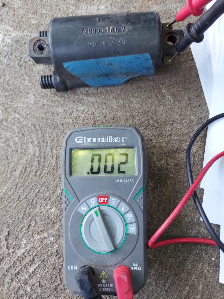

I then moved onto testing the coil per my sevice manual. The manual says to set my meter to rx100 for the primary but my meter only goes to 2k ohm. When I tested that I got .002 for my range

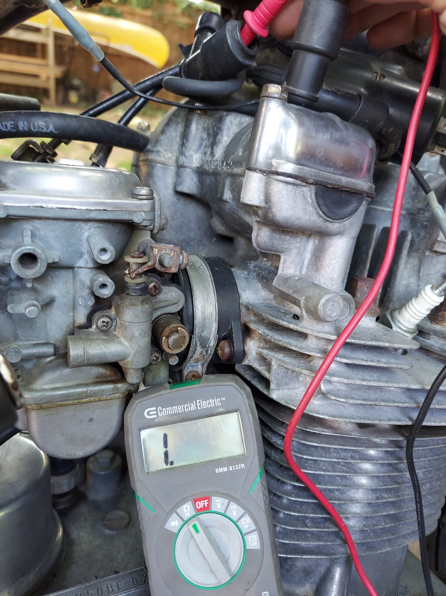

I then tested across the secondary using the plug leads and my reader didn't seem to show anything.....

Your primary reading is 2 Ohms ( it's on the 2k scale so you need to move the decimal point) as the meter only has a 2k scale it can't measure he secondary at 10k

Awesome, thank you for clearing that up, I will look for another meter for the secondary, I was getting between .003 and .004 after I checked again, so I'll assume that's OK now that I understand the meter better
