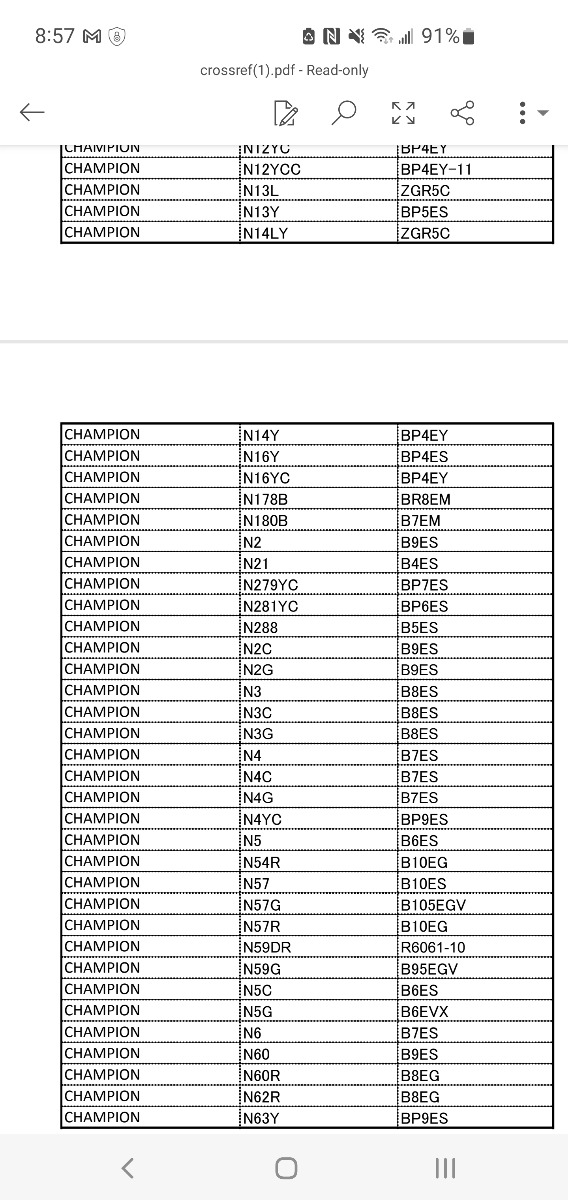

I am running champion n4c spark plugs, they cross reference to a ngk b6es. I have pulled them and they look good in my opinion, but I pull them in the morning and post a few pics for opinions

It may be closer to a B7ES which is still one step hotter than a stock B8.
As long as you can keep the plug clean from carbon without getting it too hot you will be good.
The chart below is from NGK's Australian site.
