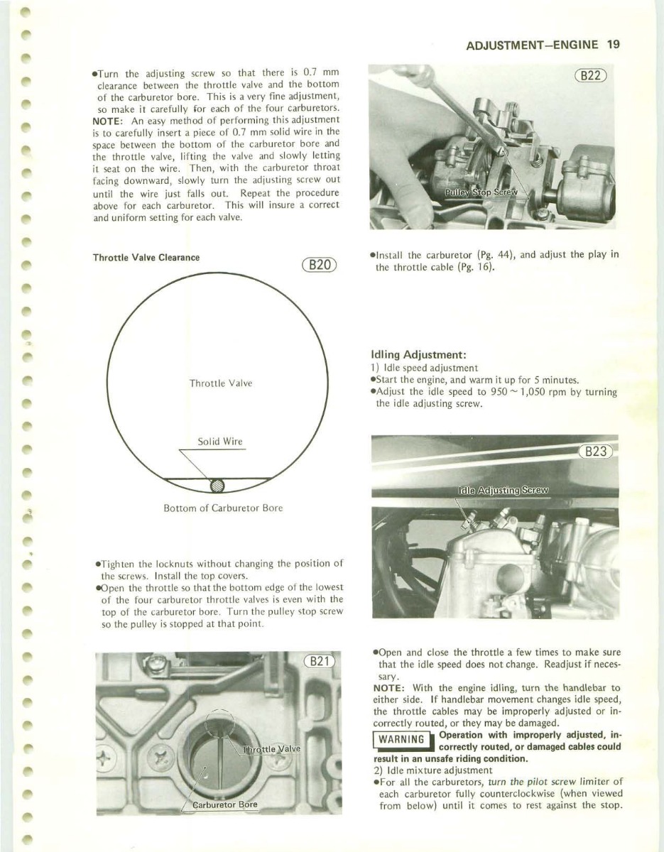

It's called bench sync. I use a piece of irrigation wire under the slide and make them all the same. Some carbs have a 'lead" carb that is fixed so you adjust that one using the idle stop screw then adjust the rest to match.

Thanks for the answer. You wouldnt happen to know the diameter of the irrigation wire would you?

I just eyeball the slides to get them close. Open about 1/8" open is about right for the first start. Then do a vacuum sync on the bike, and of course set the throttle stop for a nice idle.

I think it's 22 gauge. Just regular irrigation wire. The idea is to get them close then sync them or not. Jeff Z1E says he just bench syncs his with a higher idle. The smaller fours need vacuum sync or they'll rattle like hell at idle.

Re: Slide Valve starting point on carburetor
17 Jun 2022 01:31Steve
The following user(s) said Thank You: SWest, Rick72
17 Jun 2022 20:14
22 AWG is about 0.645 mm.
