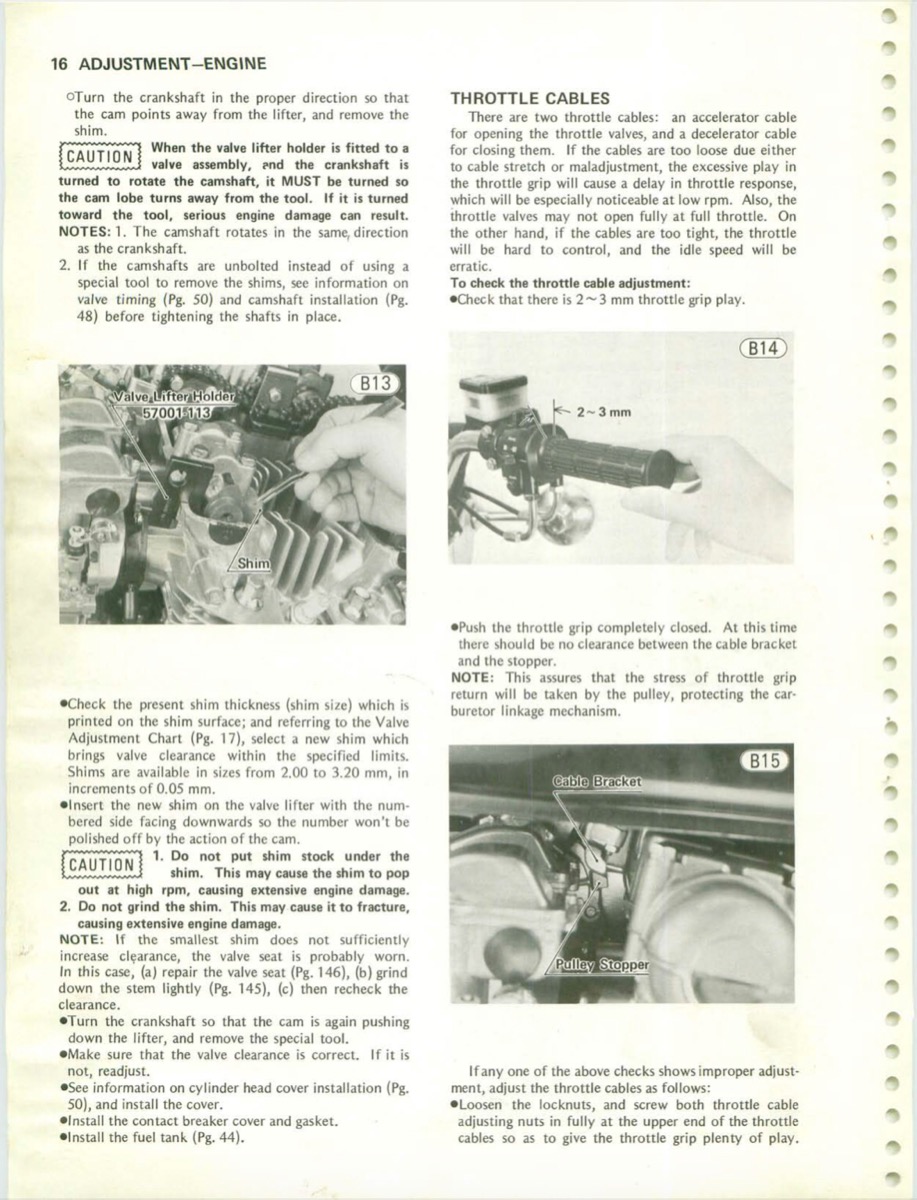

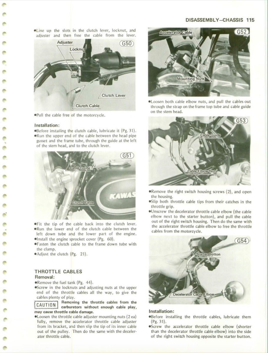

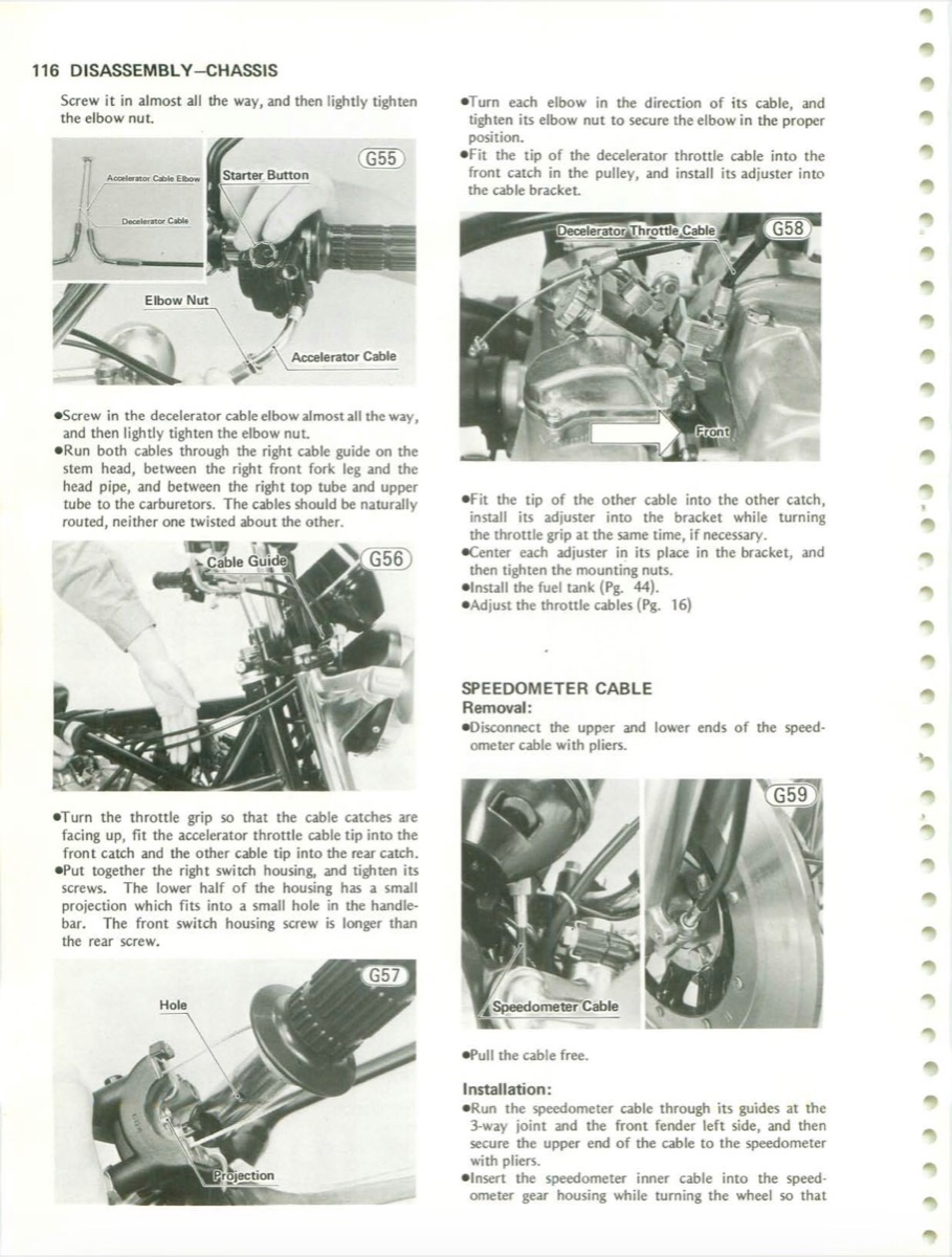

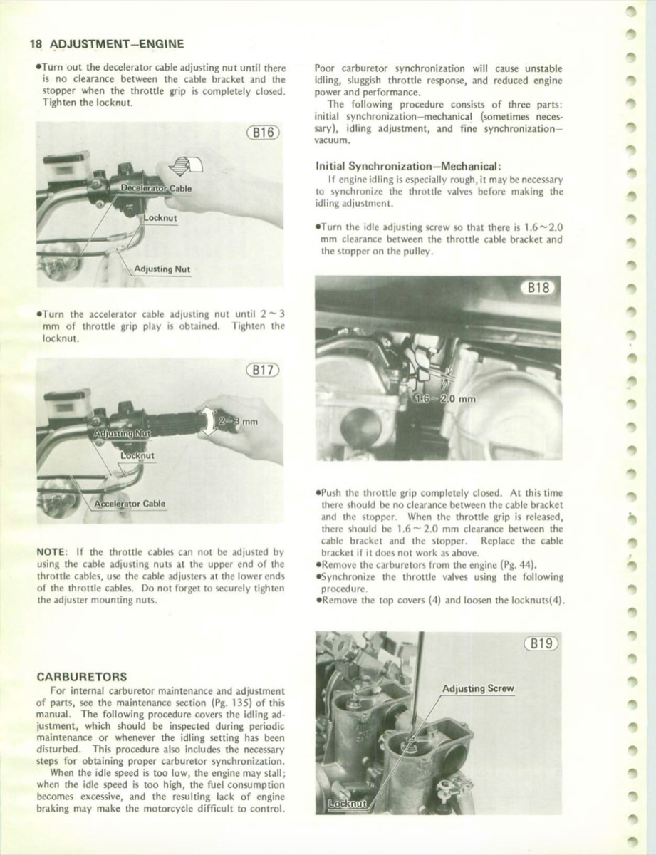

Re: Push and Pull Cables
02 Jun 2022 07:50 - 02 Jun 2022 07:51
Last edit: 02 Jun 2022 07:51 by Mikaw.

To adjust, loosen both cables, adjust the pull cable so you have slight freeplay, then tighten the push cable just until the throttle feel gets a little slower and back it off a turn or two.

Lets be clear here... both cables are designed to "pull". "pushing" is not the modus intended. Set the "free play" between open/close cables at about 3mm (1/8in).
