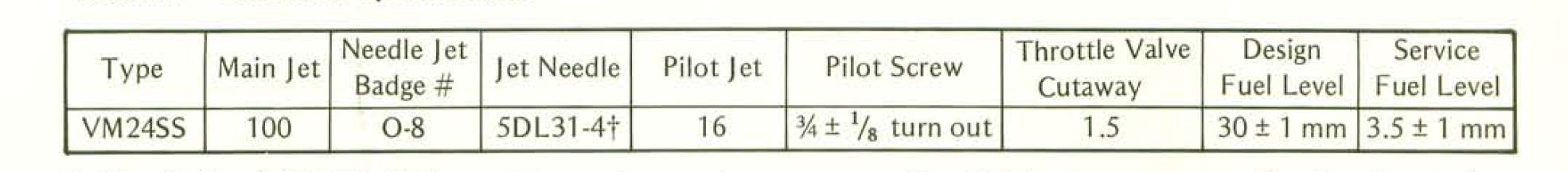

I recently swapped carbs on a kz650 from the VM22 to VM24. big improvement in fueling but it was getting this weird surging cruising at highway speeds and also during off-idle acceleration. I changed the pilot from #15 to #17.5 and the surging went away and overall performance was improved except now it is too rich at idle and can be difficult to start compared to the #15 pilot. I was consulting the service manual and I saw that the original pilot jet size is listed as #16. which seems like it would be the perfect balance, however i cannot find this size of jet anywhere.

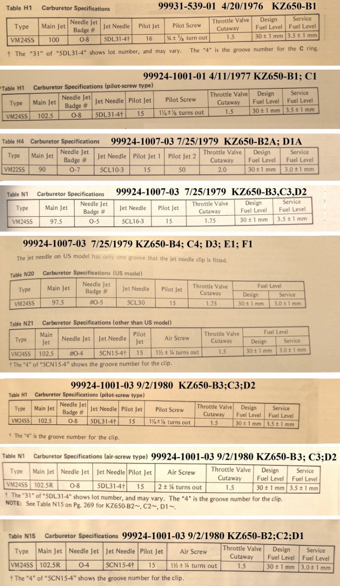

I think that those and 100 mains were for US emissions on 22's. In the uk the standard jets in 24's is 15's an 102.5's.
Bets are off if you have non stock exhaust and air supply.
Also as you have founds mikuni jets go up in 2.5's so 16 is a misprint or a special. Never seen any and I have striped plenty of US import 22's.

I have always thought that table in the B1 manual is a misprint, but I have no data to back it up other than other lists in later manuals, and the fact I have never seen a 16 pilot jet offered by Mikuni,

24 Apr 2022 05:30 - 24 Apr 2022 05:30When you are a big OEM like Kawasaki, Mikuni will customize jets for them. Like the 2.3 float valves used on the big bikes. That said, I suspect you are correct in that the 16 is a typo. The parts fishe references #15 pilot jets.I have always thought that table in the B1 manual is a misprint, but I have no data to back it up other than other lists in later manuals, and the fact I have never seen a 16 pilot jet offered by Mikuni,

well back to #15s then. i will try raising the needle next.
