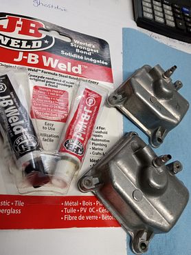

09 Mar 2022 14:37 - 09 Mar 2022 14:38Thanks for the tips.A 2K epoxy like JB Weld or LOCTITE® EA 3479 will seal the tubes.
Thinking of trying to seal them from below with JB Weld, as I have some.
Any tips working with and forming JB Weld around the bowls drain nipple?

Trying the JB Weld on the bottom around the nipples to see if I can seal the leaks:
Need drying for a day, then I will leak test them.
The bowls are off KeiHin CVK32 carbs.
I mistakingly called them Mikuni carbs in the opening post.
I have found 4 stock bowls on ebay and have those as back up if I truly screw these up.
