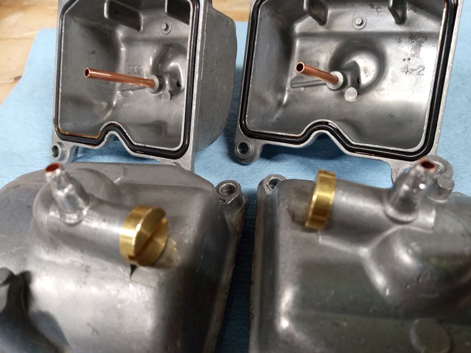

I have early Ninja 600 carbs on my kz650, Mikuni CVK32.
I've added overflow tubes to the bowls, but they are leaking.
I used a soldering gun and solder to seal the tubes, but 3 of the 4 are leaking.
I want to try to use a Propane torch to heat the solder up more to flow better into the cracks.
Am I at risk of damaging the float bowls.
What material/metal are the bowls made of?

08 Mar 2022 11:36 - 08 Mar 2022 13:26
Thanks for the replies.
I will keep them in mind if my fix fails.
I am soldering them in as it's been done before with success.
Didn't know about the different metals not being able to solder together.
Will find out how well this holds...
I spoke with a friend and he thought I should be fine using a Propane torch.
I found four bowls on ebay and bought them in case I screw up these.
I fastened a bowl to a piece of wood that already had a small hole to accept the overflow tube.
Held the wood in a vice, and slowly heated the bottom of the tube and bowl, keeping the tip of the blue flame (hottest spot) back from my work.
With a small sweeping action back and forth, not keeping the torch in one spot too long.
Working my way around the tube.
Not much was happening, so moved the flame closer.
This started to melt the solder, but not as much as I thought it would.
Kind of made a ball of the solder.
Didn't think it was working, but a leak test once it cooled showed no leaks.
Put a small piece of rag in the can so I could see any leaks easier.
A leak test on the second carb didn't turn out as well as gas poured out of the bowl.
I forgot to put the drain screw in the bowl.
Drain screw in and test, no leaks.
I did all four bowls, and each passed a leak test.

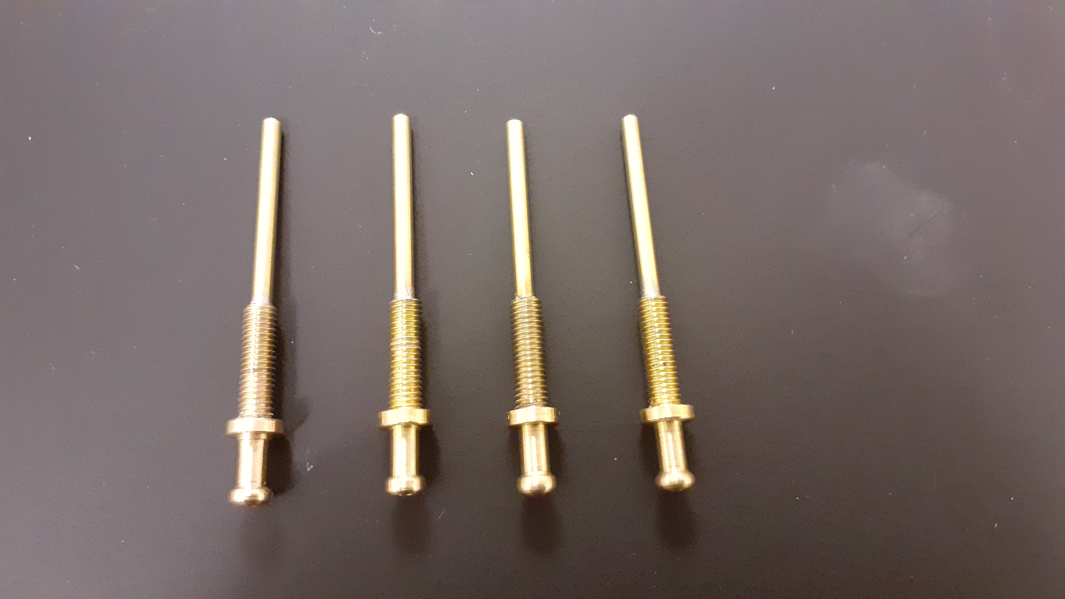

I did mine the same as Robs for my CVK34's. I found the procedure on the Concours owners web site. Mine use a different drain screw so my pipes do not exit the bottom, they are blind drilled to a depth of 1.5XOD then press fit in.
As for the top of the pipes being rounded, they do not mention that on the Concours site but did mention the pipe needed to be 8mm above the bowl mating surface. I measured a VM24 float bowl, it uses 4.5mm above the float bowl the pipe having .138" OD and the hole in the top is .058" ID.
I cut my .125" OD pipe (.014" wall) with a small tubing cutter which puts a healthy chamfer on the tube pinching it slightly so the hole is about .090" ID. With the pipe sitting higher and the tubing being smaller OD I figured it did not need the end to be rounded.
Since I press fit the pipes in I would need to remove them to put that round feature on the top and would probably dame them trying to get them out of there.
If leaking on a lean becomes a issue I will pinch the tube ends closed parallel to the lean angle.
The next time I do some I will probably take the time to close up the ends.
