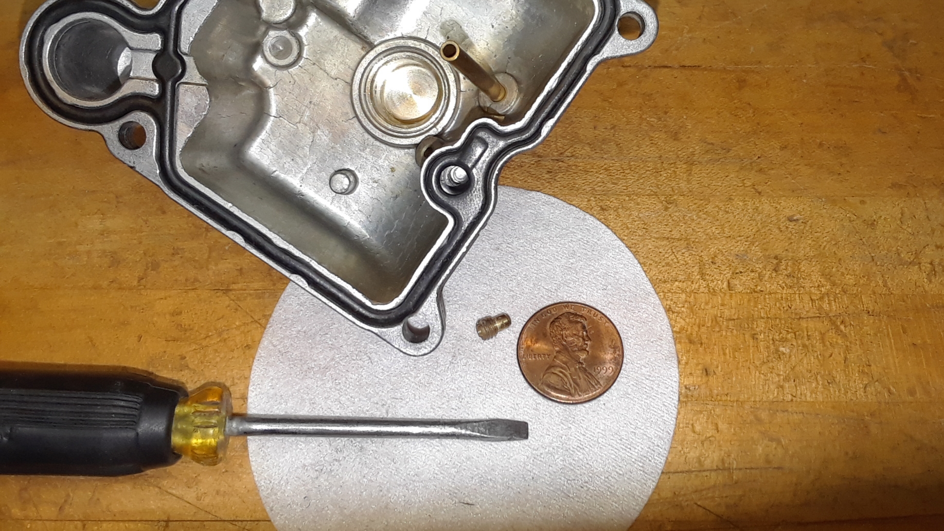

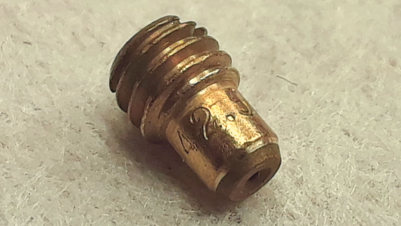

18 Dec 2021 10:43 - 19 Dec 2021 09:28Looks like #58 on the exploded parts view. They range from #15 to #100... sort of weird sizing steps.
I bought my RS34's used from a friend who bought them new, so those jets were never changed, they are #42.5 in the RS34.
Are you having cold start issues? I have had no issues with starting those on my KZ650 with 831cc motor.
PS - Disabled the accelerator pump system and removed the fuel pipes between the bowls. #120 main jet with #20 pilots.
Do the carbs function well for you with the accelerator pump system disabled and blocked off?
While disabled it has worked great for me, but I just gotta try that system again with the upgraded cylinder head...
My current carb jetting seems ideal for cool 40-55F temps: #25 Pilots, .08/.09 Pilot Air, 125 Mains, Jet Needle lowered (clip in 2nd slot).
I will likely try the Starter Jet #60. The engine acts like it wants more fuel with the 42.5 size.
After struggling to start, the engine stumbles badly with the plunger knob fully out. With the knob held halfway the rpms increase and the stumbling ceases, but the plungers close and the engine dies when I let it go.

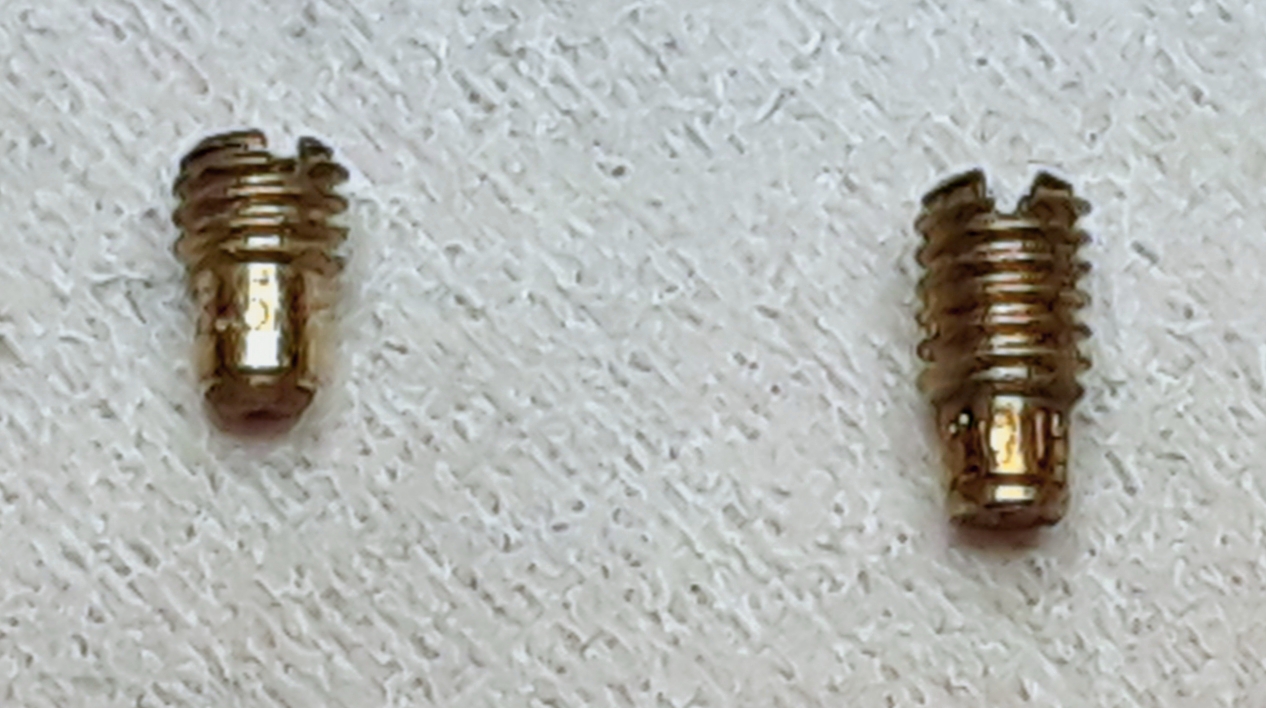

RS series Starter Jet
Size relationship: Starter Jet Left, Pilot Air Jet Right
