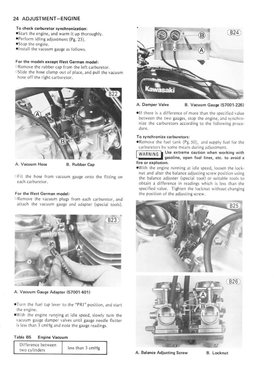

#856322
  • Scirocco

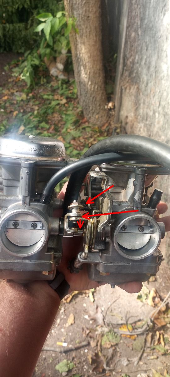

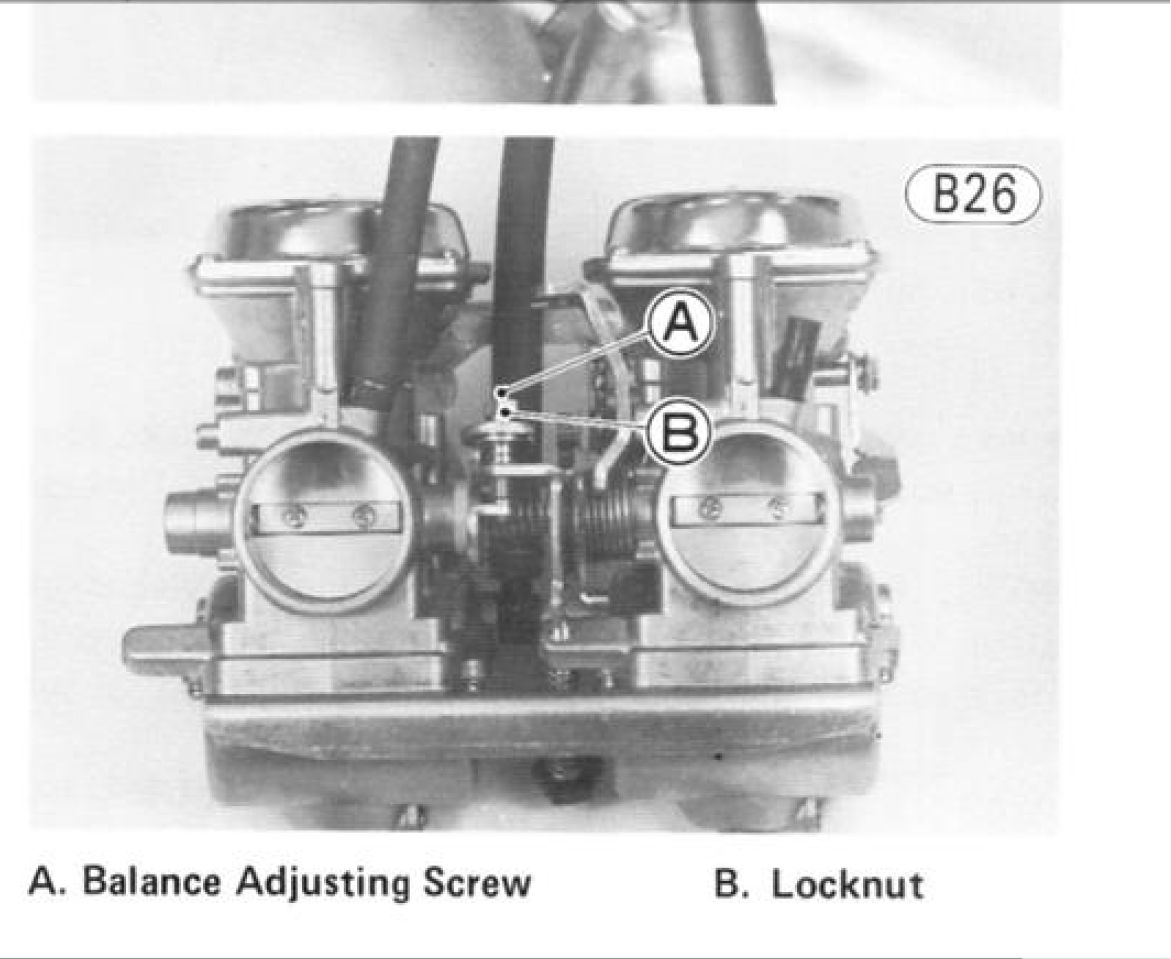

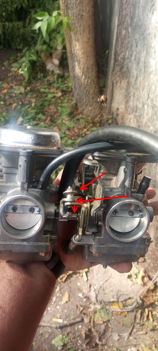

Re: Extremely high rpms on start.
07 Oct 2021 12:37 - 07 Oct 2021 12:39
#856324
Your LH carb is a way out of sync and your sync adjustment need a fix. The washer and spring belongs under the butterfly accutator of the RH carb tab. Washer on top of the spring.
Last edit: 07 Oct 2021 12:39 by Scirocco.
The following user(s) said Thank You: Nessism, Qsmothers3
  • Qsmothers3
  • Qsmothers3's Avatar Topic Author
  • Posts: 78
  • Thanks: 1
07 Oct 2021 12:41
#856325
I didn't even notice that. Thank you! This probably won't fix the issue but never the less it needs to be fixed.
