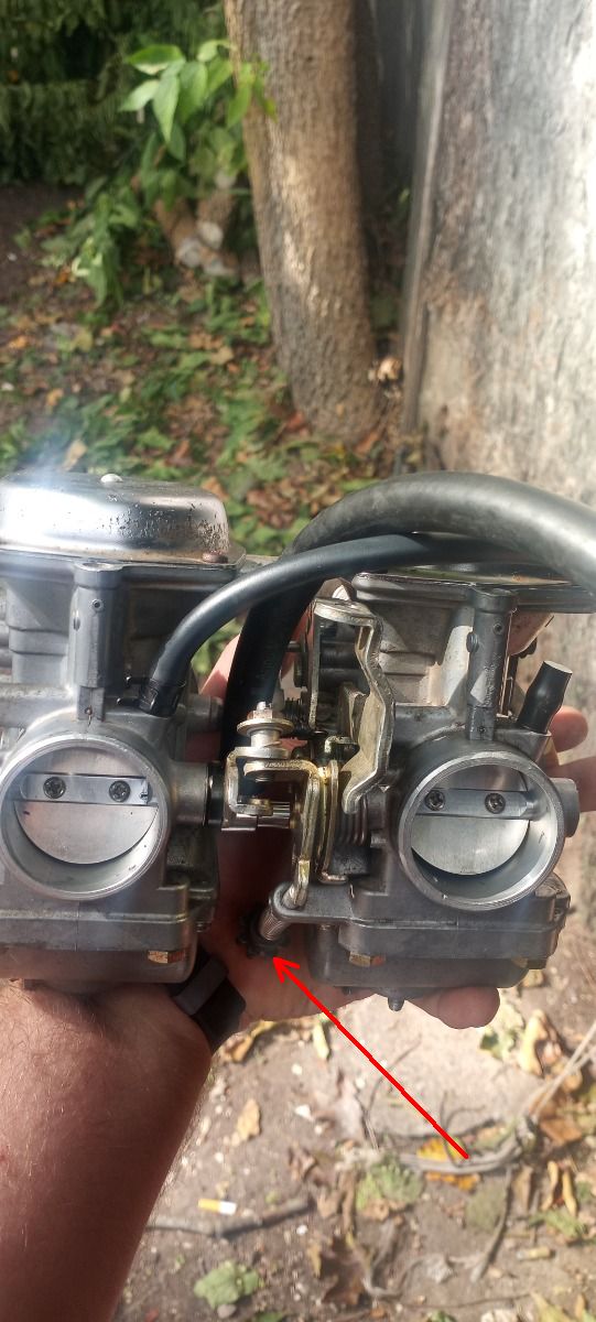

Did you sync the the carb butterflys by service manual?
Are both butterflys fully closed? a pic would help

Just to follow up on what Scirocco said, can you actually get to a point with the carbs on the bike where you can see the butterfly valves? If so, what position are they in? Open or closed? If open, how much are they open? From a personal standpoint, I have never seen a vacum leak cause a 3,000 RPM jump in engine speed, let alone a 6,000 RPM jump. Not unless you are feeding jet fuel into the vacum leak. Something else is going on with your carbs and I believe you need to go back to square #1 and bench syncing them. Then install and adjust. Just my humble opinion.

Update!! I took the carbs off, bench synced them and low and behold the ol girl fired right up! Idle is at a cool 1100 rpm! Took it out for a spin and it has great throttle response all around a smooth ride! Need to get some new tires and I think she's ready to hit the road!! Thank you all for your help!!
