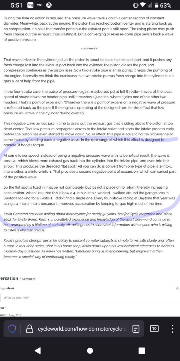

Not sure if this is causing any issues as the bike seems to have a few mods going on.
I'll just throw this out there. 4 into 1 headers can cause a flat spot in your torque curve.
www.cycleworld.com/how-do-motorcycle-exhaust-pipes-work/

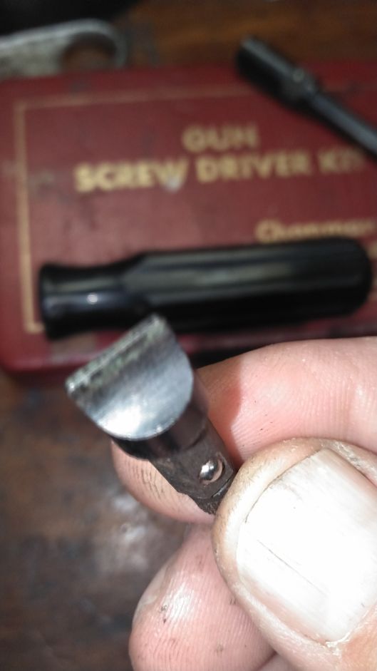

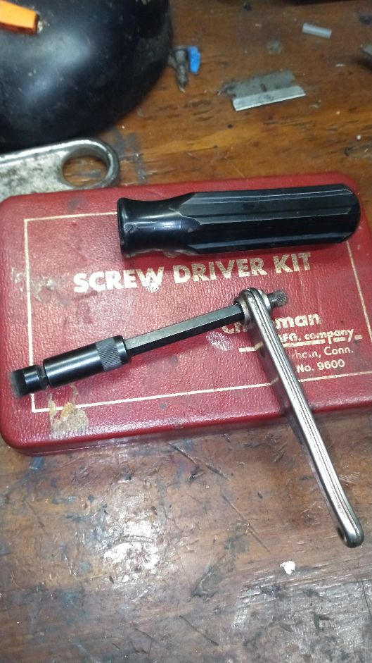

02 Oct 2021 07:13I used a hollow ground bit from my Chapman gun screwdriver set...#98. The ratchet handle helps greatly but I tried one with the regular screwdriver handle and was able to get it loose. The screwdriver set has mostly bits for slotted screws...the 2 small Phillips are not JIS. You can get individual bits from Chapman for abut a buck-fitty each3.5 turns open is pretty much the limit. Opening more doesn't provide more fuel.Yes I synched the carbs...got them just about spot-on. I forgot to mention that. I started with the pilot screws out 2 1/2. I took them out another turn and it seemed a little happier. Think I should take them out a bit more?How many turns open are the pilot screws? And did you vacuum sync the carbs?
