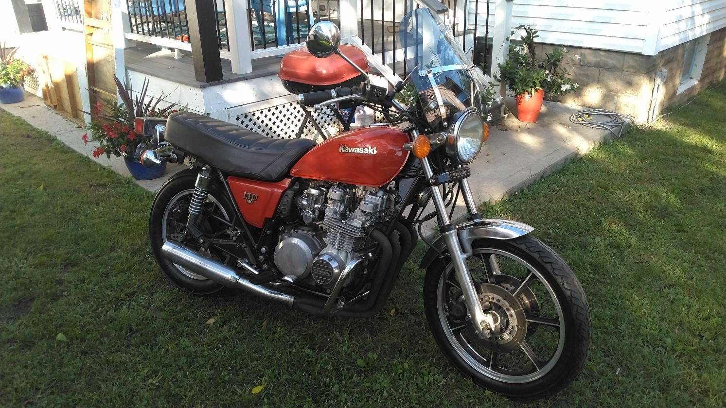

KZ750 LTD...Keihin CV34 carbs. I got my project bike running and rideable. Only one issue...it doesn't like to be held steady between 2--3K RPM. If you accelerate it pulls right through the range and you never notice it. The seat of my pants is telling me it's lean in that range. Here's what I have done so far: Carbs are clean, all jets cleaned out. New manifold boots. Ignition advance is free and working. Valves are in adjustment (had to change one shim). I'm running the factory airbox but the bike has a Mac 4-1 header. All jets are stock except for the secondary main. Stock is 125, mine has a 136 installed. I was thinking I'd get shims from Z1 and raise the needles...think that would help or should I change jets?...if so, which ones? I really don't want to pull the carbs again until after the riding season. Thanks in advance ----bob
