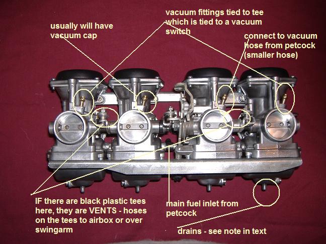

Ahh I understand. I decided to go with the factory air box. I’ll just have to plastic weld the top back on until I get the replacement. I should be done rebuilding the carbs soon so I’ll get to test fire the engine. One question I have for you all, does anyone have a vacuum diagram for the barbs underneath the carb? I apologize, the previous owners took it off and I believe discarded it. Airbox boots have been purchased so now we wait.

If you are asking about the bowl vents, they need to be left open to atmosphere. They usually have hoses attached that drape over the frame cross member just in front of the swing arm pivot.

Re: New 81 kz750H LTD
18 Jul 2021 23:01
Do you have a picture of what it is supposed to look like?

Sorry, I do not have any pictures. There are a couple of decent shots in the factory service manual, but sadly the pdf copy here at KZR is a bit low res, and the pictures are hard to see. If your bike has the Keihin CV 34 carbs, I believe they have an overflow nipple on the very bottom of each bowl. These must be left open to atmosphere and it would be best to have hoses attached to them that drape over the trans and dump in front of the swingarm pivot. Hopefully one if the 750 folk will be along soon with some pictures.
In the mean time, I suggest taking a look at the carburetor sections in the fsm to get a better idea of what the various nipples do and to get a handle on the correct names for each. I think the main section starts at around page 150. Using a common nomenclature makes long distance diagnosis and recommendations easier.
