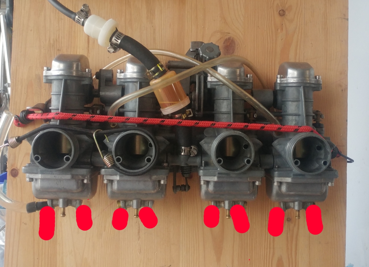

Checked out the site and could not find an exact answer so i apologize if this has been asked and answered.
As everyone else who asks a carb related question this started after rebuilding and replacing gaskets and jets etc.
The bike runs great but over night or even after a few hours i see fuel slowly dripping from each of the carb bowls.

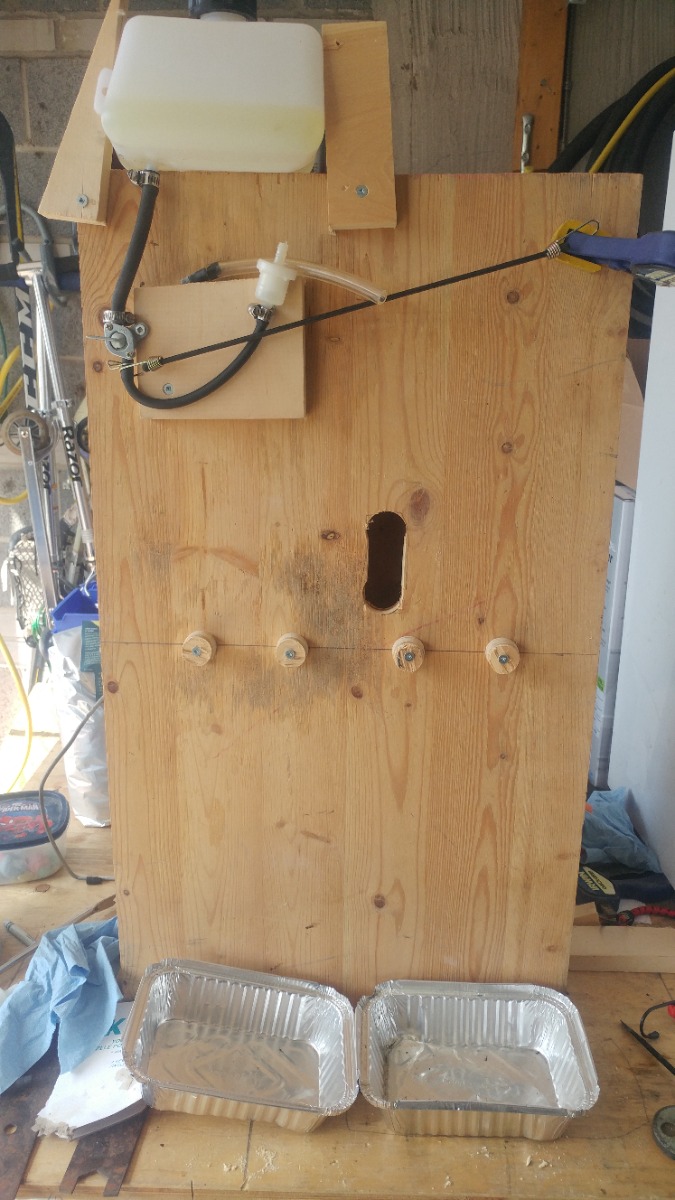

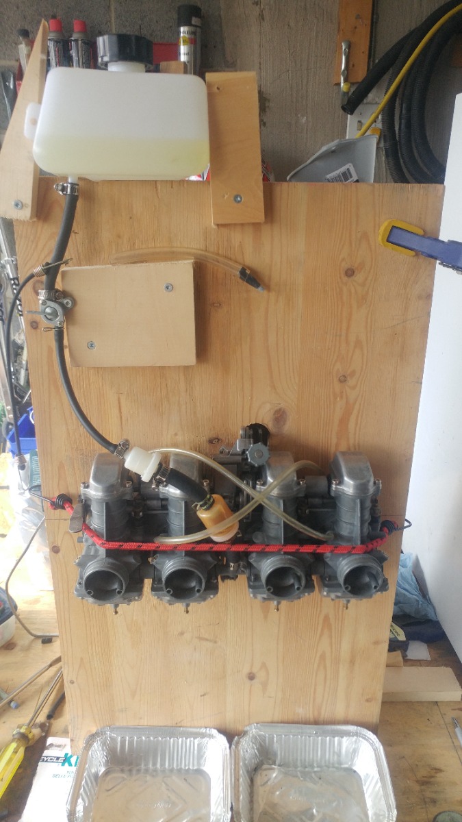

Think I had set the float heights incorrectly i developed a bench test board and level tool and reset the heights to within specs. I replaced the float plugs with ones from another set of carbs i have and new gaskets.
I put the carbs back on the bike and no leak after a few hours so i let it sit over night and sure enough a slow leak again. Now it's less then before but still present.
Need some suggestions as I'm at me frustration limit.
Red dots represent the location where I see the fuel dripping

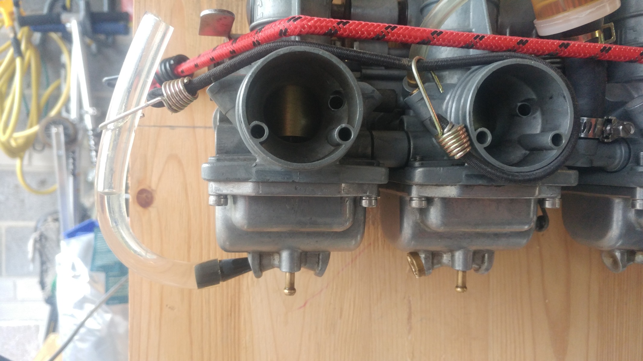

leveled front/back side to side

Rig without carbs

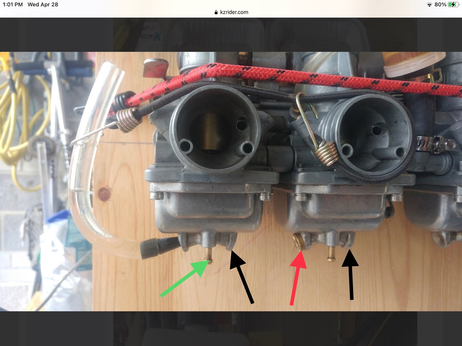

See photo.
It’s impossible to have a leak at the Black Arrow. If you have a leak at Red Arrow, your missing an O-Ring on the bowl screw. A leak at the Green Arrow points toward float needle and seat not sealing.

You may have fuel leak at Red Arrows that could run down the sides of the bowls and drip off the Area at the Red and Black Arrows in the first photo.

This maybe doesn’t apply to your problem but could be something for you (and others that have gas leaks) to think about. I had a nagging leak on a nice set of great running carbs. No matter what I did gas kept coming from the bottom of the bowls. The overflows. After a couple of weeks I finally figured it out. The overflow pipe had corroded where it passes through the bowl. Gas was leaking through the hole in the pipe and exiting the overflow making it look like the bowl had too much gas. A new bowl and the leak was no more. Good luck.

Have you left it all set up on your test fixture for a few hours? When a carburetor starts leaking, is the fuel level in the clear tube above the correct level?

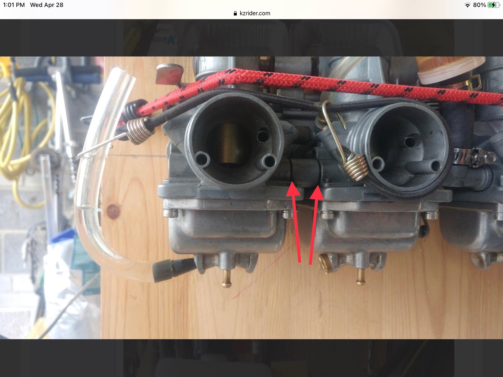

29 Apr 2021 15:38 - 29 Apr 2021 15:47It's possible that there is a slow leak in the crossovers. I didn't replace those seals as they seemed to be fine.

29 Apr 2021 15:49I did and the the level stayed solid leading me to believe the the float and float needle valves were doing their jobs. Needles were from a reputable source however I am not sure at the moment which brand.Have you left it all set up on your test fixture for a few hours? When a carburetor starts leaking, is the fuel level in the clear tube above the correct level?

29 Apr 2021 15:50 - 29 Apr 2021 15:52The seals are dryed out but swollen up with the use of fuel penetraion. If not a short pice of shrink tube give you more pressue to seal the fuel connection. This is my personal hack to seal the fuel-T to the carb joint.....

29 Apr 2021 15:50Thank you for the suggestion but the overflows are crystal clearThis maybe doesn’t apply to your problem but could be something for you (and others that have gas leaks) to think about. I had a nagging leak on a nice set of great running carbs. No matter what I did gas kept coming from the bottom of the bowls. The overflows. After a couple of weeks I finally figured it out. The overflow pipe had corroded where it passes through the bowl. Gas was leaking through the hole in the pipe and exiting the overflow making it look like the bowl had too much gas. A new bowl and the leak was no more. Good luck.
