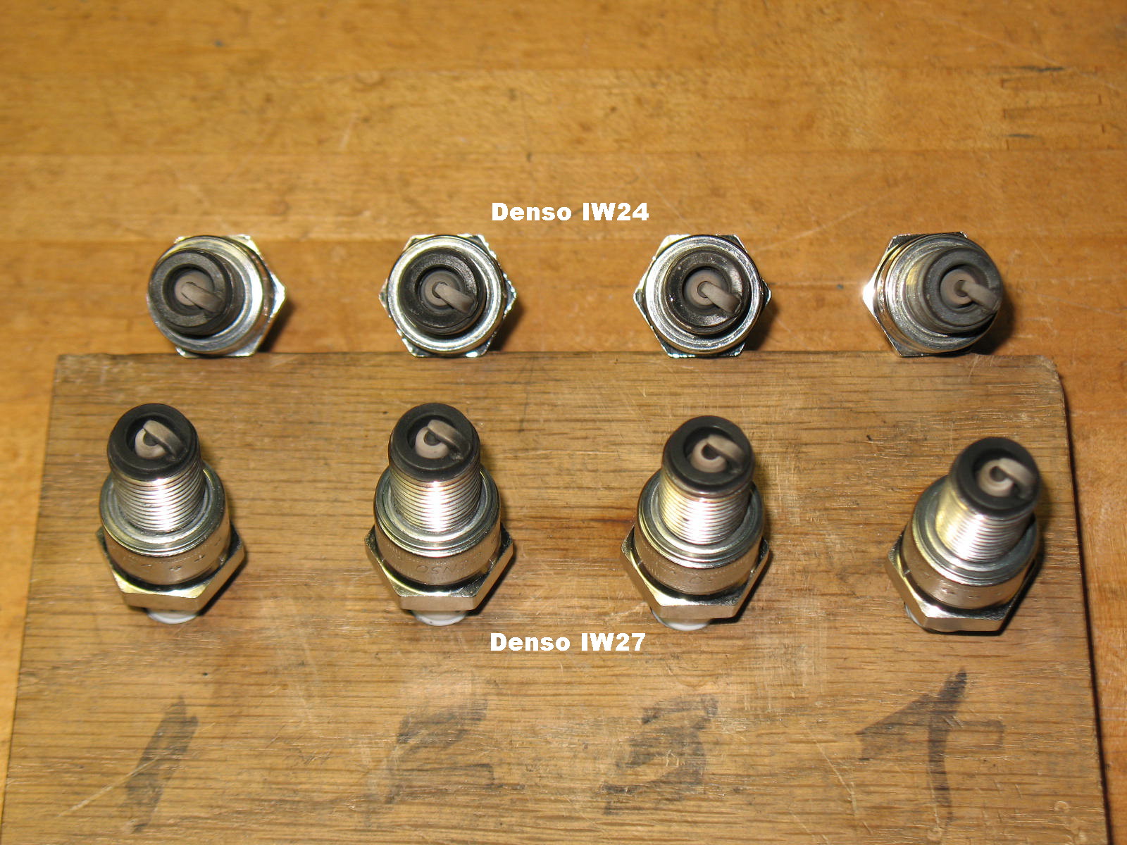

These spark plugs have a couple hundred miles on them since changing Pilot Fuel Jets from 22.5 to 25 in my RS34's. I have 27.5 ordered to try with 1.0 Air Jets (one-step leaner), but she runs better than ever at this point, so that may just be a waste of effort.
I hooked up the Morgan Carb Tune Sync tool, and found 1 & 4 off a little. After tweaking slide adjustments for at least a half hour, I seem to have discovered the illusive sweetest spot. It ended up being a tedious-fussy process, since slightly-off wasn't going to cut it this time. It takes only a slight mis-adjustment to throw the balance out of whack.

From what I know about reading plugs, your mixtures look good. I see your plug heat range is to hot. There should be a color change on the earth strap from grayish to dark just before the strap starts it’s bend. Your plugs show no color change at all.

Looks a touch lean to me.

06 Apr 2021 06:13THIS ...^^^^^^^^^Mikaw post=846196From what I know about reading plugs, your mixtures look good. I see your plug heat range is to hot. There should be a color change on the earth strap from grayish to dark just before the strap starts it’s bend. Your plugs show no color change at all.
www.dragstuff.com/techarticles/how-to-read-plugs.html
Base ring is mixture .Full turn of light soot is fine.
Earth strap is heat range and should be clean from the bend.
Clean down to the weld show a little hot so go colder on the plug.

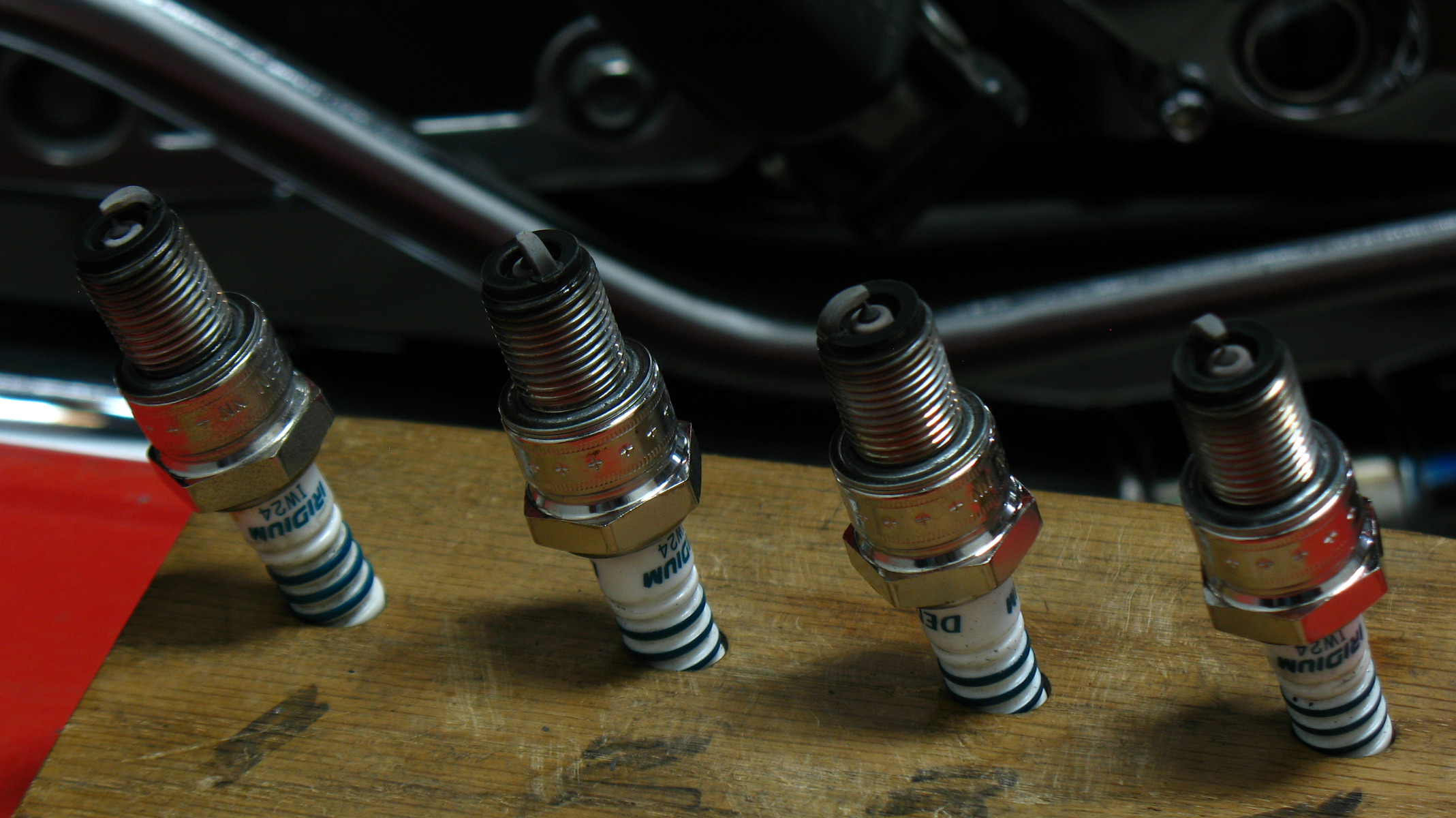

BTW, what is the Denso plug number for the next cooler plug of this type, and would richening the fuel mixture and/or changing the plug gap do the job?
Spark plug gap is .78 mm. FSM spec is .7 to .8
The ignition is operating with Dynatek copper-core plug wires and NGK non-res caps. The 2000 module set on #5
Another pic without the flash:

They still look on the hot side..
Denso IW27 is the next coolest ( NGK 9 equivalent) which is what i run in some of mine.

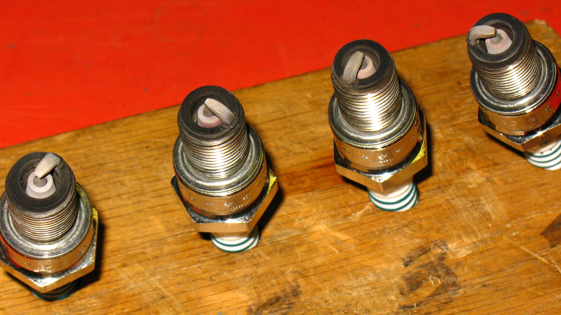

I ran one tank of Mid-Grade E10 gasoline with the new plugs, which produced excessive carbon which was removed with a fine wire brush. After that was Regular E10.
Denso IW27 spark plugs (bottom row) after 330 miles:
1982 KZ1100-A2 Sleeper 😎
Re: Spark Plug Color Check
25 Apr 2021 16:48
The IW27’s on regular gas Look like a sweet spot.
