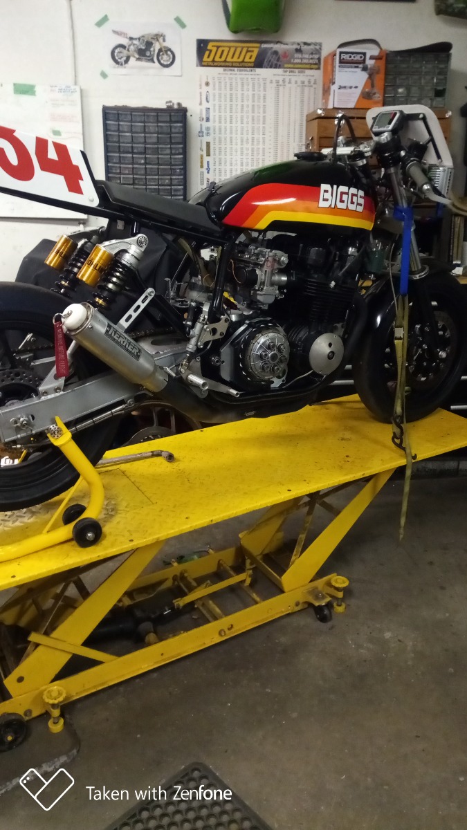

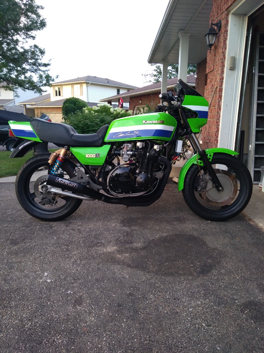

Hi I've used CRs extensively
They are super easy to work with
And yes they always come rich
From the factory,I've only used 33s on my kz1000,gpz1100 and gpz 750
But 29s should be not far off
Your settings are all were you need to start
Start with clean plugs ,make sure your choke is fully closed on all 4 plungers
If you use the choke , get off of it as soon as it's running,
Air screw should be 1/2 turn from closed even though they recommend 1 1/4 out
Put a temperature gun to the header pipes to make sure they are all running the same
Within reason
Bleep the throttle to about 4000
And whatch the tach
Should go up fast and drop just as fast back to around 1100 or where you like your idle set
If it hangs up and comes back slow you must turn your air screw clockwise 1/8 increments to richen it up
If you bleep it and it goes up fast then drops below your set idle then slowly rises to the set 1100
It's too rich turn it out counter clockwise
1/8 increments until it sounds angry
There is no sense in looking at anything else until that can be achieved
I hope that a start

That tank looks familiar on the 750! Hmmmm.

You got me Dave!
