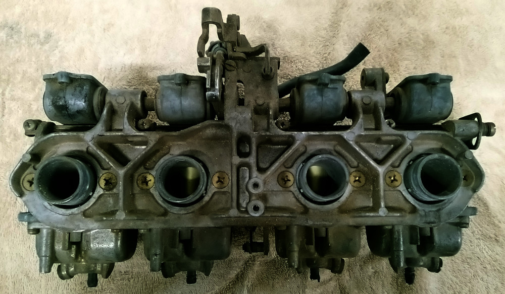

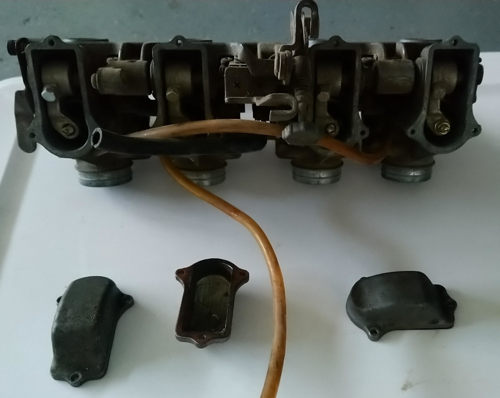

Hi all- I'm trying to buy a carb rebuild kit for the KZ650 I am starting work on, and I'm confusing myself reading through information here and in other places. Are there different carbs for different submodels of the KZ650?
Here's a crappy and probably unhelpful pic I took of my carbs to show my friend that I was missing a carb top:
If there's a better pic I can take (of a number on it somewhere possibly?) let me know and I can provide that! Thanks in advance for any help!

Re: Identifying which KZ650 carburetor I have?
22 Oct 2020 00:34 - 22 Oct 2020 00:39
Vm22 and vm24 on early models. It looks like either of those from your pic. Vm22 has a extra port at about the 10 oclock position in the carb mouth.
If its only the mix chamber cap that is missing, vm22, vm24, vm 26 all use the same cap so are interchangable.
22 Oct 2020 01:38
Can't add anything to the info Warren provided except the 3 screw carb tops from all the VM slide cards on Z650, Z900 and Z1000 22, 24, 26 and 28mm are the same and will fit.
22 Oct 2020 06:33
Yes. Different model and year KZ650 bikes had different carbs. Some were VM22; most were VM24. Also, later KZ650 carbs had a vacuum port for the petcock hose; 1977 carbs did not have this port because they used a non-vacuum operated petcock. Also, later carbs had hoses connecting the bottom of the carbs for the accelerator pump, early carbs didn't have this. In my humble (well maybe not humble) opinion the early (1977) carbs are the best! Ed
22 Oct 2020 06:42 - 22 Oct 2020 06:43

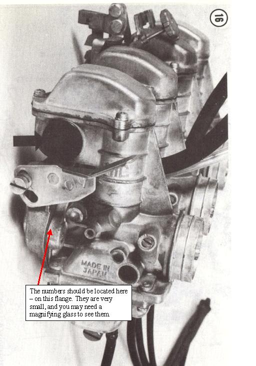

there should be an ID number stamped on the flange below the choke lever or on the same flange on the outside of #4 carb. If you post what is on your carbs we may be able to provide you with more info.
22 Oct 2020 10:39 - 22 Oct 2020 10:41
cycleorings.com has an O-ring kit that should have most if not all that you need. If there are some random O-rings missing Harbor Freight sells kits for cheap.
Ebay has lots of guys selling VM carb gaskets. The pumper VM's take different gaskets than the non pumper type so pay attention to what you are ordering.

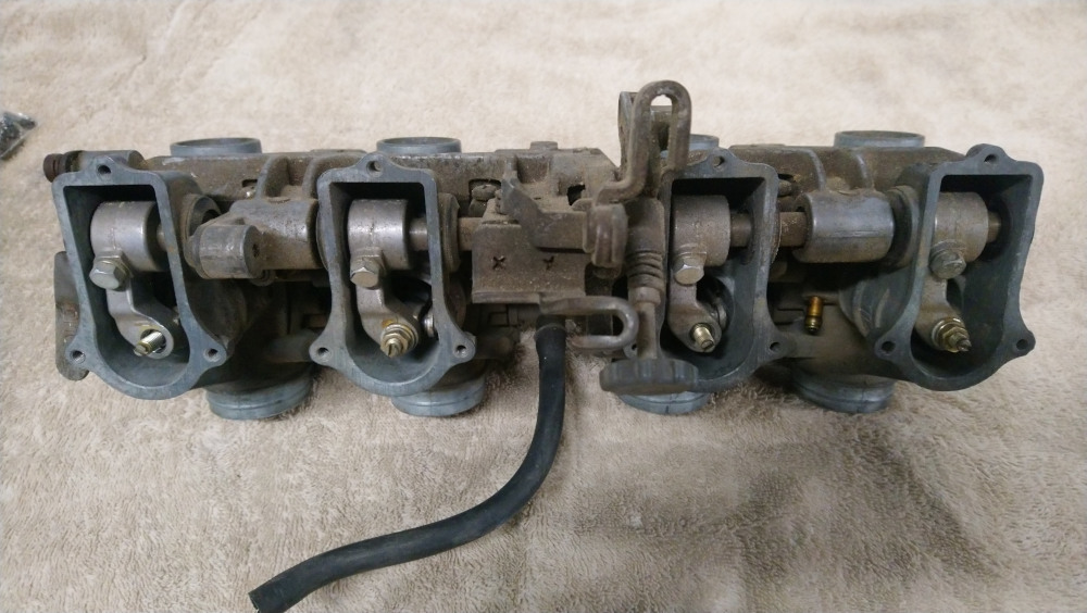

BTW, it looks like the sync screws are missing off the slides in the first photo. Hope you have those parts or you are going to have to hunt some down.

22 Oct 2020 19:58 - 22 Oct 2020 19:59

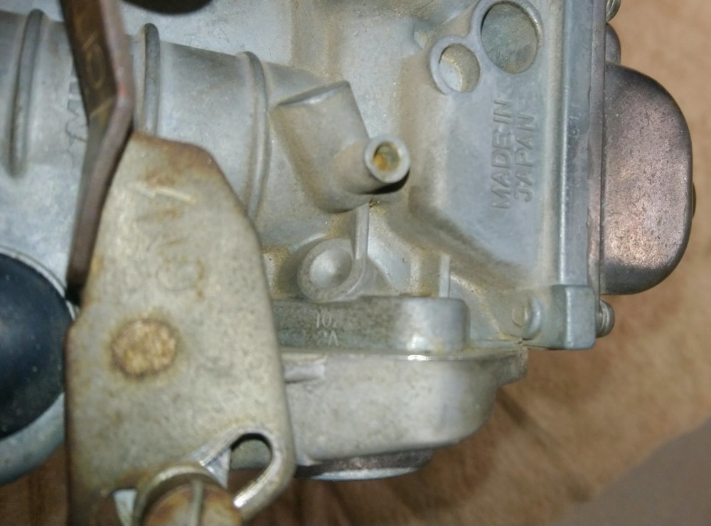

Finally, more pics!
This number looks like:
but it might be
It was really difficult to get my phone camera to focus on that bit...
@Nessim there's those missing bits. If I get the exact same size I should be able to get just about any nuts and washers? Or no? Is there any special material they should be?
102
2A
but it might be
1022
2A
