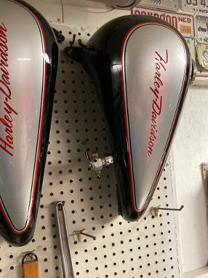

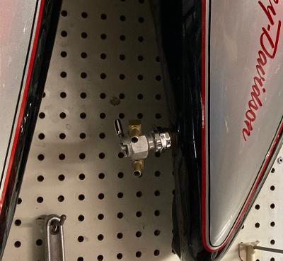

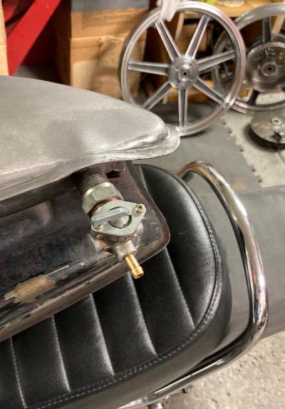

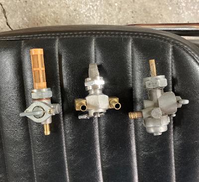

The 22mm petcock bung thread is also the same size Harley Davidson fat bob tanks use! But being single outlet, you could split the single into a 2 way. They HD uses 1/4" hose. But for stock applications. All these years Guy's looking for a cheap replacement? Could have used HD petcocks. I have a nice Pingel valve with a 3/8" NPT adaptor for a 22mm that is used on a 1200cc with 38 lectrons on it.. All 3 of these valves are interchangeable between Kaw And Harley. Thought I'd share that info.
