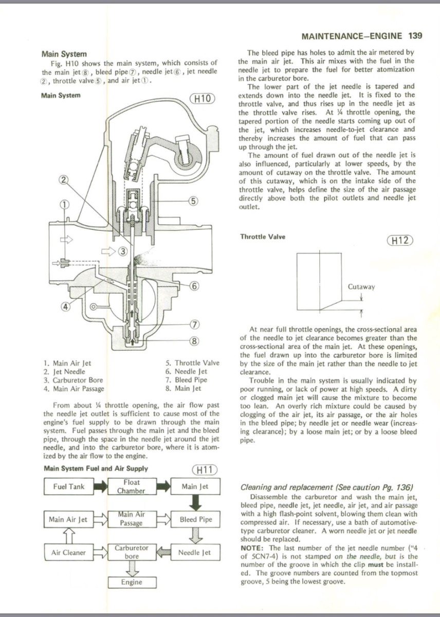

27 Jul 2020 09:47Mikaw wrote: Now. I believe your theory might be correct as long as the main is large enough to NOT restrict the needle and jet flow...
This is from the Kawasaki training manuals for carburetors. It's what caused me to wonder about this.

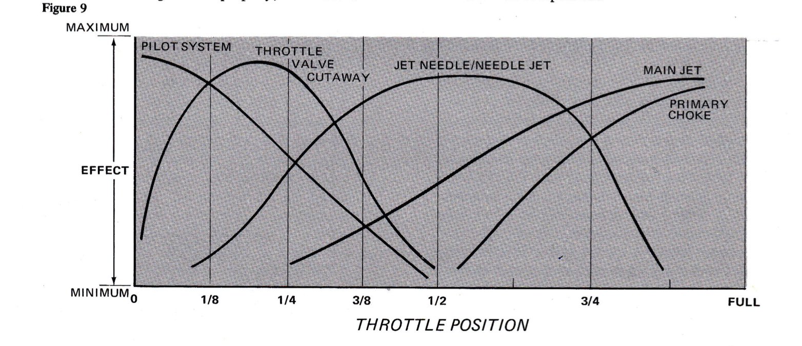

Overall jetting is a stack up of all fuel circuits and not just the main.
The main jet does not just affect 3/4 opening and beyond but overlaps the needle and needle jet well before half throttle so the larger main also richens up the fueling before 3/4 throttle.
Try running the bike with a massive main jet or no main jet and you will find you have an unrideable machine due to over fueling problems much lower down.

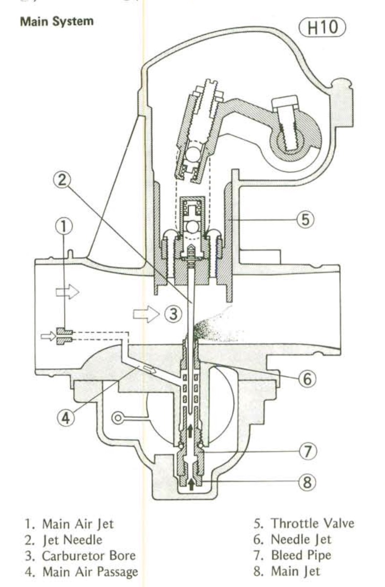

OK...as the slide moves upwards more air flows through the throat, which means the air velocity increases, which means the pressure in the carb throat decreases. This causes a greater pressure differential between the bowl (basically at atmospheric pressure) and the throat, which drives more fuel up the main jet and past the needle. If the main jet is larger this means more fuel passing by the needle at any given throttle setting. Is this correct?

27 Jul 2020 10:12
Yes! An overly large main will flood the needle jet tube with fuel causing rich running at any opening.
Blocking the needle jet tube air bleed will have a similar effect.

Zed1015.... Make sense when you consider the fuel being PUSHED up the bleed tube. I can see now how a “to large” main causing rich conditions... I always thought fuel was sucked by pressure drop causing a vacuum.... thank you for enlightening me...
