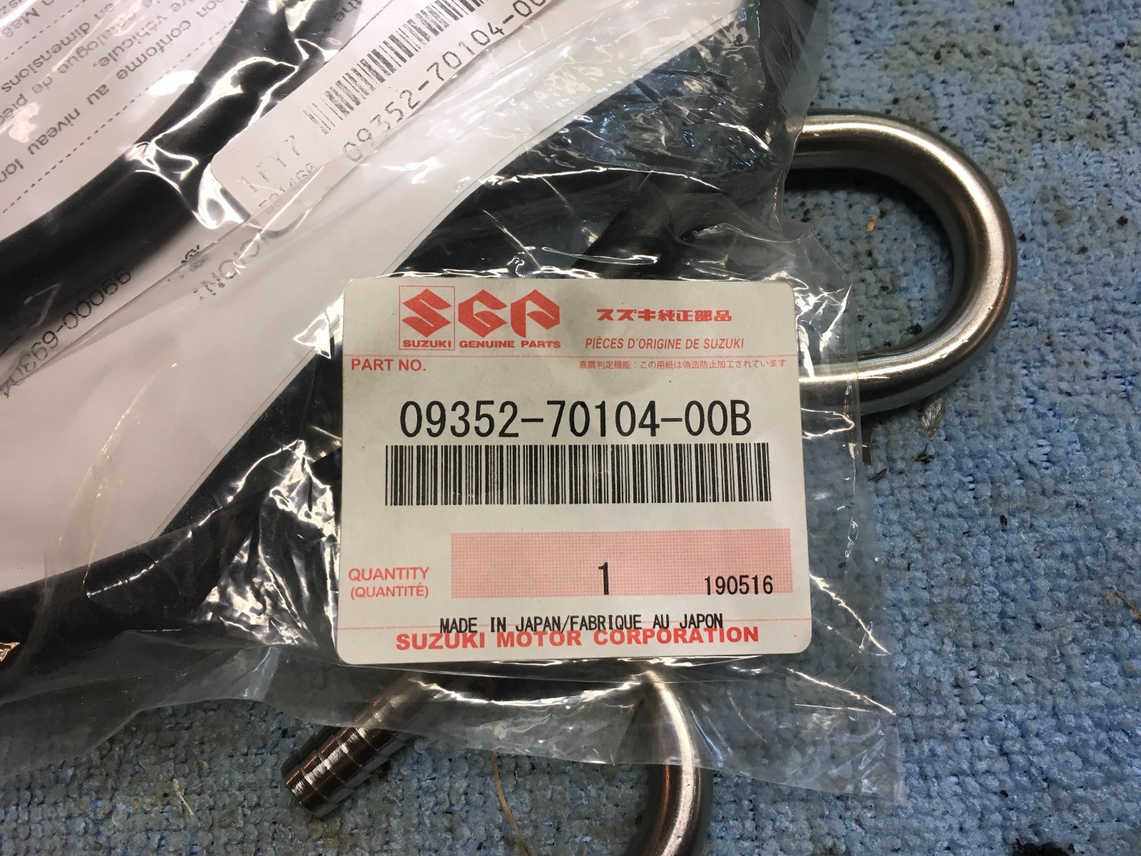

Nessism suggested this Suzuki line...
www.partzilla.com/product/suzuki/09352-70103-00B

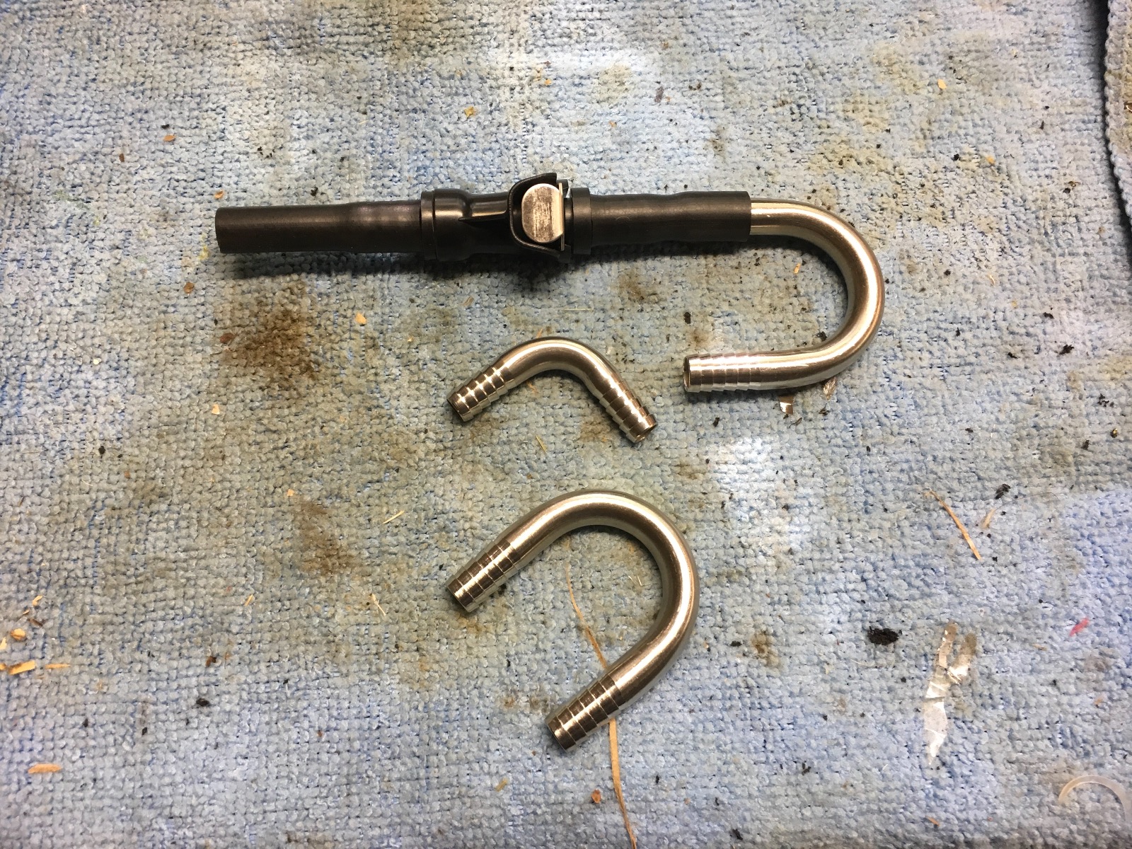

.. I’m using it along with 5/16 stainless fittings and the 10mm clamps from Parts n more with great success... I also installed a dry break quick disconnect. Got tired off fuel all over when I needed to take the tank off... 650ed suggested the SS fittings... great useful knowledge here if you read and listen

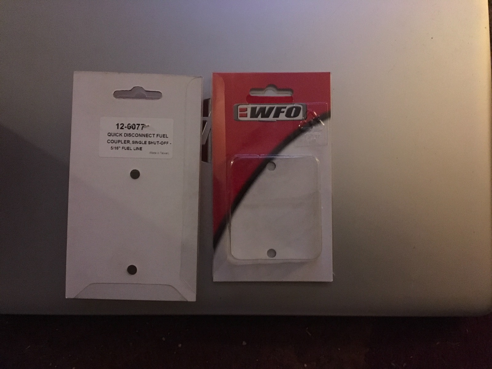

Can’t find the site I purchased from but it’s available here...
www.vintagecb750.com/products/6/fuel-sys...el-line-fuel-filters
Picture of the front and back of package WFO 12-0077
