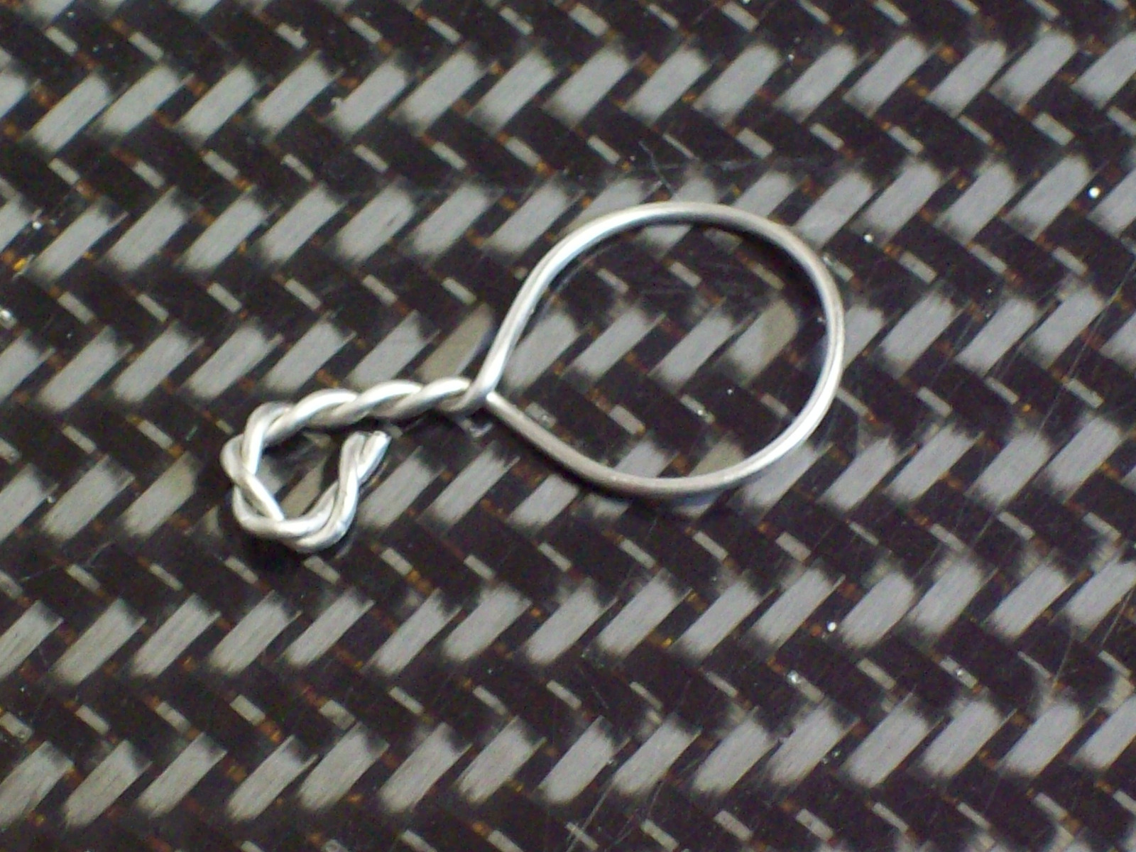

Just twist up a piece of safety wire to the size of your fuel line.
Works great, been doing it since back in the 70's!!!!!
