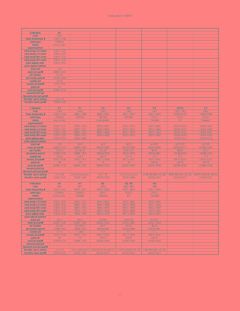

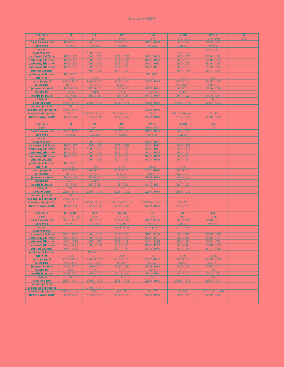

Here are some tables i created in the past, have posted them here before cut can not find them now. The tables have the info I can find and make sense of about the different carbs that came stock on the (K)Z650s
