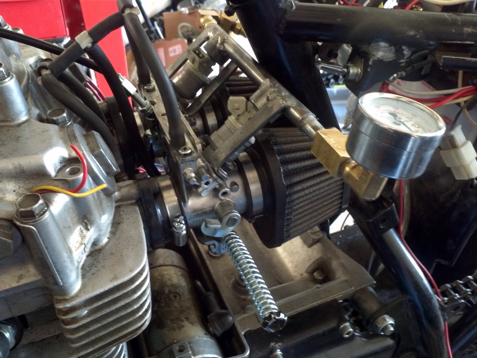

I've never seen a KZ throttle body. Got pics? Ed

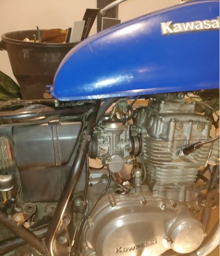

I would, but I've had the carbs off twice today and I don't much feel like taking them of again, lol. Here's a pic of the side of the bike, the black box to the left is the air filter housing.

Ok. I think there's a terminology issue. You use the term "throttle body" but there is no throttle body on the bike. So where are you spraying the starter fluid? Ed

12 Jul 2020 19:13650ed wrote: I've never seen a KZ throttle body. Got pics? Ed
Oh I bet you have.
1980 KZ1000 Classic for starters.
Also the GPz750 turbo and GPz1100 which are sport version of the Z series and have been discussed many times on this board.

12 Jul 2020 19:48 - 12 Jul 2020 19:49I stand corrected. I should have said I've never seen a KZ440 throttle body. EdNebr_Rex wrote:650ed wrote: I've never seen a KZ throttle body. Got pics? Ed

Apologies for the confusion, I've been spraying starter fluid right into the air intake, right behind where the air filter sits

12 Jul 2020 21:37650ed wrote:I stand corrected. I should have said I've never seen a KZ440 throttle body . EdNebr_Rex wrote:650ed wrote: I've never seen a KZ throttle body. Got pics? Ed
Oh I bet you have.
Now you have.
